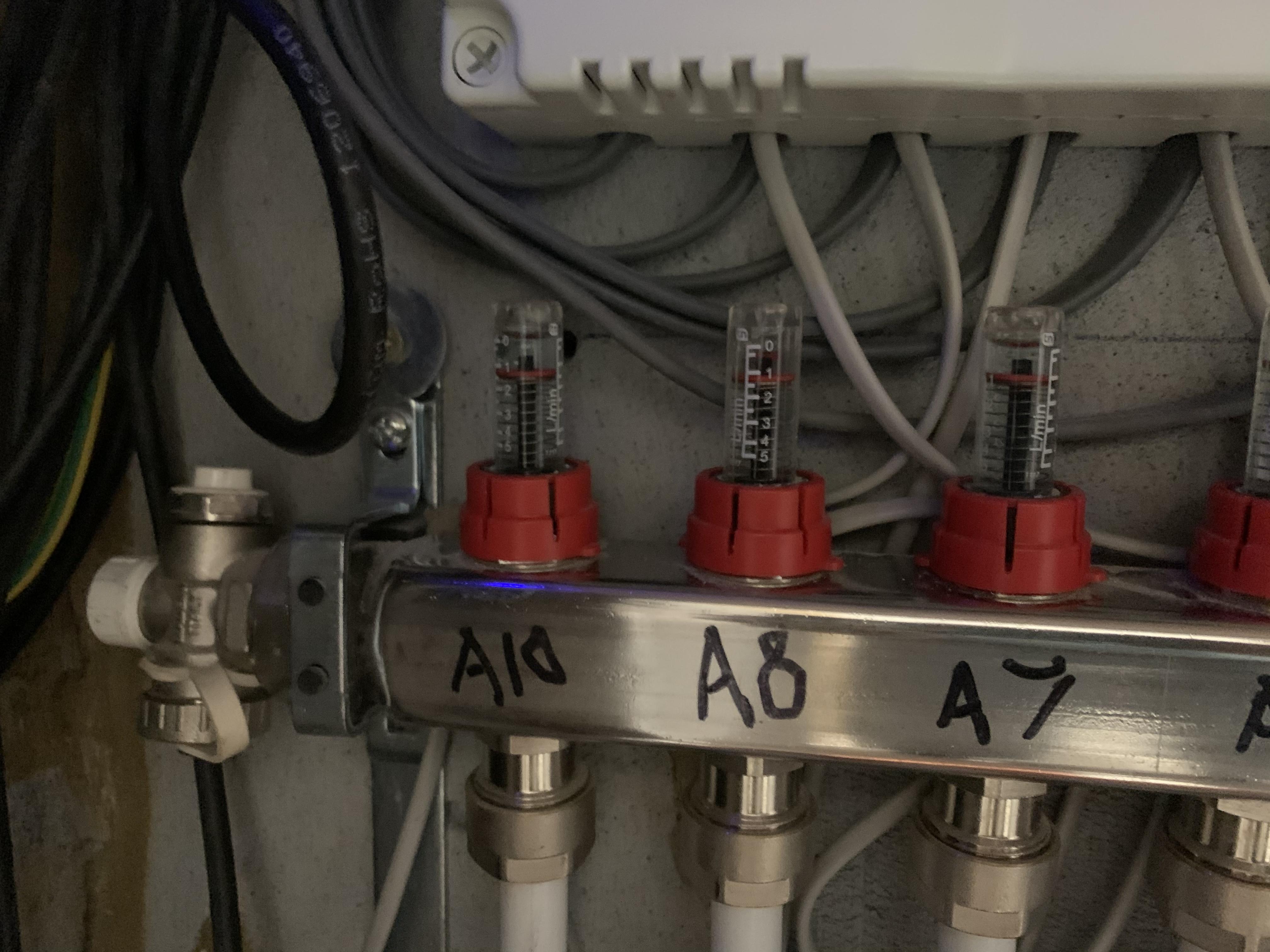

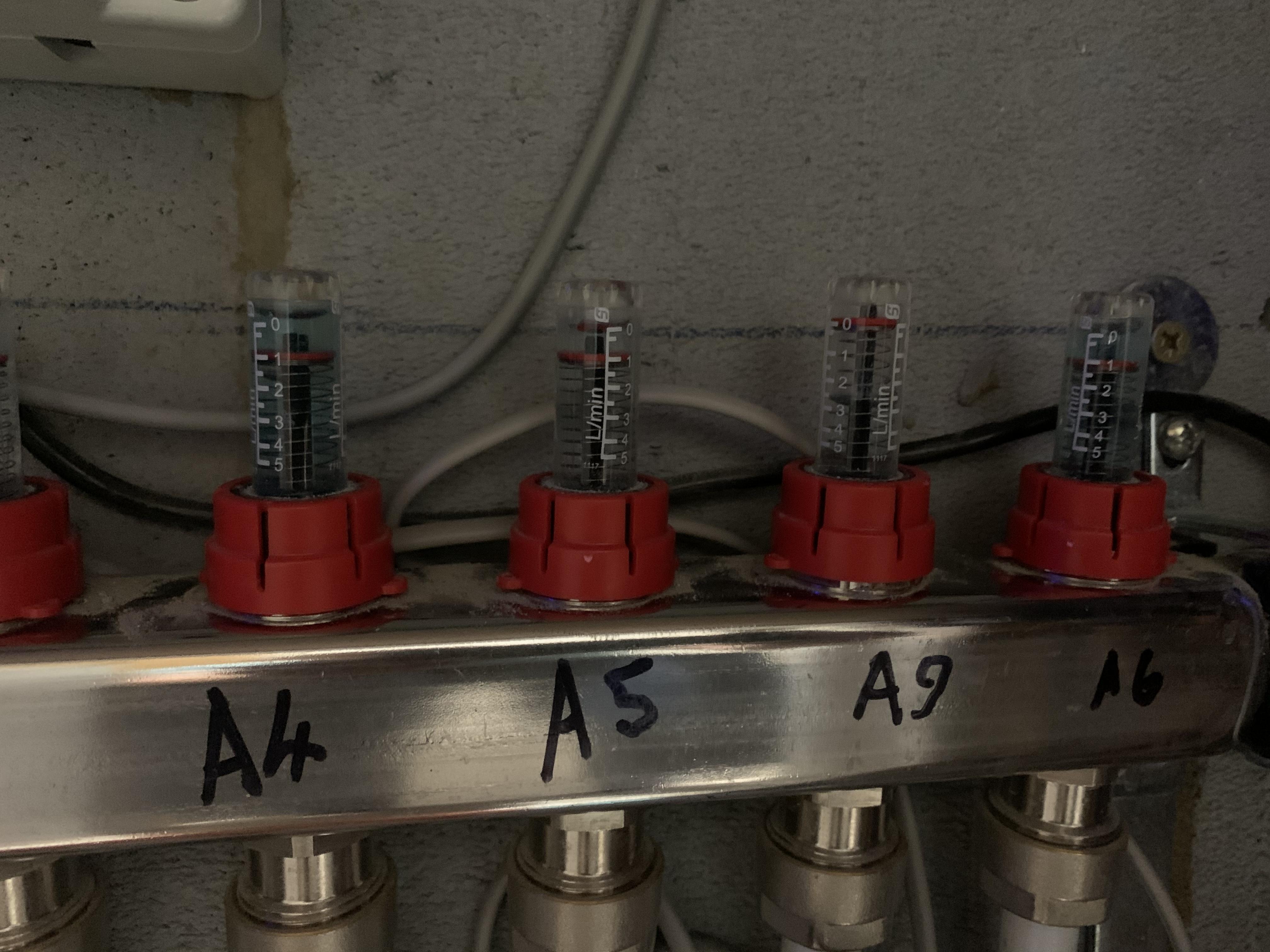

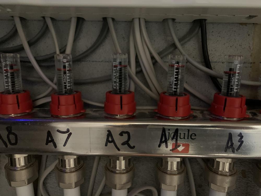

ChristyJH Posted March 7, 2021 Share Posted March 7, 2021 Hi all interesting problem. House/floor felt quite warm today but none of the downstairs stats were calling for heat. Checked upstairs and one stat in far bathroom was call for heat. Checked manifold upstairs and down stairs and noticed flow rates on all of them, hence the warmth. Turned off the one stat calling for heat. All then stopped. Turned one back on and all came on. I did a complete power off to reset but not joy as same again. thoughts welcome thanks Link to comment Share on other sites More sharing options...

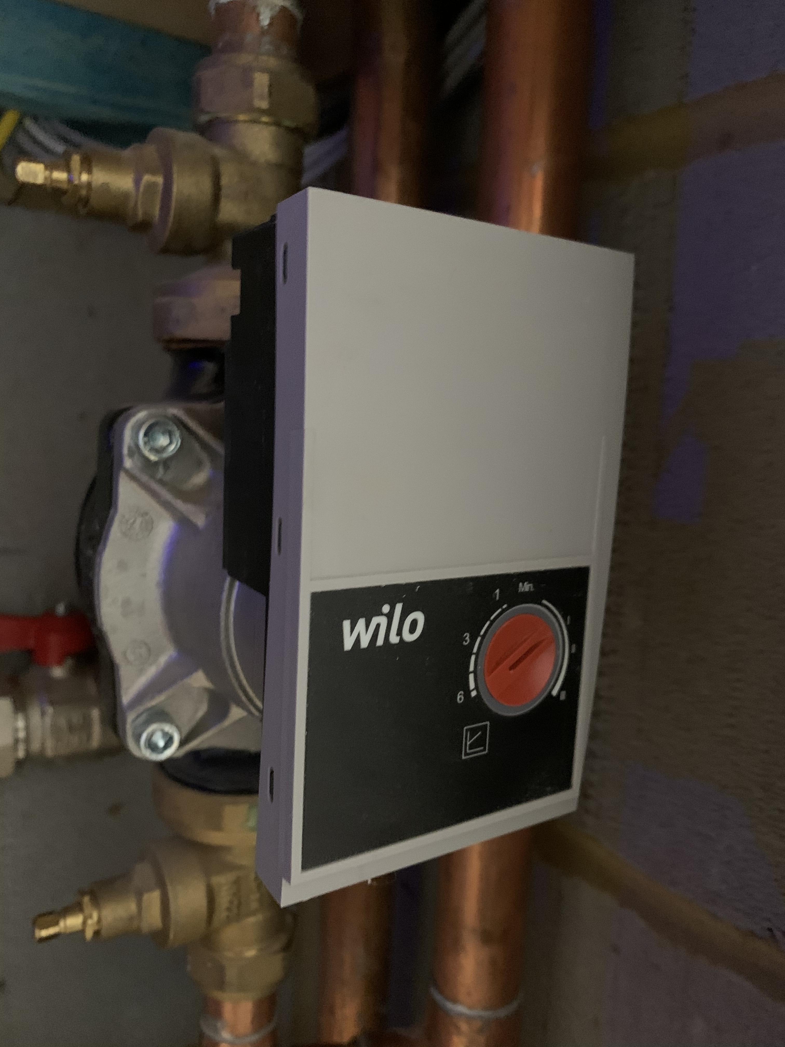

ProDave Posted March 7, 2021 Share Posted March 7, 2021 Post some pictures of you rmanifold and any valves or pumps near it please? Link to comment Share on other sites More sharing options...

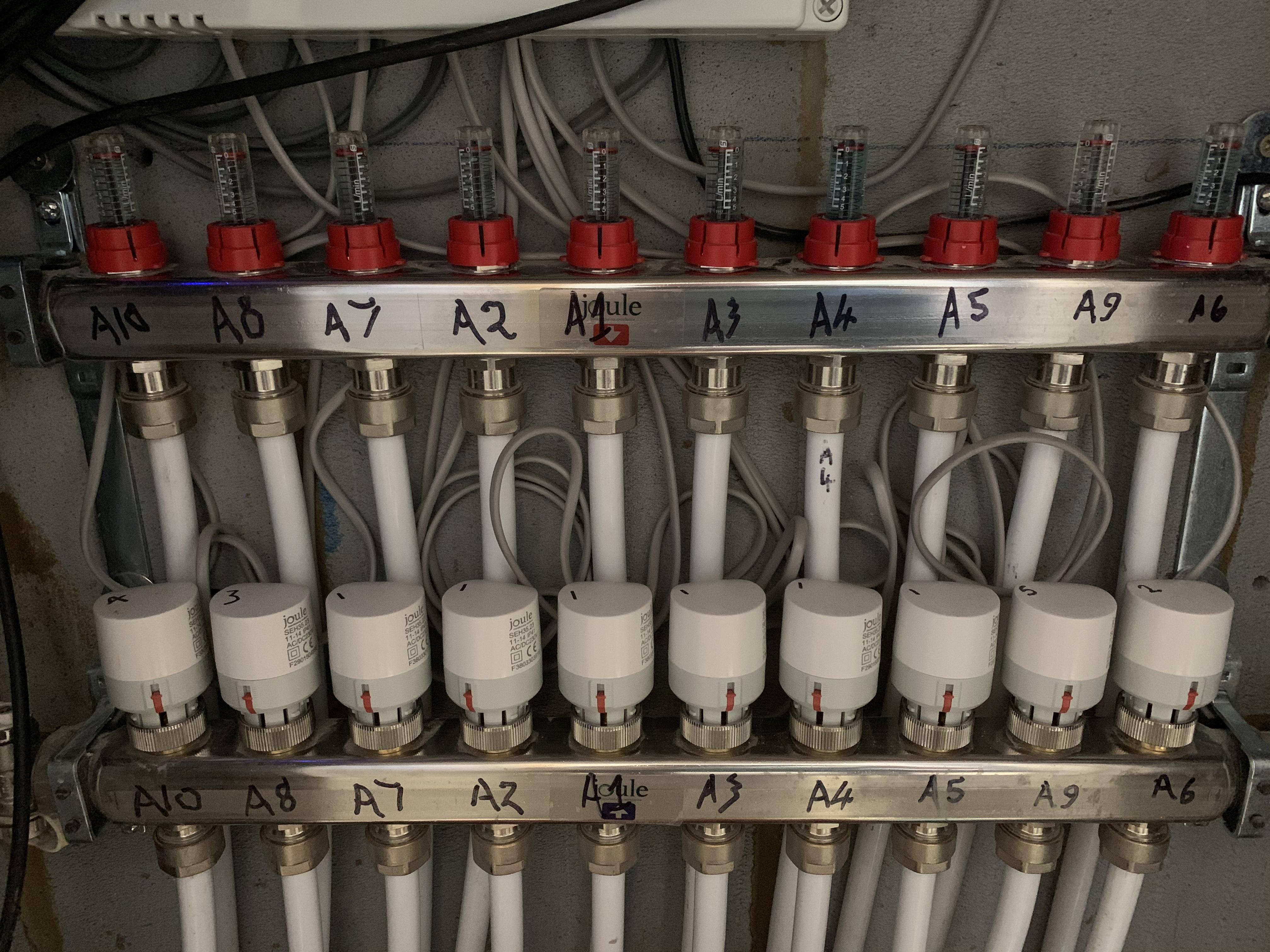

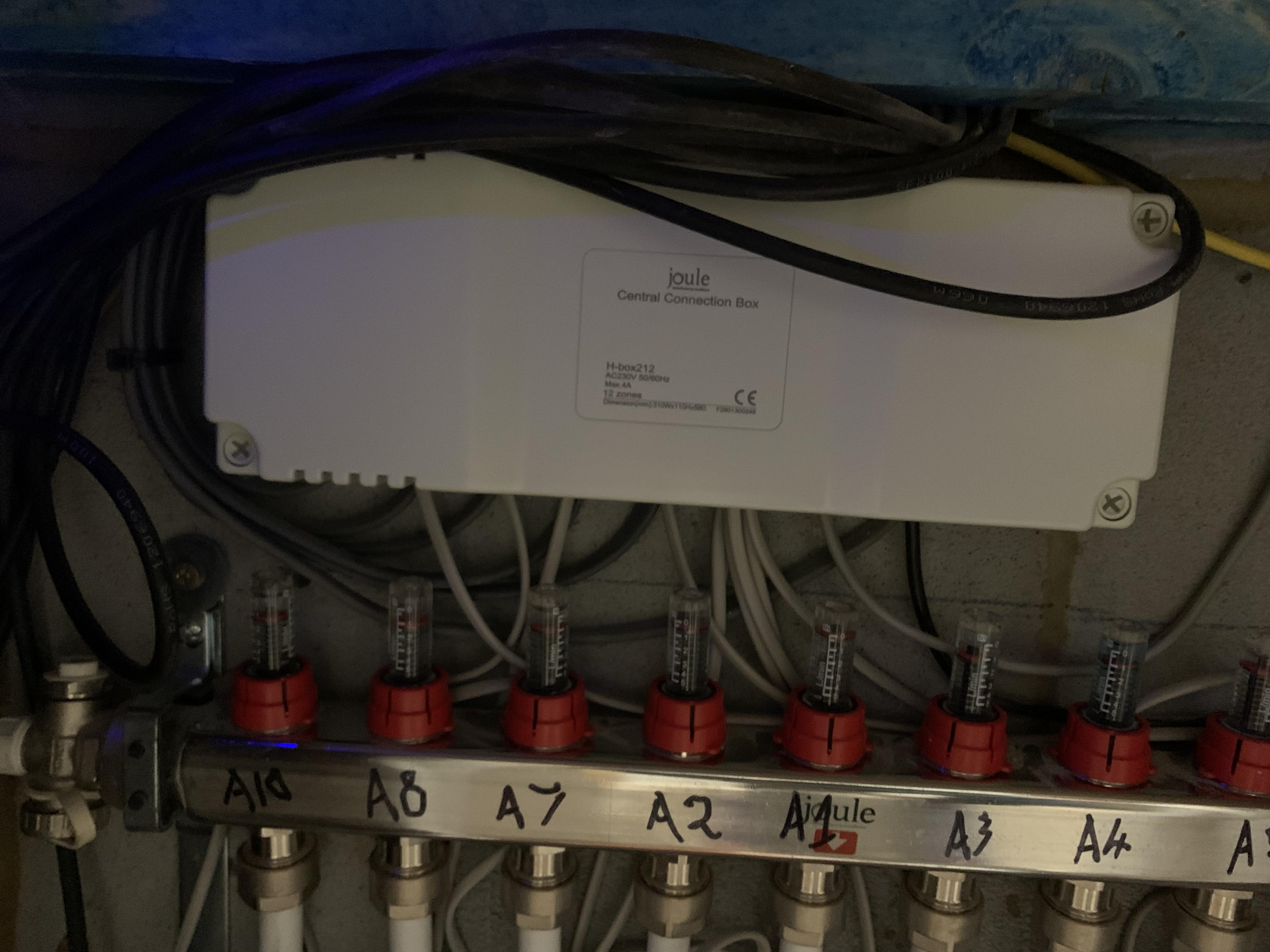

ProDave Posted March 7, 2021 Share Posted March 7, 2021 A picture of the white control box just out of shot above the first picture? Make sure all thermostats are off except for the upstairs one when you take the picture. Picture 1 shows no flow so I assume everything is off. To make any diagnosis the pictures need to be take in "fault" mode, i.e. flow when there should not be. Link to comment Share on other sites More sharing options...
ChristyJH Posted March 7, 2021 Author Share Posted March 7, 2021 I’ve just fired up one stat upstairs so will post pictures in a bit. on previous Q. tony house. Not sure on this one as they did it while I was working tony t. No. All on as before. thanks Link to comment Share on other sites More sharing options...

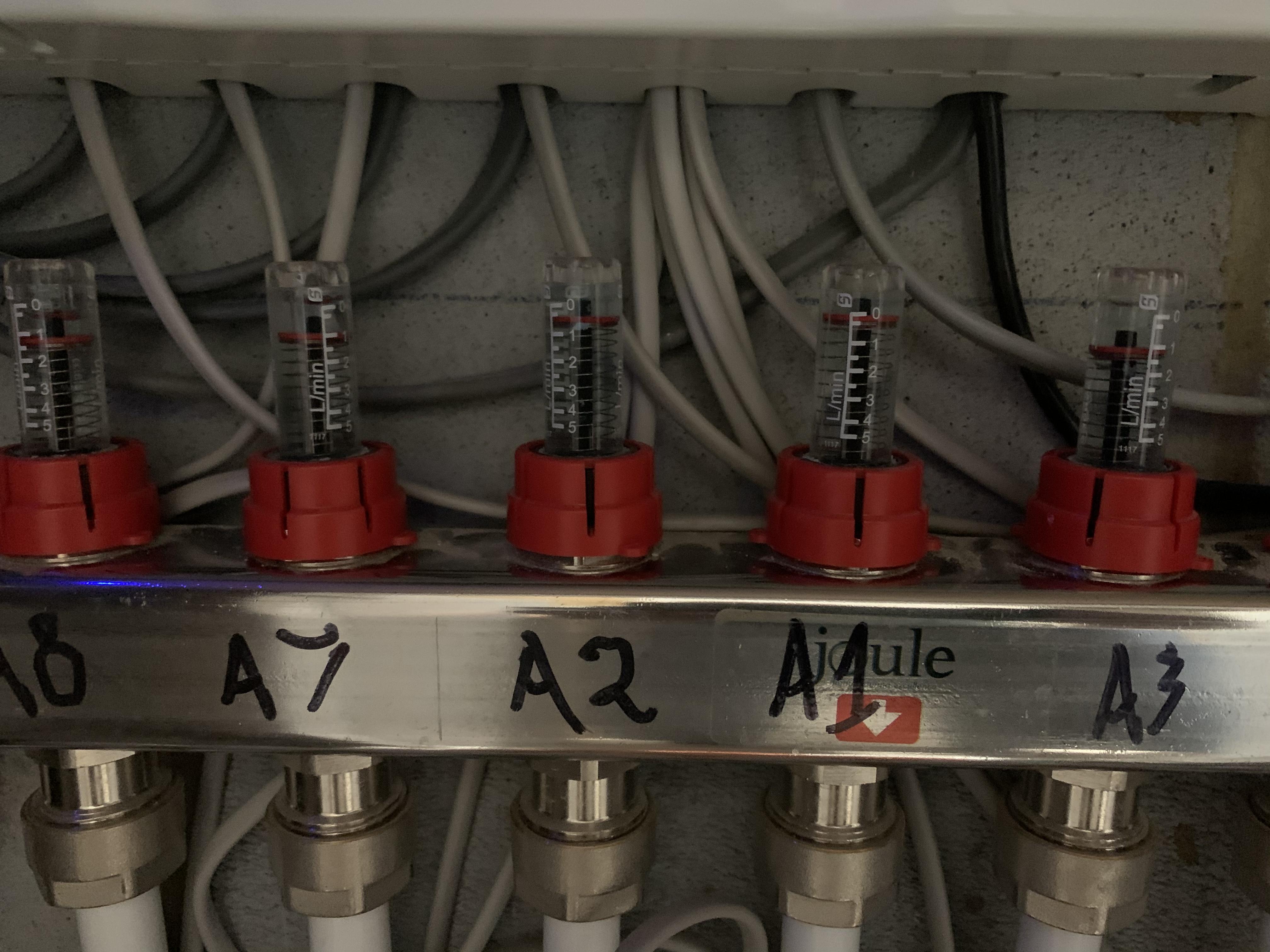

ChristyJH Posted March 7, 2021 Author Share Posted March 7, 2021 Pics attached. All of these are down stairs manifold where no stats are calling for heat. pic of box also. Note black cables are coaxial for TV. thanks Link to comment Share on other sites More sharing options...

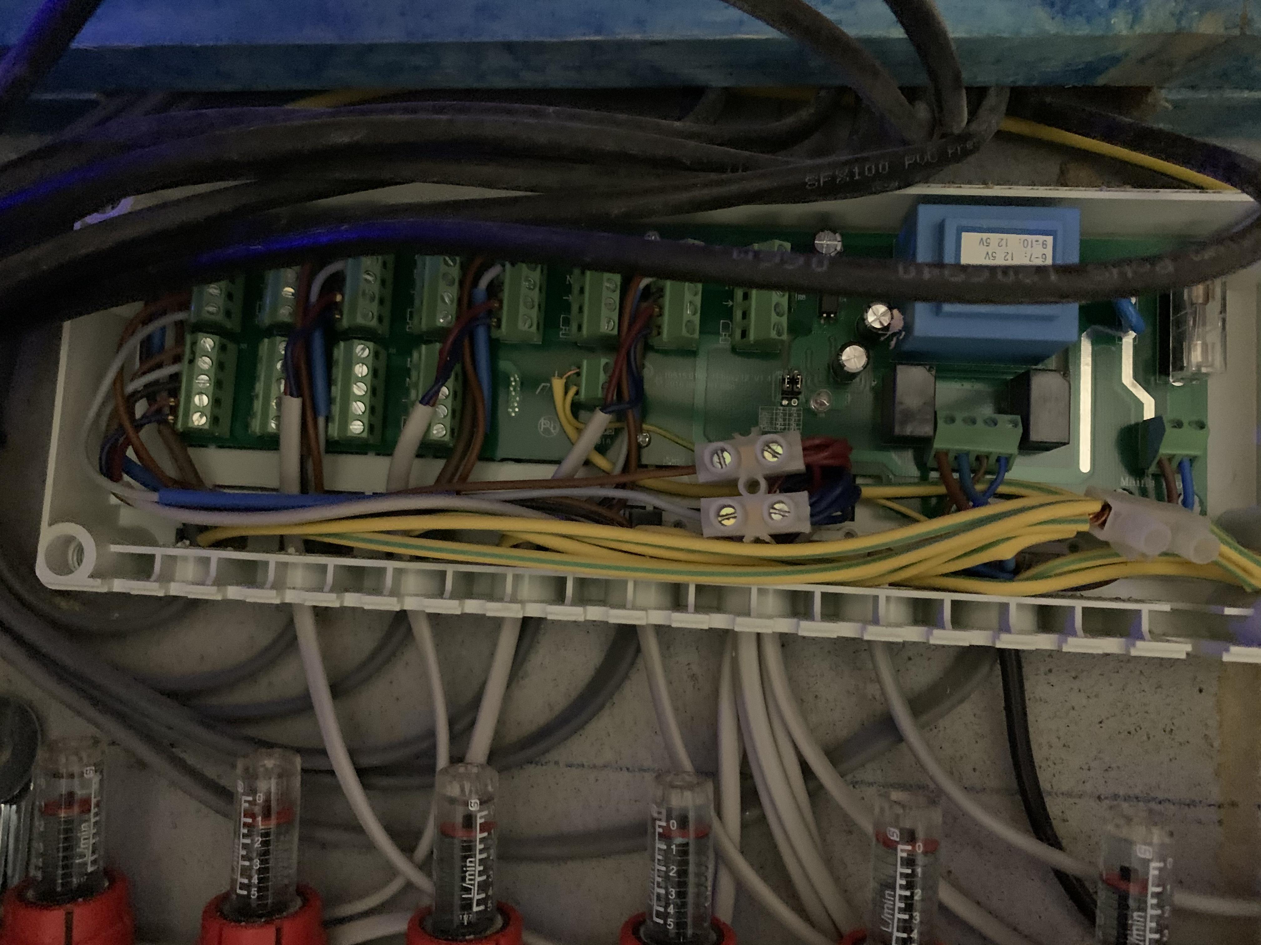

ProDave Posted March 7, 2021 Share Posted March 7, 2021 I was hoping the control box would have some lights to show which zones are turned on, but no such luck. I take it there is a separate manifold for upstairs? Do you fancy taking the lid off that control box and take a picture inside? Don't touch any wires. Are there any lights on on that Wilo pump downstairs? The flow rates showing are quite low, do they increase when you turn up the downstairs thermostats? (will take a couple of minutes from turning up the thermostat to see any change) Link to comment Share on other sites More sharing options...
ChristyJH Posted March 7, 2021 Author Share Posted March 7, 2021 Photo of lid off. There are no single lights for each circuit but when you turn a downstairs stat on one light flashes for a bit then goes on fully and pump starts. There are no lights on when only one stat upstairs calling for heat and downstairs still showing flow. when I turn a downstairs stat on the flow on that circuit does increase a bit ( per your previous point about flow rate being low). could the the flow rates under the actuators need tightening with an 8mm if showing flow when not being called for? the house sat empty for about a year after being built (hence why we think there might have been some deposits creating the need for a power flush per their recommendation). Perhaps they need to come and rebalance? Link to comment Share on other sites More sharing options...

ProDave Posted March 7, 2021 Share Posted March 7, 2021 Still no lights. Okay check this. Check that all the actuators on the bottom rail are screwed fully down. They might have been removed during the work and not put back properly. To do this, turn all zones on and wait a few minutes for them to warm up (they are hot wax devices) and then make sure the big metal ring at the bottom of each actuator is screwed fully down. Link to comment Share on other sites More sharing options...
ChristyJH Posted March 7, 2021 Author Share Posted March 7, 2021 Do you know what, that could be it as most felt loose. I presume the power flush did that. I’ve just shut them all off and will turn one on in a bit to test. Thanks Link to comment Share on other sites More sharing options...
ProDave Posted March 7, 2021 Share Posted March 7, 2021 Could be. If a little loose then they would not close properly and the system pump could be pushing a bit of water through. Link to comment Share on other sites More sharing options...
ChristyJH Posted March 7, 2021 Author Share Posted March 7, 2021 I think that may have done it. Upstairs stat has been on for 10 mins and it’s the only one with flow rates. Great work. Thanks ProDave. Link to comment Share on other sites More sharing options...
