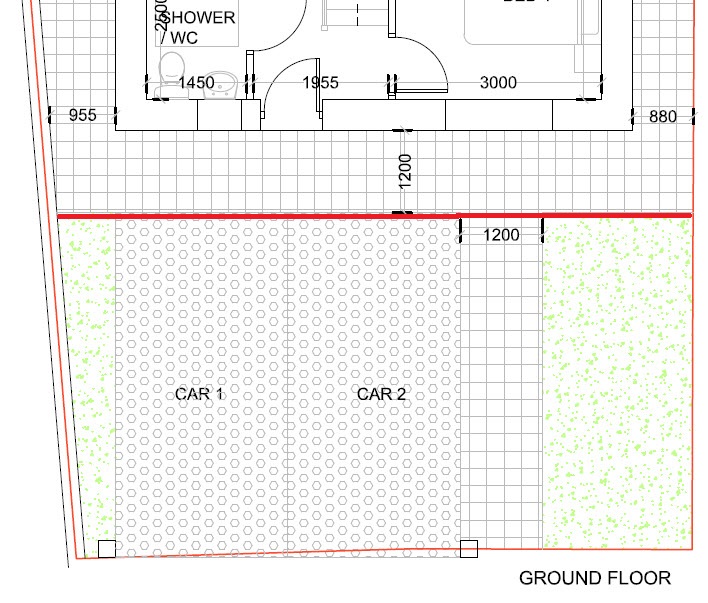

mike2016 Posted February 13, 2017 Posted February 13, 2017 Hi, I've looking at the design of a driveway in a new build. The size is 6 meters deep from the street to the front of the house and 8-9 meters wide. There is a slight slope down from the street level to the front of the house. I'm planning on diverting the house gutter downpipes to an underground rainwater tank at the rear of the house. There are just two things I need advice on if someone can help me: How to ensure run off from washing a car, or any fuel/oil leak doesn't go down the downpipe drain mentioned earlier? Use of permeable paving - is the driveway too close to the house so using this would create a risk to the foundations? I'm guessing I need a separate channel (possibly where I've marked in RED) to capture any run off from the driveway and divert that directly into the storm drain, otherwise I'm risking mixing fuel/oil/detergents getting into the rainwater storage tanks. I'm keen on permeable paving but from what I've read they don't recommend it close to a house. I'm doubtful if 1.2 meters is sufficient (The wheelchair access area around the two spaces below). I'd need to understand where the water goes once it soaks through the permeable driveway aggregate so it's channeled to the storm drain correctly. I can always do a concrete driveway and build a channel into it to capture runoff but wonder about other options.....? Thanks!

Jeremy Harris Posted February 13, 2017 Posted February 13, 2017 We laid permeable pavers, on to the right sub-base (type 3, not type 1) and under the sub-base we fitted Aquacell crates wrapped in terram to form the surge capacity/soakaway underneath the drive. As these were well below the house foundation level we also ran all the rain water drainage to them. It seems to work well, although the sharp grit used with permeable pavers seems to need topping up, by brushing more into the gaps, every year or so, probably because the gaps are wider with permeable pavers.

Jeremy Harris Posted February 13, 2017 Posted February 13, 2017 (edited) We put the crates in to comply with the SuDS regs, see here for more info: http://www.susdrain.org/ They are only under the drive, the rainwater from the house gutters etc is pipe down to them. We also had to make sure none of the run off from rainwater entered the stream on the other side of the lane, which is a joke given the way the lane itself turns into a stream in heavy rain! Edited February 13, 2017 by JSHarris

Oz07 Posted February 18, 2017 Posted February 18, 2017 I think the point of permeable paving is that unless it's heavy rain the paving shouldn't be directing the run off anywhere. Therefore the rain should fall where it has always fallen and shouldn't pose any extra risk to your foundations. Obviously it makes sense to put a channel in for surge capacity though.
