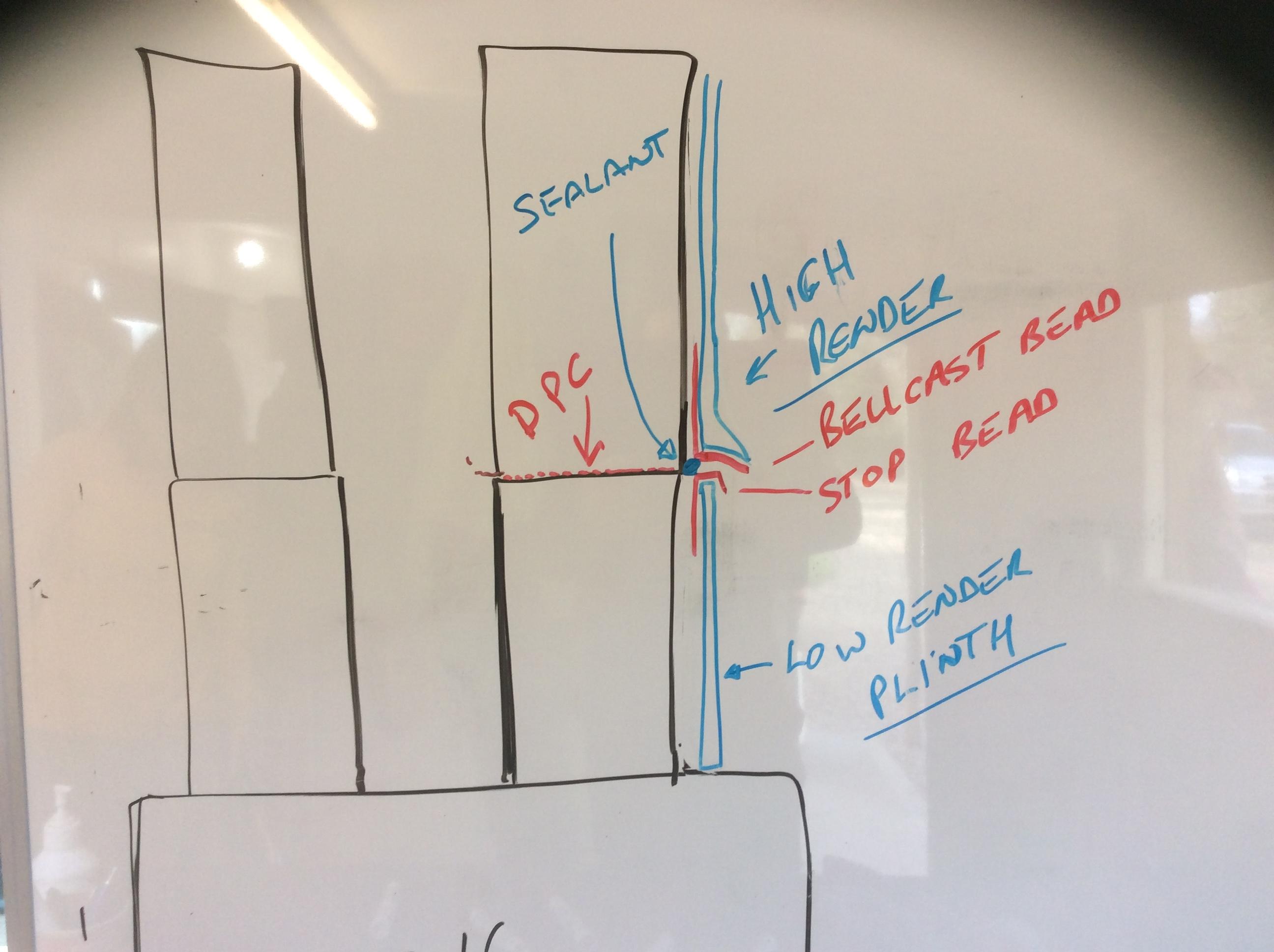

I am trying to out the best way to go with this. The house is going to be rendered painted white, with grey windows.
I am not sure what to do below DPC, either rendered as per @Russell griffiths detail
or have a few courses of black brick and mortar (below left)
The issue that i have is to all the thresholds on ground floor are level, and not sure what happens where the DPC is for level thresholds.

Posted
You can render below DPC but you need to check with the manufacturer as not many are approved for that.  My choice would be the black brick and mortar as maintenance free.

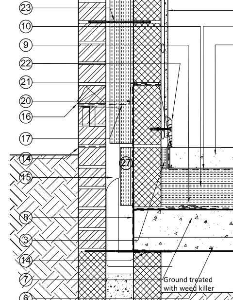

Posted
i think that i have found the type of detail i was looking for, below. In this case it looks like its proposed a double DPC (14 and 17), not sure the reason why but i am sure there is a good one!

Posted
15 minutes ago, Moonshine said:
what i want to see is what happens when you have the ground level the same as the FFL.
You can't do that.  It is OK where there is a door or a window but with the second detail you have shown it may well need tanking.

Posted
I've been looking for answers regarding the  same solution here
Drawing you showed is conveniently missing wall tie at ground level DPC (14) which itself is against the rules, but even if placed there, it may invalidte BA certification of wall ties, DPM or both.
