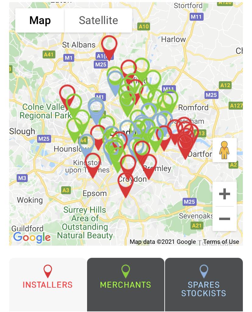

Adsibob Posted April 28, 2021 Share Posted April 28, 2021 Thanks, that's helpful @PeterW. The website I was finding was this one: https://protecboilers.com/. I note the Alpha E Tec S only gives you a 10 year warranty if you install their "Alpha Premier Pack Extra". Didn't know what that was, but digging around their website I found this: The Alpha Premier Pack Extra is only suitable for use with Alpha boilers originally supplied with threaded type isolation valves. It must be installed in accordance with these instructions and the installation instructions supplied with the boiler. The kit comprises of a wall jig fitted with a magnetic cyclone and pipe clips, wall template, flow and return split tails, bottom tray, screw pack and wall spacers. The wall jig has been designed to be fitted to the wall before the boiler, allowing the pipework to be pre-fitted. The pipework can be installed vertically upwards and downwards using the flow and return connections supplied on the jig. Apart from the magnetic cyclone - which I presume is something equivalent to a magnaclean - how does this prolong the life of the boiler? Also, anyone know why the specs don't reveal the flow rates its capable of? Isn't that important in terms of knowing how quickly it can fill the hot water tank and supply the rads? Link to comment Share on other sites More sharing options...
