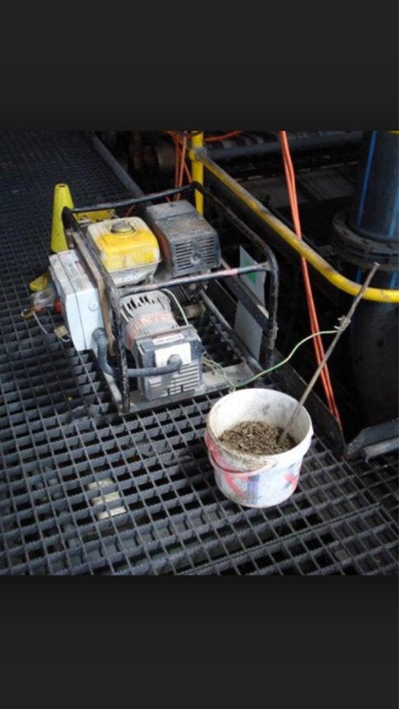

SteamyTea Posted March 3, 2021 Share Posted March 3, 2021 Caravans are earthed differently to houses. Could that be an issue? Link to comment Share on other sites More sharing options...
Onoff Posted March 3, 2021 Share Posted March 3, 2021 (edited) 37 minutes ago, SteamyTea said: Caravans are earthed differently to houses. Could that be an issue? Just use a portable earth: I AM ONLY JOKING! Edited March 3, 2021 by Onoff 1 Link to comment Share on other sites More sharing options...
SteamyTea Posted March 3, 2021 Share Posted March 3, 2021 (edited) 4 minutes ago, Onoff said: I think that is how they are meant to be earthed, i.e. not earthed. https://electrical.theiet.org/wiring-matters/years/2016/61-summer-2016/electrical-installations-in-caravancamping-parks-caravans-and-motor-caravans/ Edited March 3, 2021 by SteamyTea Link to comment Share on other sites More sharing options...
