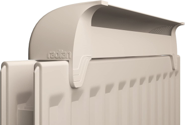

Temp Posted March 1, 2021 Posted March 1, 2021 It would be interesting to see what other members think of adding something like these fans to radiators to improve their ability to emit heat at lower flow temperatures. Obviously it might be better to fit larger or double rads but if that's already been done what about these? Would the electricity they consume out weigh the improvement? They claim a running cost of £2 a year. https://www.amazon.co.uk/Radfan-Classic-Small-Power-Radiator/dp/B00GR0STTG

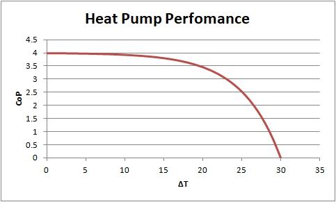

SteamyTea Posted March 1, 2021 Posted March 1, 2021 (edited) At the most basic level, any heatpump will loose efficiency as the temperature difference increases. It is also not linear. The idea is that the system has to be designed to work in the most effective temperature range. This is achieved with a combination of system size and refrigerant gasses used. (the CoP is the extra energy from the air or water, not the total energy) Edited March 1, 2021 by SteamyTea

ProDave Posted March 1, 2021 Posted March 1, 2021 On 01/03/2021 at 16:23, SteamyTea said: At the most basic level, any heatpump will loose efficiency as the temperature difference increases. It is also not linear. The idea is that the system has to be designed to work in the most effective temperature range. This is achieved with a combination of system size and refrigerant gasses used. (the CoP is the extra energy from the air or water, not the total energy) Expand That graph looks wrong. It says when I am heating my DHW at 50 degrees even when it is a balmy 10 degrees outside, so delta T 40 degrees, it is running at a COP of 0.
SteamyTea Posted March 1, 2021 Posted March 1, 2021 On 01/03/2021 at 16:39, ProDave said: That graph looks wrong Expand Look at it again. As the ∆T increases, the CoP reduces. It has nothing to say about absolute numbers (in fact it is just made up numbers, I could change the chart to fit what you want though). The important thing is that it is sizing and system design that is important, not the underlying technology. A thermal boiler is just a heat engine, just that very little excess energy comes from the air that is drawn in to aid combustion. Though with a condensing boiler, energy, via phase change, is sometimes recovered.
SteamyTea Posted March 1, 2021 Posted March 1, 2021 On 01/03/2021 at 18:16, dpmiller said: so your chart is fake then. Expand No. It is illustrative. There will be a system that fits that curve, that is the beauty of physics. The concepts are simple.
