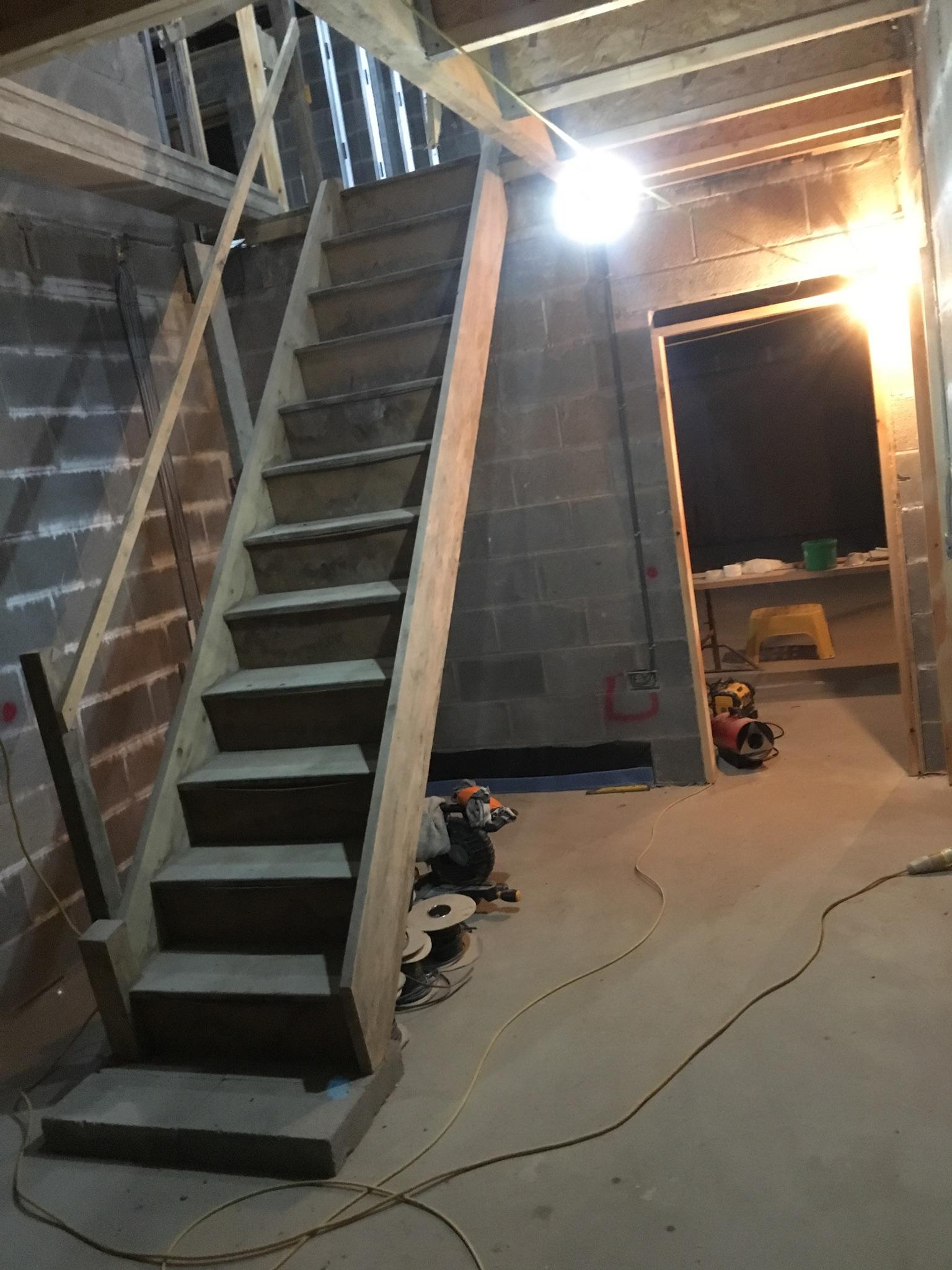

recoveringbuilder Posted February 16, 2021 Posted February 16, 2021 Buy yourself a cheap staircase from howdens or jewson (£120) it will be money well spent and don’t fit your oak one until everything is done, trades won’t look after it like you would and it’s bound to get damaged. 1
nod Posted February 16, 2021 Posted February 16, 2021 26 minutes ago, recoveringbuilder said: Buy yourself a cheap staircase from howdens or jewson (£120) it will be money well spent and don’t fit your oak one until everything is done, trades won’t look after it like you would and it’s bound to get damaged. That’s exactly what we did 1

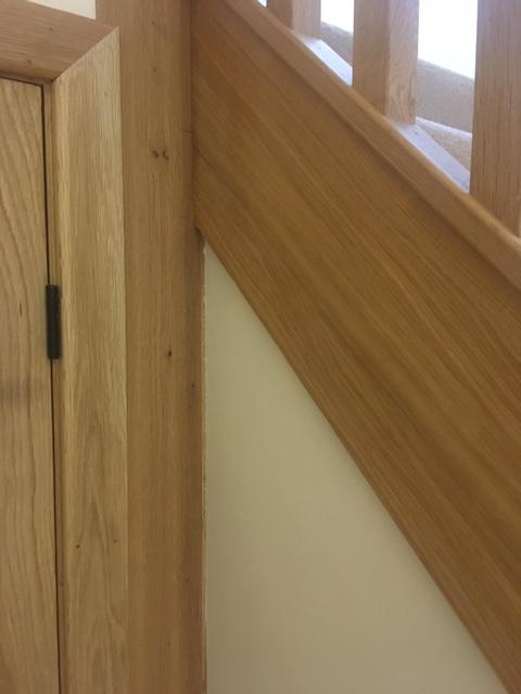

revelation Posted February 16, 2021 Author Posted February 16, 2021 My builder said I’m better off skimming up to the oak string. So it’s got a nice finish, so you’d advise getting it skimmed up first. Then installing the staircase, so how would it be finished along the edge? Caulking? Will that crack over time with movement?

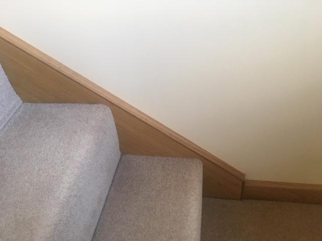

Redoctober Posted February 16, 2021 Posted February 16, 2021 (edited) 2 hours ago, revelation said: My builder said I’m better off skimming up to the oak string. So it’s got a nice finish, so you’d advise getting it skimmed up first. Then installing the staircase, so how would it be finished along the edge? Caulking? Will that crack over time with movement? Hi @revelation our oak staircase was fitted after the skimming / plastering had been done like others above. Some images to show that the finished product was just as good as if done the other way round. Ours has been in place for over 2 year snow and there are no signs of cracking etc. The second image shows the section under the stairs leading to the understairs cupboard. Hope this helps. Edited February 16, 2021 by Redoctober tidy up

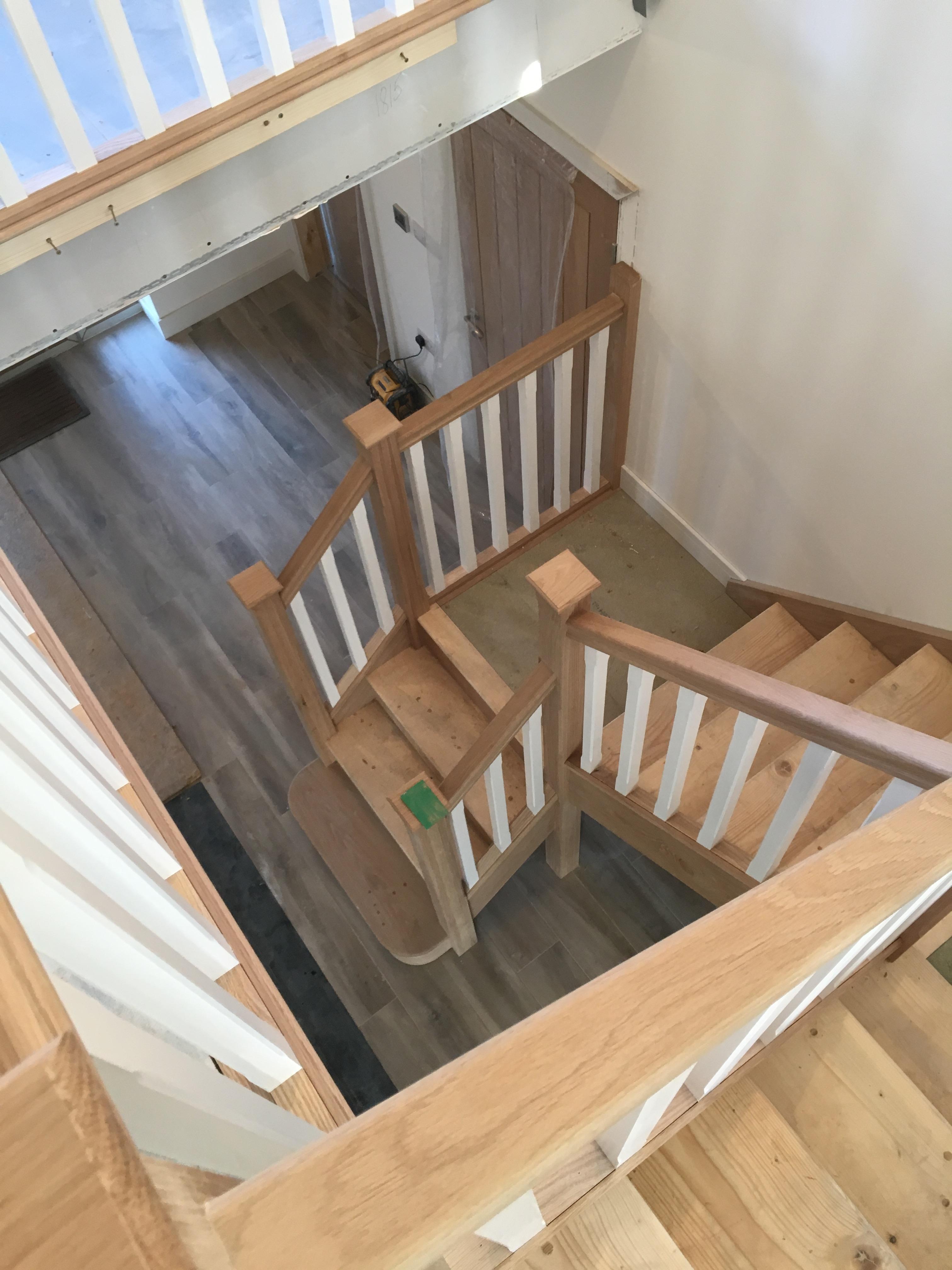

revelation Posted February 17, 2021 Author Posted February 17, 2021 Thanks for all the advice all, we will get the plaster/skimming all done before hand. We will try to delay things for as long as possible to get the stairs in. Once we do we will clean and seal with Osmo asap and then will get them wrapped and covered as best as possible. I will be painting and fitting skirts myself, but the second fix for electrics and plumbing still need to be done. We have had a loft conversion so have 2 staircases to contend with.
