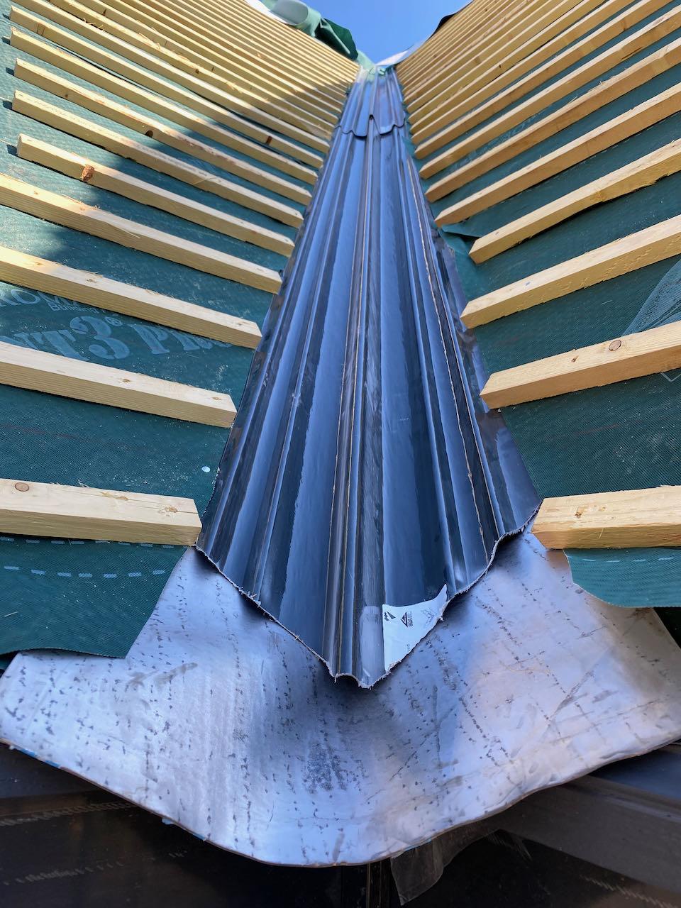

Andrew Posted February 16, 2021 Posted February 16, 2021 I have lots of valleys in my complicated roof and valley boards and noggins were always a requirement for everyone involved in the build. They weren't part of the scope of the timber frame contract but I paid the frame erectors directly for a couple of extra days to put them in. They also needed to put in noggins between the rafters so the roofer would have somewhere to fix the ends of the battens as they run into the valley. This is a photo from last year just before the roofer started. They used a ridged GRP valley trays, but still needed the valley boards. This is one of the valleys mid-way through felting and battening. I too can't really see how the trusses would provide any additional support for the valley or how you can go without valley noggins as otherwise the roofer won't have anywhere to secure the end of the battens (perhaps they just don't get fixed at the end?). Do you have a photo of the roof as it is without the valley boards? 1

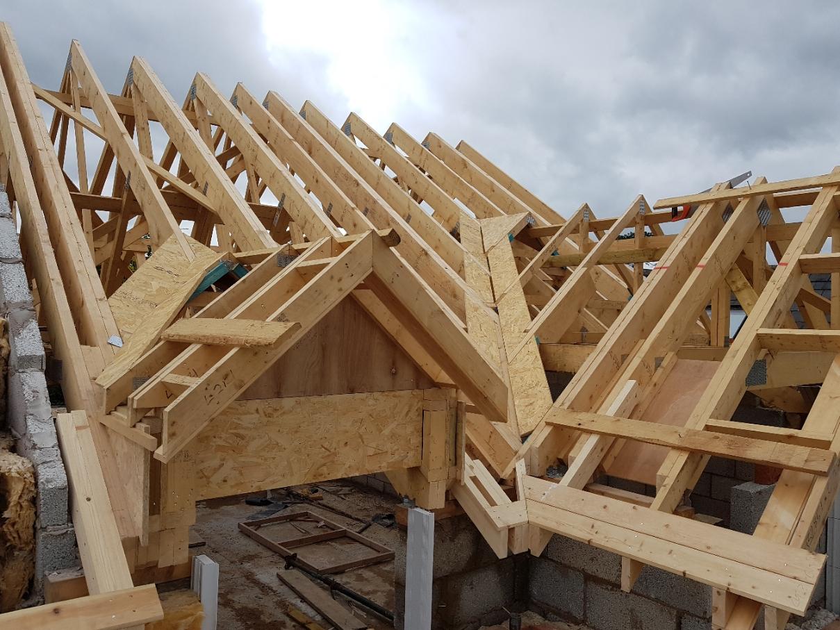

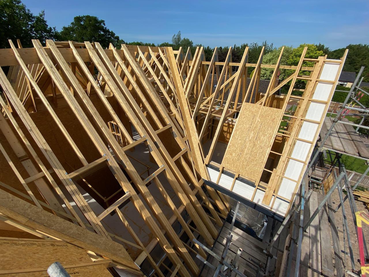

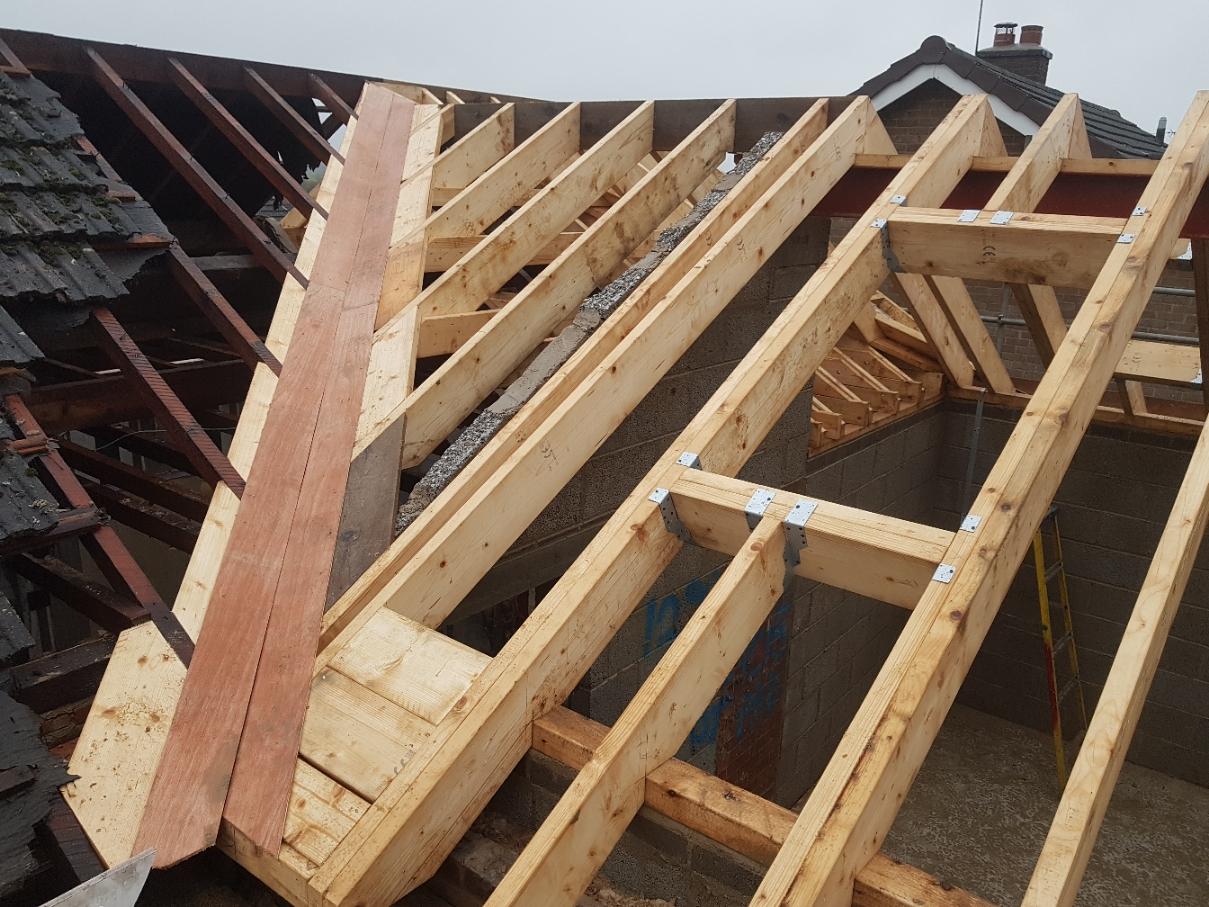

Oz07 Posted February 20, 2021 Posted February 20, 2021 (edited) Always put them in. Worst job in the game. Boring. Ignore dormer had to alter size after it was built to the drawing. Edited February 20, 2021 by Oz07 1
epsilonGreedy Posted February 20, 2021 Posted February 20, 2021 @Oz07your second photo above shows a combination of infill valley board pieces plus a continuous run over the rafters. Is that common? Fitted to bring the valley base up to the ideal height for the tiling?
Oz07 Posted February 20, 2021 Posted February 20, 2021 I used scrap 8x2 off the cut rafters for the infill. Because the valley was built off a lay Board I set the infill 2 or 3 " out from the centre of the valley. I didn't like the gaping hole in the middle so got a thin sheet of ply and ripped it down to smooth this out. GRP valley sits on ply, lath nails into 8x2 Some use thin ply for the GRP with 2x2 noggins out outside for lath fixings
Oz07 Posted February 20, 2021 Posted February 20, 2021 also bonus points for anyone who can see the last common rafters running out on that picture. The extension is built half a brick longer on one wall than the other. I set out off the front wall. Did realise when marking wall plate but kept with set out off front wall incase it effected bond of tiles when setting out from gable. Complete idiots they are. Cant wait till they fit the garage door and the customer realises... 2
