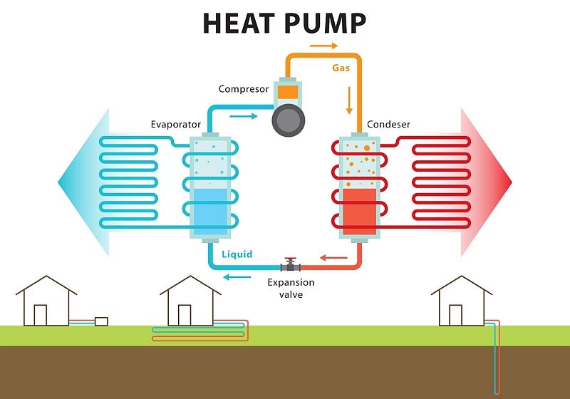

Yes, I can see it is a bit confusing.
The external air temperature is constantly varying, what we know as weather.
But inside the heat pump is a controlled environment, known gas volume and pressures, this leads to a constant temperature being produced (based on the ideal gas laws PV/T).
So almost regardless of what the external air temperature is doing, once the cold liquid refrigerant that is pumped into the outside heat exchanger, the bit with the air fan, warmed up a bit and changed into a gas, recompressing it back to a liquid will produce the same set temperature, time and time again.  It is this temperature that has to be significantly higher, or it will take a very long time to heat the water that is used for space heating or DHW.
Heating is not a linear process, as temperatures get closer to each other, the time taken to transfer energy increases.  This is why, if you leave the lid off an electric kettle, it will carry on boiling till it is dry.  It is trying to heat the whole kitchen to 100°C.
So imagine that, on the cold side of the heat pump, the gas is initially expanded, cooling as it does so, to say -30°C.  As it passes though the external heat exchanger, it warms up to say 10°C on a hot day, or only to -5°C on a cold day.  This 15° difference makes only the slightest temperature difference to the recompressed gas which may have a temperature of say around 70°C.  But it does vary the efficiency.
It is never possible to get your DHW (realistically the highest temperature you need) higher than that 70°C, and the last 10°, from 60°C upwards could take hours, so this is why heating it to a lower temperature, say 50°C is preferable.
There will be a sweet spot, for any given external temperature, where you can heat the water to.  This is a bit more complicated than purely a ratio between temperatures.  This is because (with modern 'inverter' ASHPs) the mass of air that is allowed to flow though the external heat exchanger is constantly varied.  Slow flow and more energy is extracted from the air, high flow, less energy is extracted, this is exactly the same as what happens with the internal flow rates around the plumbing system.
There are two reasons to vary the air flow rate, one is keep the temperature difference between the cold and hot sides of the refrigerant gas at a maximum, and the other is to stop icing up.  This is a bit of a balancing act, but usually works fine, though in the recent cold snap, some ASHPs have totally cut out, and other have frozen up, but it was extreme weather for the UK and we probably don't have the same set ups as they do in Canada, Sweden, or Japan.

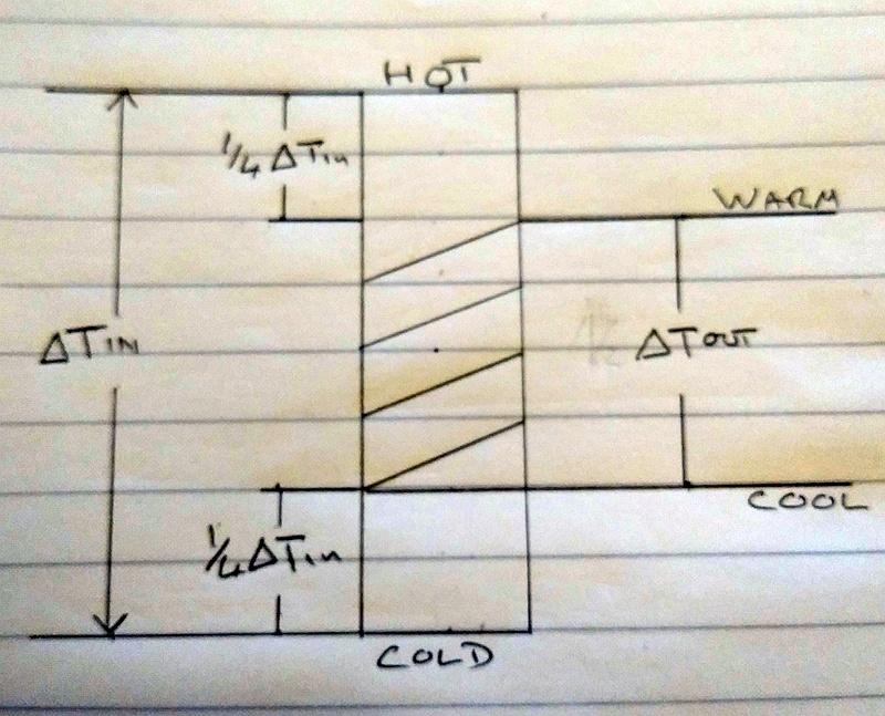

Possibly the second image may explain it a bit better.
Worth noting that, as I said earlier, temperature and energy are not the same thing, though they are related.
