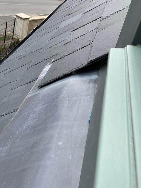

tmcb1234 Posted February 13, 2021 Share Posted February 13, 2021 Hi, On our new build house we have what I believe is referred to as a dormer in the roof - a window and accompanying structure jutting out from it. However I noticed recently a substantial draft and cold in the eaves of that room and that the room there and below will not heat above 18ºC. Checked the boiler, rads etc. and all fine. Then noticed that there is substantial gapping between the tiles and the underpinning structure either side of the window. Is this normal? I believe it isn't and may be causing the draft and the cold ceilings in the eaves storage cupboards. If it isn't normal, what is the correct phrasing I should use/any advice you have to get this sorted? And is there anything else to check/mention and make sure they do? The walls also feel cold in those rooms and the room underneath it and I can definitely feel a draft. Link to comment Share on other sites More sharing options...
tonyshouse Posted February 13, 2021 Share Posted February 13, 2021 There should both an insulation barrier and an airtightness layer in the construction and these should be all joined up. Sadly rare to find gaps between tiles should not cause cold draughts inside the house, the air tightness barrier should stop those. Insulation is generally poor for dormer windows and there are lots of places where it needs to be all joined up Are your eaves cupboards inside or outside the insulation barrier? Link to comment Share on other sites More sharing options...
joe90 Posted February 13, 2021 Share Posted February 13, 2021 The outer structure of any roof (including dormers) needs to be water tight but not draught proof and air movement keeps timber from rotting etc. You’re insulation/draught proofing should exists on the inner section sounds like this was not done properly. Link to comment Share on other sites More sharing options...

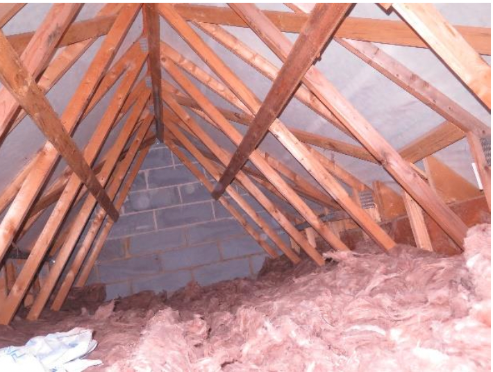

tmcb1234 Posted February 13, 2021 Author Share Posted February 13, 2021 4 minutes ago, tonyshouse said: There should both an insulation barrier and an airtightness layer in the construction and these should be all joined up. Sadly rare to find gaps between tiles should not cause cold draughts inside the house, the air tightness barrier should stop those. Insulation is generally poor for dormer windows and there are lots of places where it needs to be all joined up Are your eaves cupboards inside or outside the insulation barrier? Good question on the eaves cupboards I am not sure - they are built into the roof structure but the roof of those feels cold. The only insulation I could see in the loft is that on same level as the loft hatch there doesn't appear to be any on the timbers. Here's the loft itself - appears to be a breathable membrane. This was taken a few months ago. It is baffling to work out where these drafts and the cold is coming from. the ceiling in the room underneath the main bedroom was 10C today. Heating is on full blast with maximum rad temperatures and the room doesn't get above 18ºC. Link to comment Share on other sites More sharing options...
AliG Posted February 13, 2021 Share Posted February 13, 2021 (edited) That looks pretty normal. The insulation should ideally be 3-400mm deep. IT is what is known as a cold loft. The insulation is at ceiling level and then it is cold above that. Was the house built by a developer? Have you spoken to them about it? If you have rooms and storage in the eaves then it will have to be insulated at the rafter level, i.e. up close to the membrane that you can see here. Can you tell how thick the roof in these areas is? If it has PIR (Solid foam type insulation) I would expect the insulation to be 150-200mm thick and the roof to be 200-300mm thick in total. Can you see how the roof has been insulated in the eaves spaces? You might have a few issues - 1. The roof is not properly insulated in the areas where there are rooms in the roof. I would also be suspicious of how well insulated the dormer itself is. The walls of that dormer again would need to be at least 150m thick to be well insulated, the roof of it also. Is there much wall either side of the windows on the inside, you could estimate how much insulation there is from that. 2. If you have insulation at roof level then things need to be air tight below it otherwise the insulation is not going to work if cold outside air is blowing below it. In the eaves storage cupboards the roof of them should be sealed somehow to the insulation. It should be taped or have some kind of air tightness covering. 3. Cold air is presumably getting into the ceiling if it is sitting at 10C below another heated room. It will be trickier to figure out where this is coming from as you don't have access. Are there any spotlights in the ceiling. If so pull one down and see if you feel a draught. You will need a bit of a breeze outside. A cold loft like you have may be ventilated at the eaves. That is fine as it is above the insulation. But if this ventilation is in place at the eaves where there is a room above it then it would be ventilating your ceiling instead. 4. Can you see the wall of this room from up in the loft? The loft is effectively outside space so the room should have insulation on its wall facing the loft as they are effectively exterior walls. Similarly depending on how the roof is insulated the walls facing these space could need to be insulated. Pictures of the inside of the dormer, the eaves spaces and the loft facing this room would help. Edited February 13, 2021 by AliG Link to comment Share on other sites More sharing options...

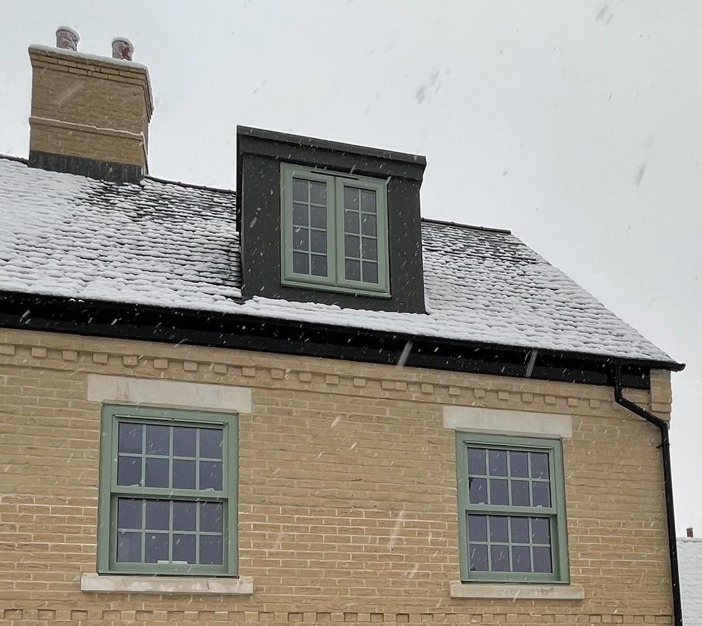

AliG Posted February 13, 2021 Share Posted February 13, 2021 Just looking again at the picture. Is there less snow on the roof above the room in the roof? That suggests that it is not well insulated compared to the area with a loft. Link to comment Share on other sites More sharing options...
tmcb1234 Posted February 13, 2021 Author Share Posted February 13, 2021 So that loft is above the master bedroom too at the top. essentially there is a loft hatch above the bedroom and the bedroom also has the dormer and the eaves storage. beneath that one of the rooms has a draught and very cold ceiling bu the other does not. Seem to have had an easterly wind and those rooms are east/south-east facing so that may be impacting it. We noticed that there was less snow on our roofs than other houses on the estate so may be contributory factor. However we notice the walls themselves on the floor below are also cold. Really keen to see if they have insulated at all in any of these areas but accessing walls/dormer/eaves may be hard so any tips welcome! Link to comment Share on other sites More sharing options...
