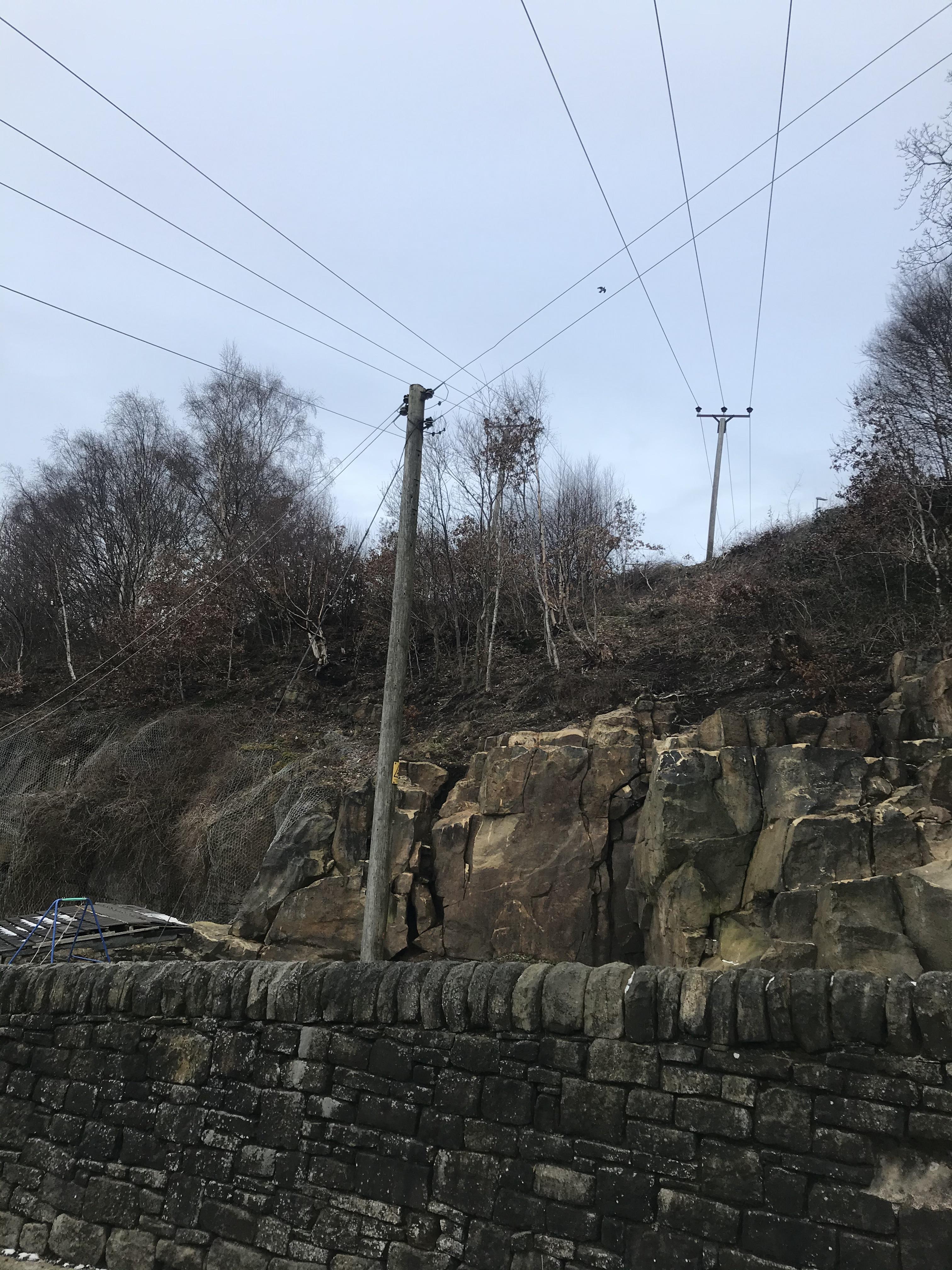

ProDave Posted February 13, 2021 Posted February 13, 2021 Can you post a picture of your nearest pole, the next one along, and the wire between them?
Afzal Posted February 13, 2021 Author Posted February 13, 2021 Certainly. I’m on site in a few hours I will take the pictures. Thanks

Afzal Posted February 13, 2021 Author Posted February 13, 2021 That’s the closest pole to me approximately 2-3 meters away

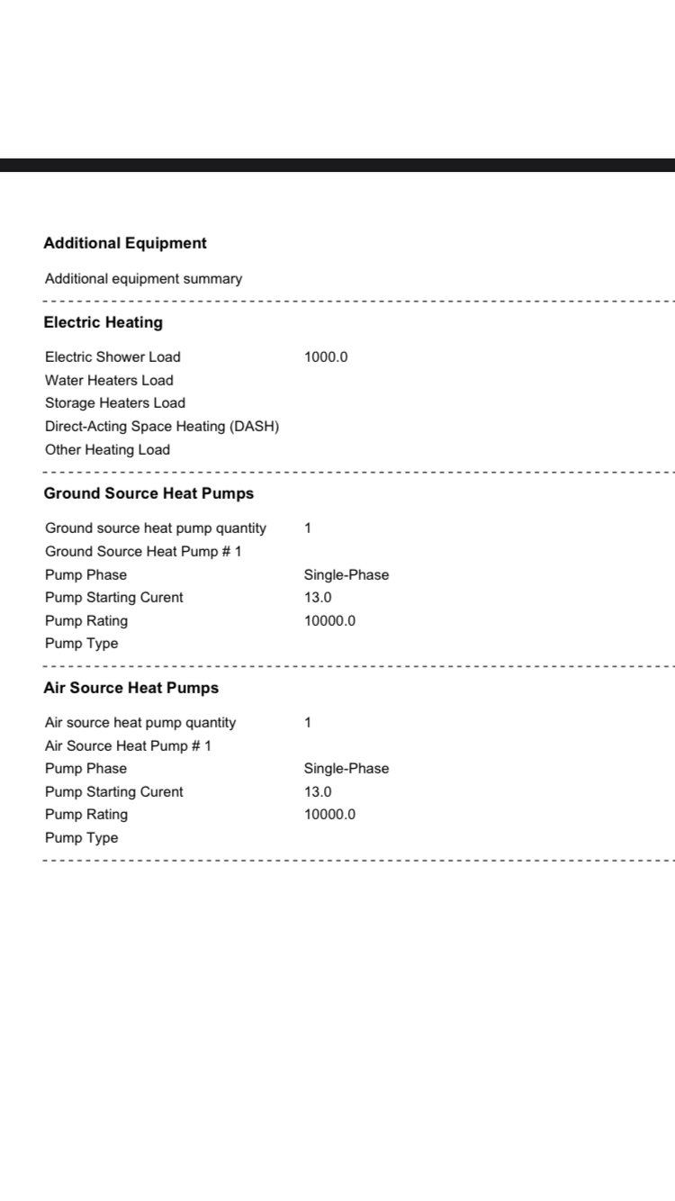

Afzal Posted February 13, 2021 Author Posted February 13, 2021 Is this all the information that I provided

ProDave Posted February 13, 2021 Posted February 13, 2021 You have rung alarm bells there by telling them you are going to have both a GSHP and an ASHP each at 10KVA so they will have been working on providing a 21kVA supply. no wonder they want to upgrade their network. 1
Faz Posted February 13, 2021 Posted February 13, 2021 7 minutes ago, ProDave said: You have rung alarm bells there by telling them you are going to have both a GSHP and an ASHP each at 10KVA so they will have been working on providing a 21kVA supply. no wonder they want to upgrade their network. This! You surely can't be having both? And you also have to allow for diversity. To give you an idea we are taking 23kVA for 3 large 4b detached houses (with gas CH).
TonyT Posted February 13, 2021 Posted February 13, 2021 1000 what for a shower? watts? That’s a rubbish shower! 1000amps? A bit excessive? form doesn’t make sense as you have 2 sources of heat pumps too unless you are doing one for DHW and heating separately?
Afzal Posted February 13, 2021 Author Posted February 13, 2021 Appreciate everyone’s reply have I got the watts completely wrong? sorry I’m totally new to building a new build therefore as much advice provided would certainly help. 1
