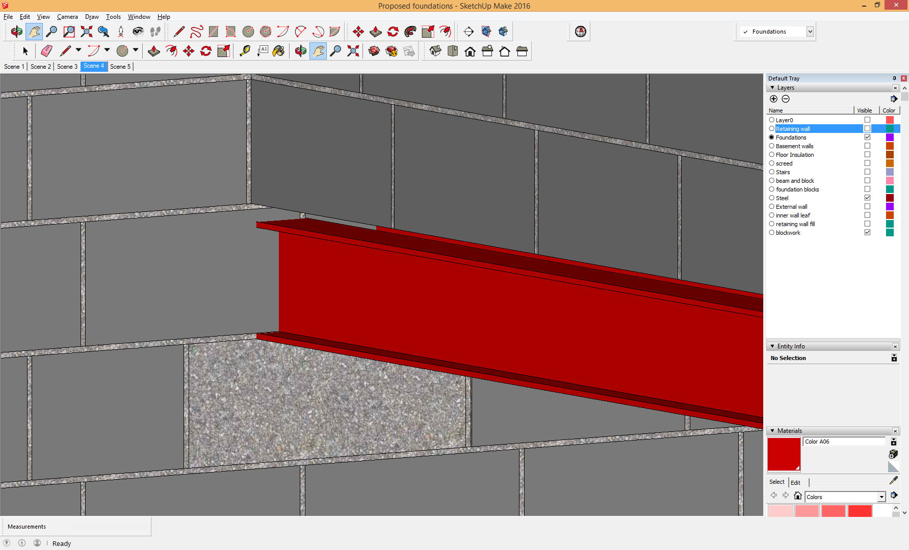

Moonshine Posted February 10, 2021 Posted February 10, 2021 In my proposed build i have a steel (203 x 102 UB) built into a blockwork wall on a pad stone, this supports a cavity masonry wall The steel rests straight onto the padstone, and leaves a 32mm gap above when the blocks tie in, as below. The question is, what is the 32mm filled with, i would have thought a 32mm mortar bed would be too thick, and the gap is too small for a slip.
James1994 Posted February 11, 2021 Posted February 11, 2021 I'm sure someone more knowledgeable than me will give you the correct answer, but just a couple of things in the mix. what about a larger pad stone, make it insitu? then steel will be correct height, or cut a small bit off the first course of blocks and run a course of engineering bricks. Regards James 1
JFDIY Posted February 11, 2021 Posted February 11, 2021 Are you having any fabricated steel in other parts of the build? If so, you could have a piece of plate (20mm?) welded to the underside of the steel beam at the bearing points to raise it up to match the block height. In your drawing you show no mortar under the blocks to the steel, wouldn't they normally be on a mortar bed?, this will take 10mm.
tonyshouse Posted February 11, 2021 Posted February 11, 2021 Lay a 9mm bed of mortar then plain roof tiles 14mm, then another bed of mortar then the block
Moonshine Posted February 11, 2021 Author Posted February 11, 2021 2 hours ago, JFDIY said: Are you having any fabricated steel in other parts of the build? If so, you could have a piece of plate (20mm?) welded to the underside of the steel beam at the bearing points to raise it up to match the block height. In your drawing you show no mortar under the blocks to the steel, wouldn't they normally be on a mortar bed?, this will take 10mm. I think I like this solution the best, not sure it needs to be welded, but the use of different thicknesses of steel shims ti make the 20mm, at both bearing points to ensure the beam is level.
MarkyP Posted February 11, 2021 Posted February 11, 2021 I wouldnt worry about it. Your block layers will address it. as suggested above, a course of bricks and a cut block course on the beam would bring things back into line with the adjacent blockwork. Things might change as built so I wouldnt try too hard to plan mm perfect details at this stage. Brickies will be used to bringing things back up to course height with beams and lintels.
TonyT Posted February 11, 2021 Posted February 11, 2021 Slate and mortar normally but maybe not for 30mm but I think the steel packer is the best solution
George Posted February 11, 2021 Posted February 11, 2021 Steel shims below the beam. Ask for a range between 20mm to 3mm in 100x100mm.
Mr Punter Posted February 11, 2021 Posted February 11, 2021 Yes, raise the beam up either by raising the padstone or packing under the beam.
