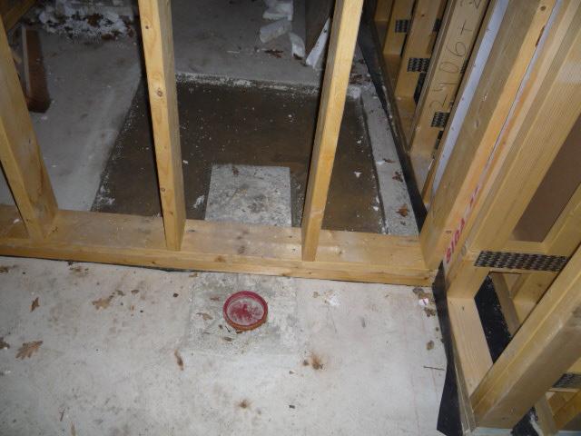

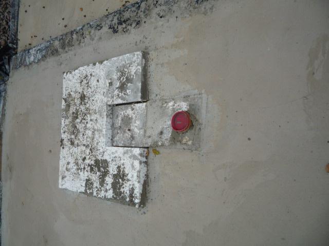

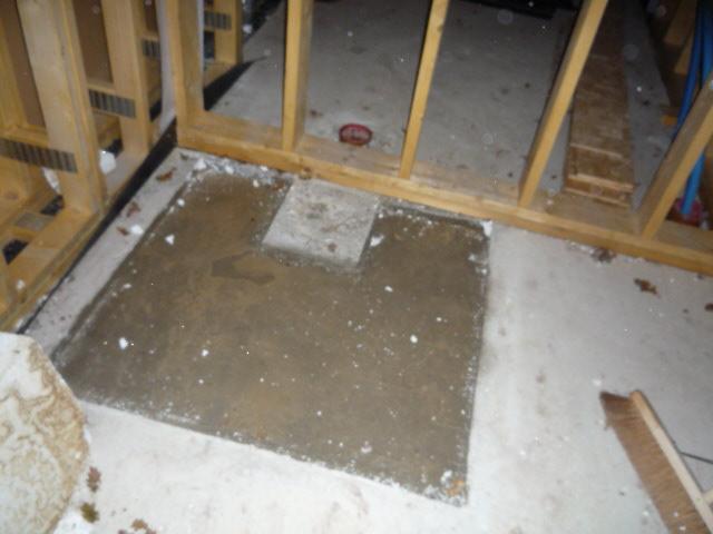

HerbJ Posted February 10, 2021 Share Posted February 10, 2021 Yes, I cast slots for shower and drain into the insulaated foundation, for a furure walk-in shower in the downstairs cloakroom . It was then filled in some spare insulation and tiled over. Photos of how we handled the slot during the pour and in frame erection. 1 Link to comment Share on other sites More sharing options...
