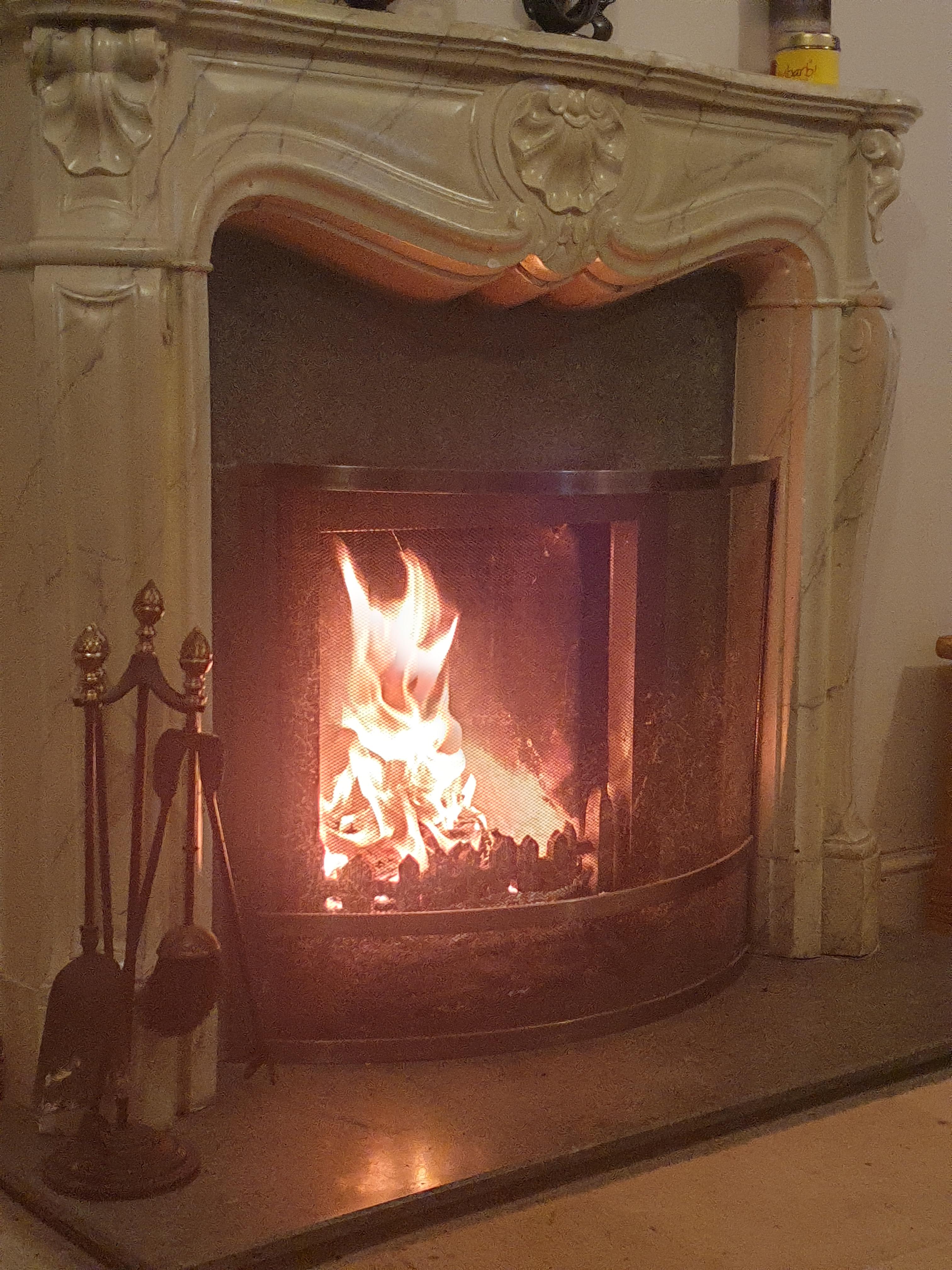

Buzz Posted February 9, 2021 Posted February 9, 2021 Just settling in for the night in front of the fire , I'm beginning to wonder if not having fire place in the new home is something I might want to reconsider? Can you have a good air test with a real fire place ?
Conor Posted February 9, 2021 Posted February 9, 2021 (edited) No. You could cheat the test by blocking the chimney, but in reality you'll just have a massive draft in the house and lose way more heat than an open fire would contribute. (I'm getting slightly militant about fires in new builds...) Edited February 9, 2021 by Conor
ProDave Posted February 9, 2021 Posted February 9, 2021 A room sealed wood burning stove should not hurt an air test much.
Buzz Posted February 9, 2021 Author Posted February 9, 2021 Thanks for the replies, I think its more psychological than a need for heat , just something about the flickering flames on a cold day , I do have caveman tendencies.
A_L Posted February 9, 2021 Posted February 9, 2021 @Buzz, strictly speaking it will make no difference to a pressure test as any open chimney should be sealed before the test, but 40m3/hr will be added to the SAP ventilation rate.
