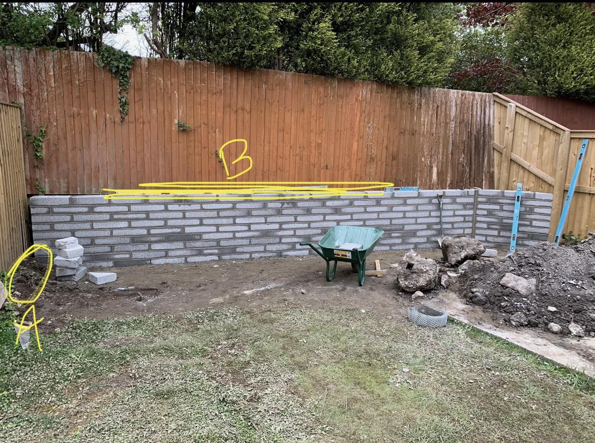

Good evening,
I'm after some guidance if possible on permitted developments for outbuilding, class E I believe. I am going to build a 5m x 4m wooden outbuilding 1m in from each side of my boundary fence line. The garden to my rear is around 1m higher than my garden with a retaining wall built on that back to support this and therefore the fence is 1.8m higher on top on the rear neighbours garden. Would the 2.5m high rule apply from point A on my photo or point B as the highest land adjacent to my ground is effectively point B with the rear garden and ground? Not that I want to build massively higher but id be interest at which point the 2.5m adjacent land would be taken from
Thanks in advance.
You can make out the original land an adjacent land behind the property into mine from the photos below before the retaining wall was built.
Thanks.
From the planning portal “you measure from the highest land adjacent to the outbuilding”, however in your case it appears your building away from, not on top of the retaining wall so I think you will be limited to heights from the highest piece of ground it actually sits on. So I would say “A”.
