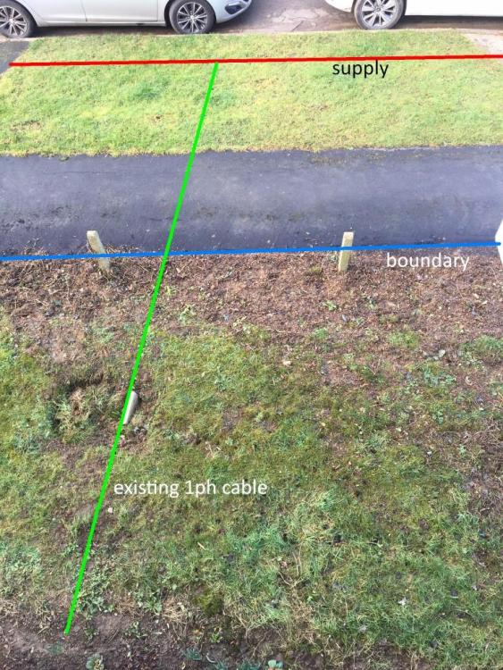

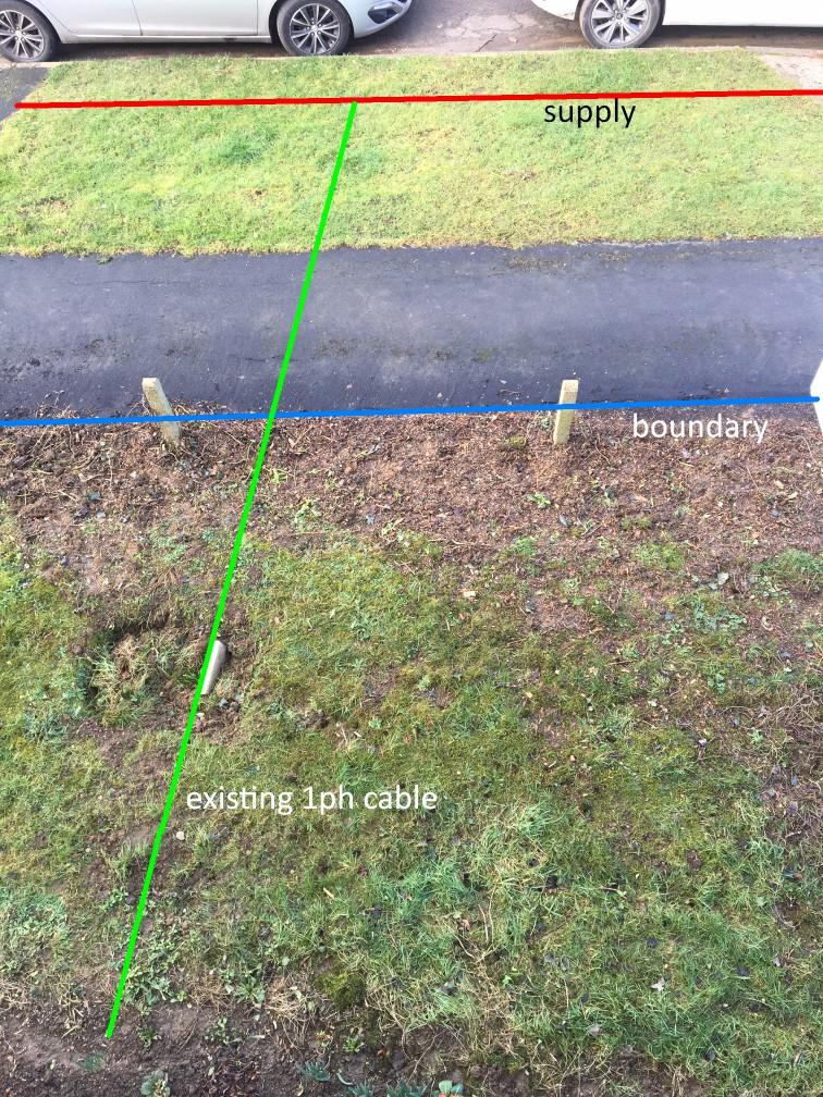

Olf Posted February 6, 2021 Posted February 6, 2021 Hmmm I though I was being ripped off, but it seems that they do charge electrician rates for digging jobs. SSE: 3m Unmade £107.04 1m Footpath £195.58 1x Joint Hole STRAIGHT JOINT - Unmade (1.2*1.2) £360.55 The actual electrical stuff Additional 1 Phase Services Without Service Jt (South) £158.63 Service Joint Only -100A 1 Phase off Main (South) £259.95 LV Pot End £143.84 This is for 1 phase to 3 phase upgrade, I dig and prepare everything on my side.
