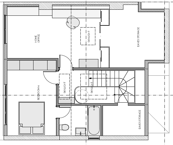

Adsibob Posted February 1, 2021 Posted February 1, 2021 I've only just realised (thanks to a comment by @joe90 on another thread) that ideally my unit should be placed centrally. This was not my original plan. Oops! This is what my loft floor looks like (or will look like once the builders get around to converting the loft later this year): In case it's relevant, this diagram is shown with: the party wall with the attached neighbours at the top (north); the street is to the right (east); a side passage at the bottom (south) between my house and my detached neighbours; and my garden is to the left (west). I had planned on siting my MVHR unit mounted against the external brick wall in the eaves storage that is to the bottom right corner, as this is: close to all three bathrooms in the house (one is directly under the eaves storage and the third is directly under the bathroom shown); the same side of the house as the kitchen (which is under bedroom 4 but out a bit into the garden (where we are extending at ground floor) not adjacent to any bedrooms or living spaces, so won't disturb anybody. But if the unit needs to be placed centrally, then this really isn't central at all as it is in the corner of the top floor of a three storey house. Another option is to place it in the larger Eaves storage space that is on the other side of the stairwell. That is more central although further away from all the wet rooms and very far from the kitchen. There is also no external brick wall there to mount it to other than the party wall, but that would defeat the purpose of mounting it centrally. I work from home in the "home office" most days (even before the pandemic) so the idea of having an MVHR unit so close to me is not something I'm keen on, because I have stupidly sensitive hearing and will probably hear it. That room also doubles as our guest room, so not great for guests either. The other option is in the utility room on the ground floor, that is up against the same external brick (southern) wall, but I thought it needed to go close to the roof. Any thoughts?

ProDave Posted February 1, 2021 Posted February 1, 2021 6 minutes ago, Adsibob said: So did you and @ProDave ignore the bit in the specs that says not suitable for extracting from bathrooms? Or maybe that's limited to this iteration of this model. Yes I have that unit. It was a cheap ebay purchase. When you drill down into the detail, my understanding was it cannot extract entirely from a humid area so no good for a swimming pool or large changing room. But in a domestic setting ours extracts from 2 bathrooms, a kitchen and a utility room. It is rare for more than one bathroom to be in use at once and the utility and kitchen are rarely very humid. So the high humidity while showering is "diluted" by the other rooms. It certainly does not give any issue in use and the heat exchanger core never appears to be wet or in any distress. As to the question in the OP, mine is off to one side in the house not central with the shortest vent run being about 3 metres and the longest about 10 metres. It was no problem balancing it. 1
Russdl Posted February 2, 2021 Posted February 2, 2021 @AdsibobI have no practical experience as ours isn't switched on yet, still waiting on electricity, however I would have thought there would be absolutely no issues mounting it in either of those eaves spaces regarding the duct run lengths and lack of centrality to the building. Whilst the bottom right option gives you an external wall to go through you say it is south facing and between two properties so potentially the intake air could get quite hot in the summer months. Your other option in the top right would mean you would have to go through the roof with your intake and exhaust. If you went for the top right option I should think you could mitigate any noise transference issues without too much difficulty.

PeterW Posted February 2, 2021 Posted February 2, 2021 Oh and another vote for the Lossnay units. They are very good and have an enthalpy heat exchanger as standard - hence why they cannot be used in permanently wet environments. What is interesting is in winter the external intake RH is consistently higher than the extract, even from bathrooms, as it is blended with extract air from all “wet” sources which are unlikely to all be creating steam or moisture at the same time.
