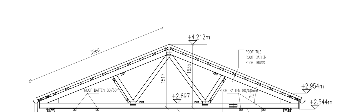

hmpmarketing Posted February 6, 2017 Posted February 6, 2017 (edited) Hey all, I was wondering if a "slight" change in roof pitch for my approved garage, would I require a new planning app or an amendment? I was thinking in going from 22° to 32° to get a max 2.3m height from 1.51m as per my approved plans, and use that space for my bass practice room Thanks for your thoughts Edited February 6, 2017 by hmpmarketing

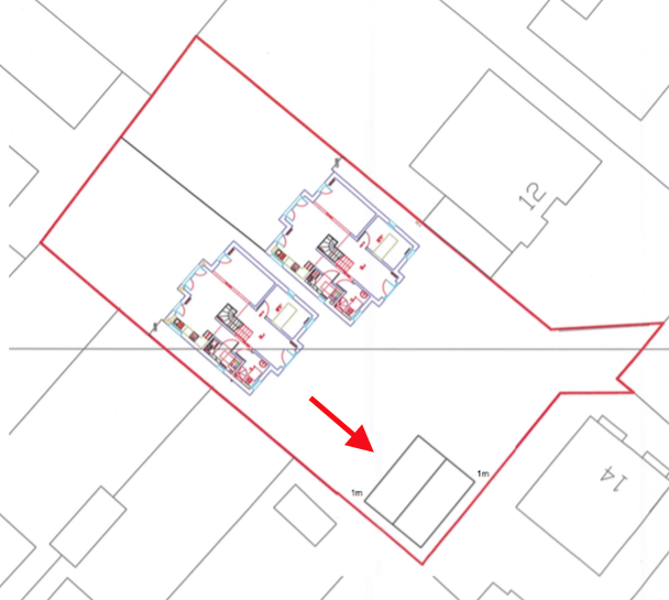

hmpmarketing Posted February 7, 2017 Author Posted February 7, 2017 (edited) 11 hours ago, TerryE said: So it depends on your LPA but if your garage is in front of the property or this change impacts the site-lines of any neighbours then the planners might still insist on your submitting a minor material amendment. Here is the site layout FYI Edited February 7, 2017 by hmpmarketing
AliG Posted February 7, 2017 Posted February 7, 2017 With the garage so near to the boundary I would think that it is a material change to your neighbour. This will be particularly true if they objected before due to the garage. 1
TerryE Posted February 7, 2017 Posted February 7, 2017 Yup, I agree with @AliG. I don't think that you'll get way with this as an NMA. Your garage is only 1m from your neighbours boundary, and this amendment will obscure what at the moment is a fairly open sight-line across open gardens and they will lose their view of the setting sun. IMO, the LPA might even treat this as a material amendment. At some point you will need to get your neighbour at No 14 onside. One option might be to trade moving the whole garage to the NE to open up his west facing sight-line to the detriment of his N facing one. I think that you'll need to tread carefully on this one. 1

hmpmarketing Posted February 7, 2017 Author Posted February 7, 2017 So guys, spoke with the case officer. His words: I don’t consider that we can treat this as an NMA, this being because of the height increase and its position adjacent to the boundary and close to the rear of no. 14. We would need to re-assess the impact on no. 14. I think you’d need to re-apply for the same as before i.e. “Application for variation of conditions No. 2 & 7 imposed under planning reference BR/XXX/XX/PL relating to amended plans & by substituting existing garage for a larger garage incorporating cycle storage”. So I will have to re-apply the same way I did to extend the garage size (from 6x6m to 8x6m). Such a shame I didn't think about it back then! @AliG @TerryE Regarding the neighbour on number 14, he only has one obscure bathroom window facing our plot. It is a small window and from previous applications, nothing was considered to impact on them, although case officer wants to re-asses.

TerryE Posted February 7, 2017 Posted February 7, 2017 3 hours ago, hmpmarketing said: Regarding the neighbour on number 14, he only has one obscure bathroom window facing our plot. It is a small window and from previous applications, nothing was considered to impact on them, although case officer wants to re-asses. As I thought, he's gone the full amendment route. A good way to pre-empt any concerns from the planners is to have a word with your neighbour, and get him to write a letter of support which you can include with the application. With a full application, he's going to be consulted anyway, so being proactive will probably go down well. 1
