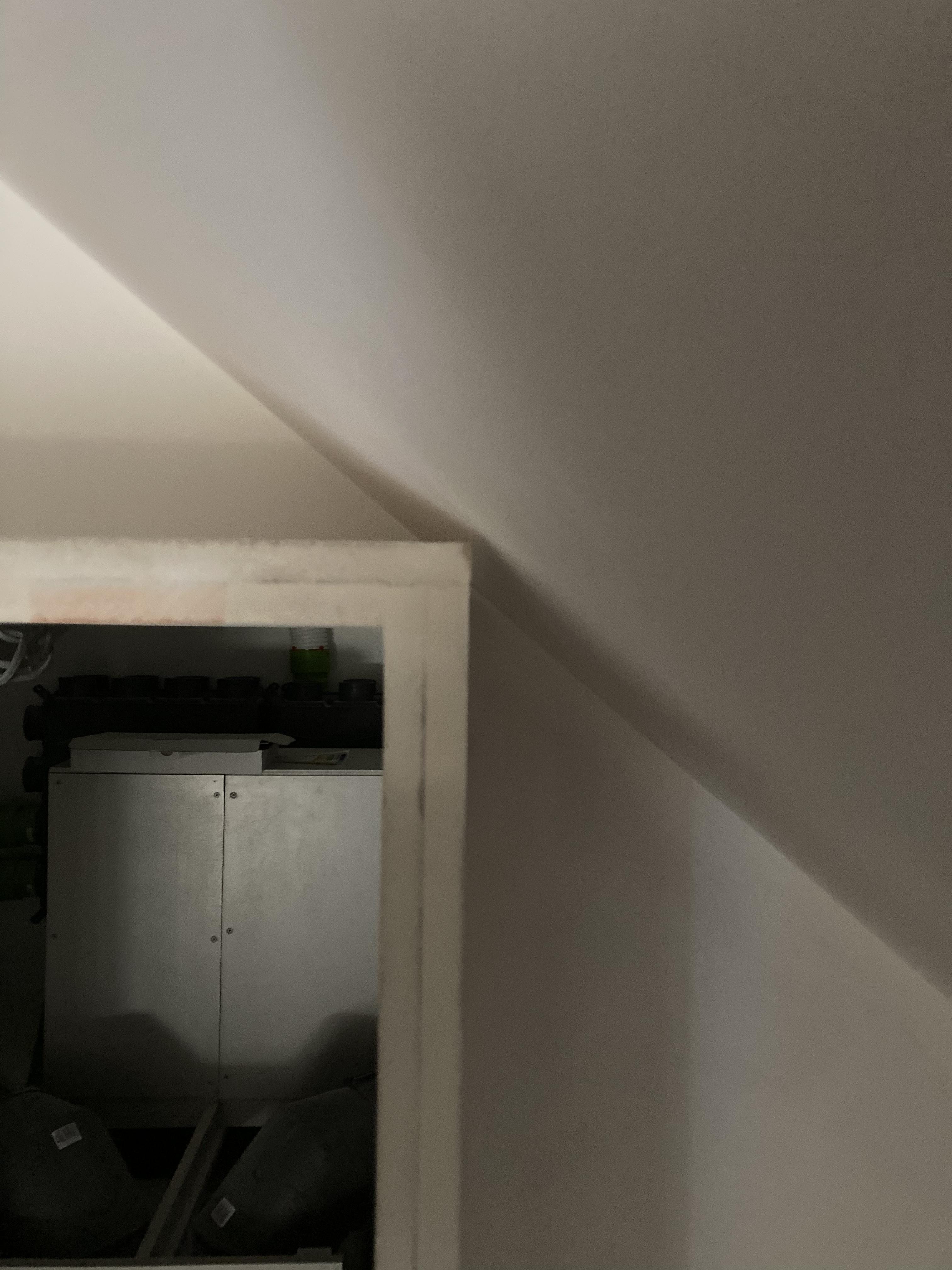

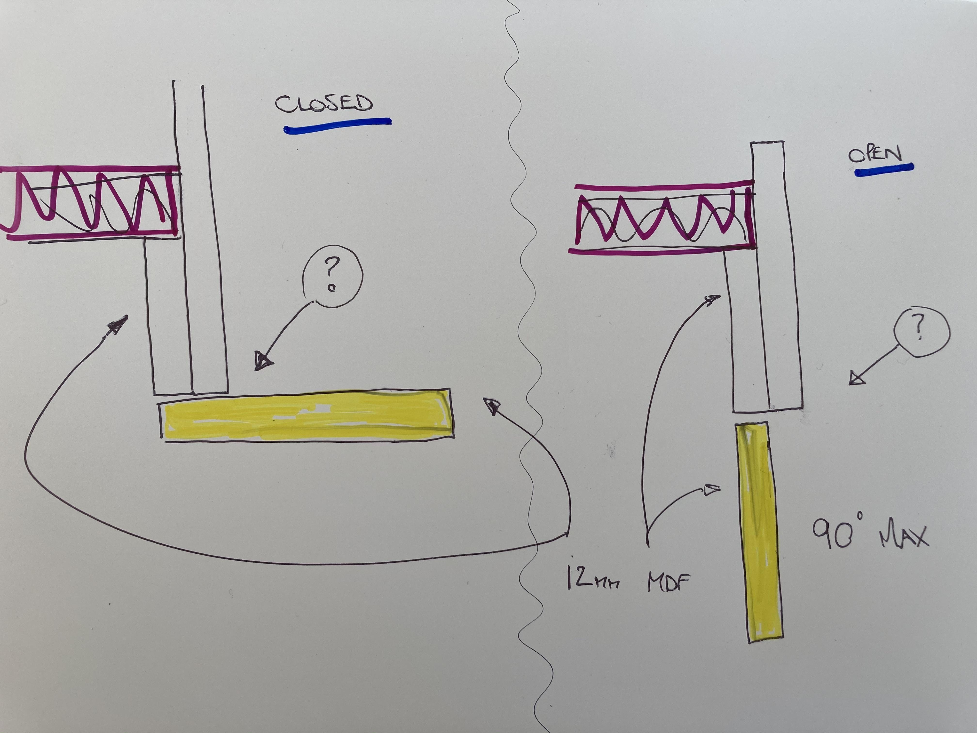

Russdl Posted January 29, 2021 Posted January 29, 2021 What hinge do I need to allow a wardrobe door to open and close as per the image below? I’m completely whelmed by the choice available, bordering on over whelmed.

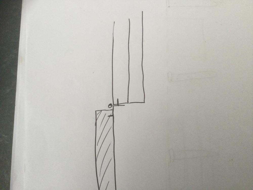

joe90 Posted January 29, 2021 Posted January 29, 2021 That’s difficult, initially I thought “kitchen” hinges but they only fit with one piece of side panel, you have two (doubled). Plus they are recessed into the mdf and that is usually min 15mm. Can you not do as below?
Russdl Posted January 29, 2021 Author Posted January 29, 2021 @joe90 I don’t have the room for hinges as per your diagram, it’s in the loft so limited space, plus if it opens more than 90 degrees it’ll start digging holes in the plaster. 1

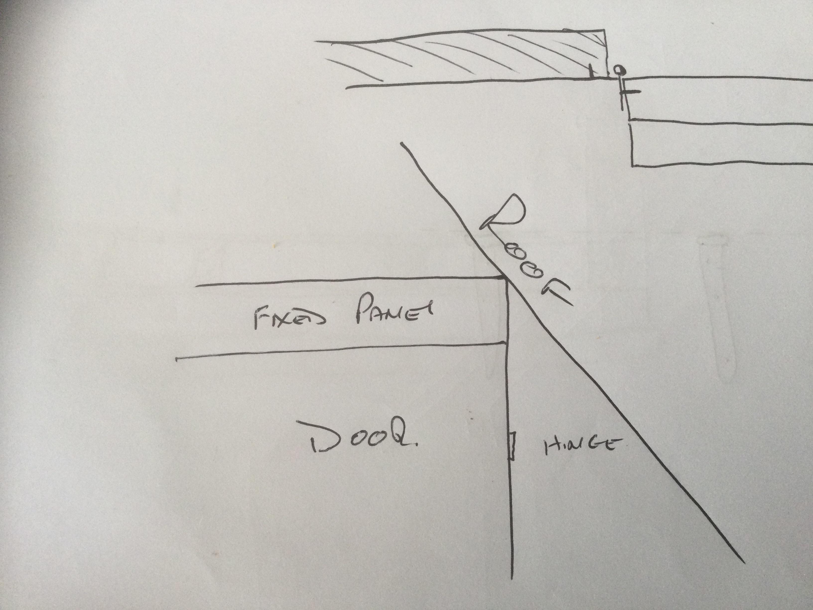

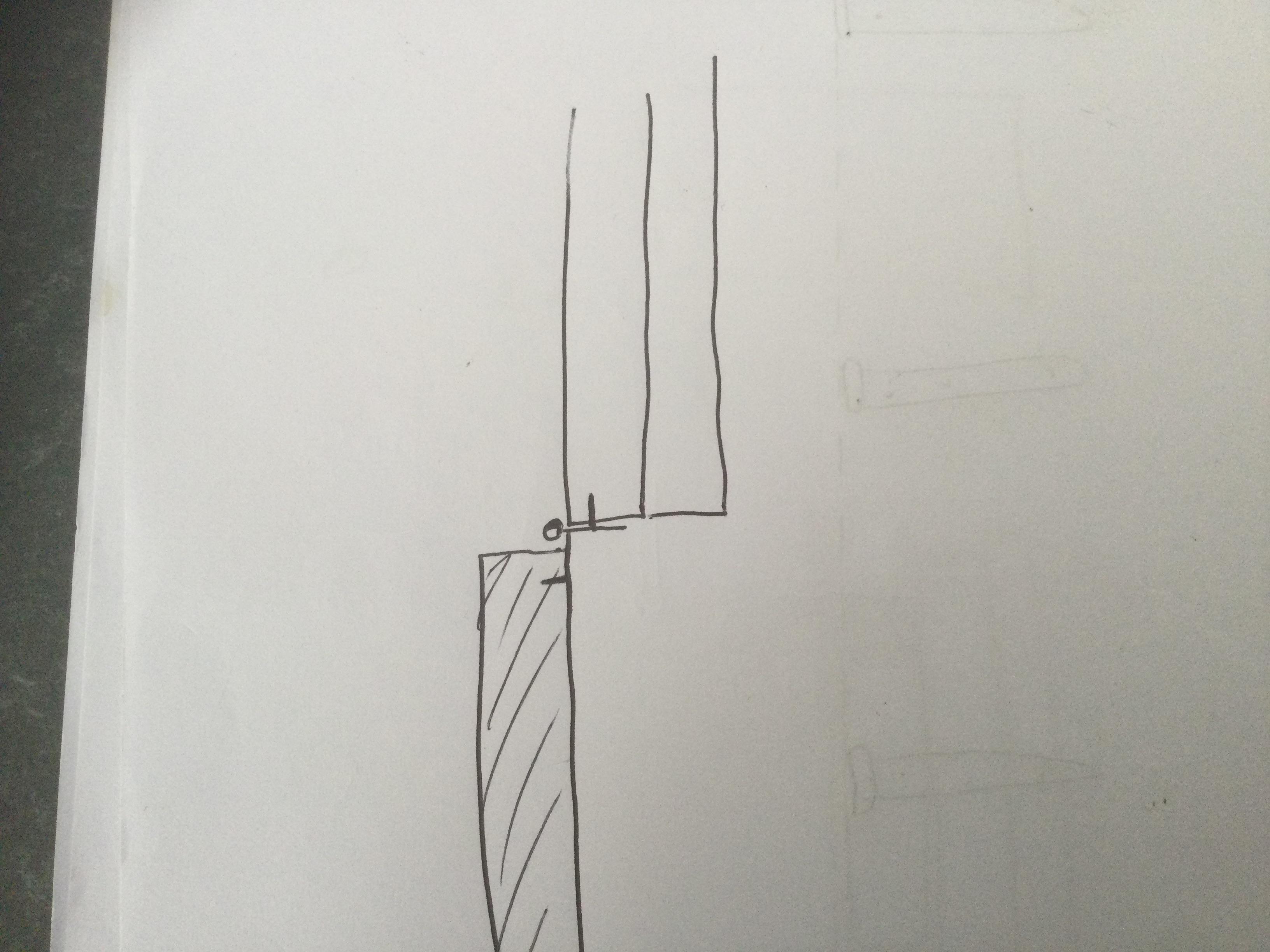

joe90 Posted January 29, 2021 Posted January 29, 2021 @Russdl, not sure what you can do, with double side panels and single door panel you need a “swinging” hinge, like used fir kitchen cabinets, but as explained above I know of none that do this and my other suggestion won’t fit your loft dimensions. I hope someone can come up with a solution for you. Trying to think “outside the box” you could fit as below and still use hinge idea above. 1
Jason L Posted January 29, 2021 Posted January 29, 2021 Cant you put the door inside of the opening and large architraves on the face of the frame ? 1

Russdl Posted January 29, 2021 Author Posted January 29, 2021 @Jason L that’s not a bad idea. It won’t narrow it down too much. @PeterStarck that was the catalogue I got lost in ? @joe90 the doors don’t exist at the moment so they could be 15mm in which case I don’t have a problem I guess, I could either route out the two 12mm bits to recess the hinges or mount the hinges on the inside face and have 9mm of frame showing when the doors are closed?
joe90 Posted January 29, 2021 Posted January 29, 2021 3 minutes ago, Russdl said: I could either route out the two 12mm bits to recess the hinges or mount the hinges on the inside face and have 9mm of frame showing when the doors are closed? Yup, both would work. 1

joe90 Posted January 29, 2021 Posted January 29, 2021 (edited) 28 minutes ago, PeterStarck said: Not quite sure I understand but aren't the side panels double thickness and the door doesn't have to be the same thickness, mine aren't. Trust me it won’t work unless you recess the hinge on the side panel to match the door thickness (ask me how I know ?) you only need to recess to get the hinge plate in the side panel. you could not recess as long as you don’t mind 9mm of the side panel showing, which might give you a bit more grace regarding hitting your ceiling. Edited January 29, 2021 by joe90
Russdl Posted January 29, 2021 Author Posted January 29, 2021 Thanks everyone for the feedback. I think I’ll end up with mounting the hinges inside which will leave about 9mm of the frame showing. I can live with that and plus it will give me a few mm extra before the open doors hit the loft ceiling. 1
