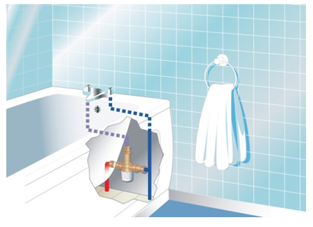

Onoff Posted February 6, 2017 Author Share Posted February 6, 2017 Still a bit lost on this, being a bit dense no doubt! The TMVs I've seen are "3 port". Hot in / cold in and then mixed and regulated out I guess. I've two separate pipes going to a mixer tap. Where does the TMV go, in the hot pipe? I can see that working so that hot is only ever at a certain maximum and you would just add cold if it was still too hot for some tastes. Do I end up with an unused port on the TMV? Again, dumber than soup I know! Link to comment Share on other sites More sharing options...
dogman Posted February 6, 2017 Share Posted February 6, 2017 you are sort of right but not ( and again happy to be corrected) you are trying to lower the temp of the incoming hot water to a safe level so it goes in the hot feed you will have cold to cold cold t TMV Hot to TMV tmv to hot tap or mixer Link to comment Share on other sites More sharing options...

dogman Posted February 6, 2017 Share Posted February 6, 2017 be careful choosing, we used TMV3 and 22mm as they will impact on flow rate. If for holiday let get a water thermometer and keep a record of your checks we do them every month. Link to comment Share on other sites More sharing options...
Onoff Posted February 6, 2017 Author Share Posted February 6, 2017 59 minutes ago, dogman said: http://www.willesdenbathrooms.co.uk/media/catalog/product/cache/1/image/9df78eab33525d08d6e5fb8d27136e95/t/m/tmv-img-detail.jpg this might help Gotcha! Understand the idea now. So set at 44 to 46degC? For some reason I find this image easier to understand: Just for home. Need to fit one as the 10 year old has grown up without a bath in living memory! Looking on S'fix there's a Bristan for circa £45 and a Bristan and a Pegler for £50 ish. All good for TMV2 & 3. I assume buy a "name"? The Pegler is preset at 43degC. There's a no-name TMV2 on in T'station for £38. ??? Link to comment Share on other sites More sharing options...

dogman Posted February 6, 2017 Share Posted February 6, 2017 We have just one for the bath and sink set at 43 deg max It does mean that if you like a hot bath you don't add cold. Link to comment Share on other sites More sharing options...
Nickfromwales Posted February 6, 2017 Share Posted February 6, 2017 I'd also say just fit one and set it as high as you can tolerate at the basin. That'll give plenty for the bath as hands are more tolerant than your 'white bits'. Link to comment Share on other sites More sharing options...
