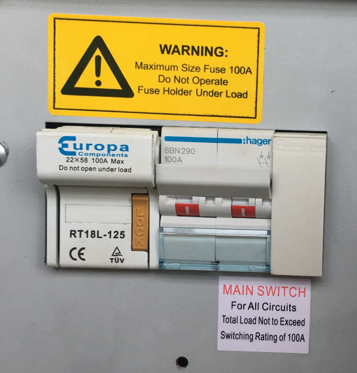

epsilonGreedy Posted January 27, 2021 Author Share Posted January 27, 2021 This is the switched end of the trail in the cavity wall meterbox. The electrician added this before mounting a temporary 2 x RCD CU inside the house under a flap of dpc to keep the weather off before the roof is complete. Link to comment Share on other sites More sharing options...

TonyT Posted January 27, 2021 Share Posted January 27, 2021 The photo is fine. THe DNO cut out fuse protects the first 2.5 m or up to 3m it varies on DNO. Your switchgear protects the tails to the new consumer unit, so it’s all looking good. the worst thing you can do is bring all the cables down together at the consumer unit and tape/tyrap them together in one group as the cables in the middle won’t be able to dissipate their heat to free air, but to other cables. So they are classed as touching. So better to have several groups of cables than 1 big one. Link to comment Share on other sites More sharing options...
