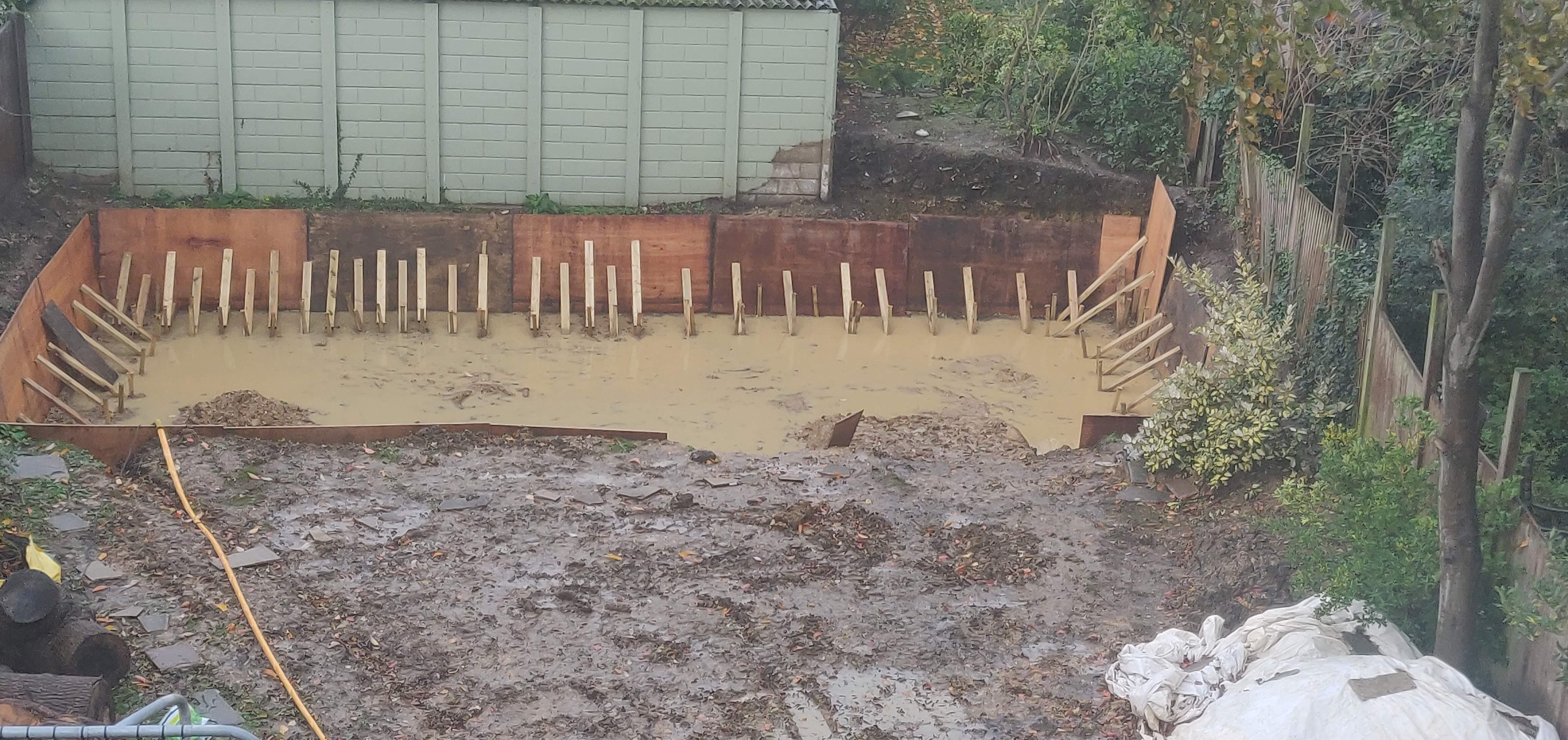

Andy H Posted January 26, 2021 Posted January 26, 2021 I am new to self building and stumbled across your forum. I have spent a few days browsing various topics and am impressed by the quality of the advice, information and the kind manner in which it is given. Being new to self building at this stage I'm unlikely initially to be able to offer much advice to others but as my knowledge and experience grows I look forward to being able to contribute to others. I have chosen to start a blog ("Garden Escape") that records the journey of my first self build; a single storey building at the bottom of our garden that is intended to fulfill a number of functions - home gym, workshop, bicycle store and bolt hole - located in London I am completing the build under permitted development and in order to get an internal ceiling height in the range of 3 to 3.25m I am excavating to allow the building to start underground. This introduces additional complications and along with the building being close to the 3 neighbouring boundaries this seems quite a challenging project to undertake. I have plenty of time available to work on the project and along with a friends son I am aiming to minimise the amount of involvement of others to keep build cost down. I do recognise that I will need to pay for some skilled help and through this forum I will look for guidance on when that may be the case. The project started in the summer of 2020 by the removal of 2 trees and the excavation of a hole 12.5m by 6.5m by 1.2m deep, which is now shuttered up with plywood ready to restart in Spring 2021. I have appointed a Building Regulations inspector and had an initial site visit from a structural engineer (not yet appointed). The decisions I have so far made are: 1. Build using ICF either Isotex or Logix 2. Foundation to be Isoquick raft 3. Build in the principles of Passive housing but am not looking for cerification. 4. To build as close as practically possible to the neighbouring boundaries to maximise the building space. 5. The building is to include a toilet, shower and small kitchen facilities - mains drains approximately 40 meters away at the front of the house. I have done alot of reading up online in the last month and on this forum in the last couple of days but as you might expect I have a ton of questions. For now I would like feed back on the best way to get advice through the site. Should I post seperate questions into specific forums, put the queries through the blog, an initial post with all my current queries or message individual members whom appear experienced with the specific queries? Kind regards Andy 1

DevilDamo Posted January 26, 2021 Posted January 26, 2021 10 hours ago, Andy H said: I am completing the build under permitted development and in order to get an internal ceiling height in the range of 3 to 3.25m I am excavating to allow the building to start underground. How much are you excavating, in excess of 1m?
Andy H Posted January 26, 2021 Author Posted January 26, 2021 26 minutes ago, DevilDamo said: How much are you excavating, in excess of 1m? It depends on the foundation specifcation but if I assume that the hardcore(20cm) insulation(20cm) and concetere slab(20cm) take up 0.6m and the roof takes up a minimum of 0.3m then to get an internal height of 3.25 metres and stay within permitted development rights of 2.5m I would require a depth of 1.65m. I am currently at 1.25m

DevilDamo Posted January 26, 2021 Posted January 26, 2021 16 minutes ago, Andy H said: It depends on the foundation specifcation but if I assume that the hardcore(20cm) insulation(20cm) and concetere slab(20cm) take up 0.6m and the roof takes up a minimum of 0.3m then to get an internal height of 3.25 metres and stay within permitted development rights of 2.5m I would require a depth of 1.65m. I am currently at 1.25m That is quite some effort all in order to keep it within PD. I assume formal Planning wasn’t an option?

Andy H Posted January 26, 2021 Author Posted January 26, 2021 18 minutes ago, DevilDamo said: That is quite some effort all in order to keep it within PD. I assume formal Planning wasn’t an option? Planning was an option but I wouldnt have wanted to go much above 2.5m above the garden level as the building would be too dominating in the garden.

DevilDamo Posted January 26, 2021 Posted January 26, 2021 50 minutes ago, Andy H said: Planning was an option but I wouldnt have wanted to go much above 2.5m above the garden level as the building would be too dominating in the garden. That’s fair enough. It does seem the more expensive way of going about it. Even if you were to be happy with a 3m height above ground level, which reduces excavation and costs. But you’re at that stage now so no point dwelling on it.
