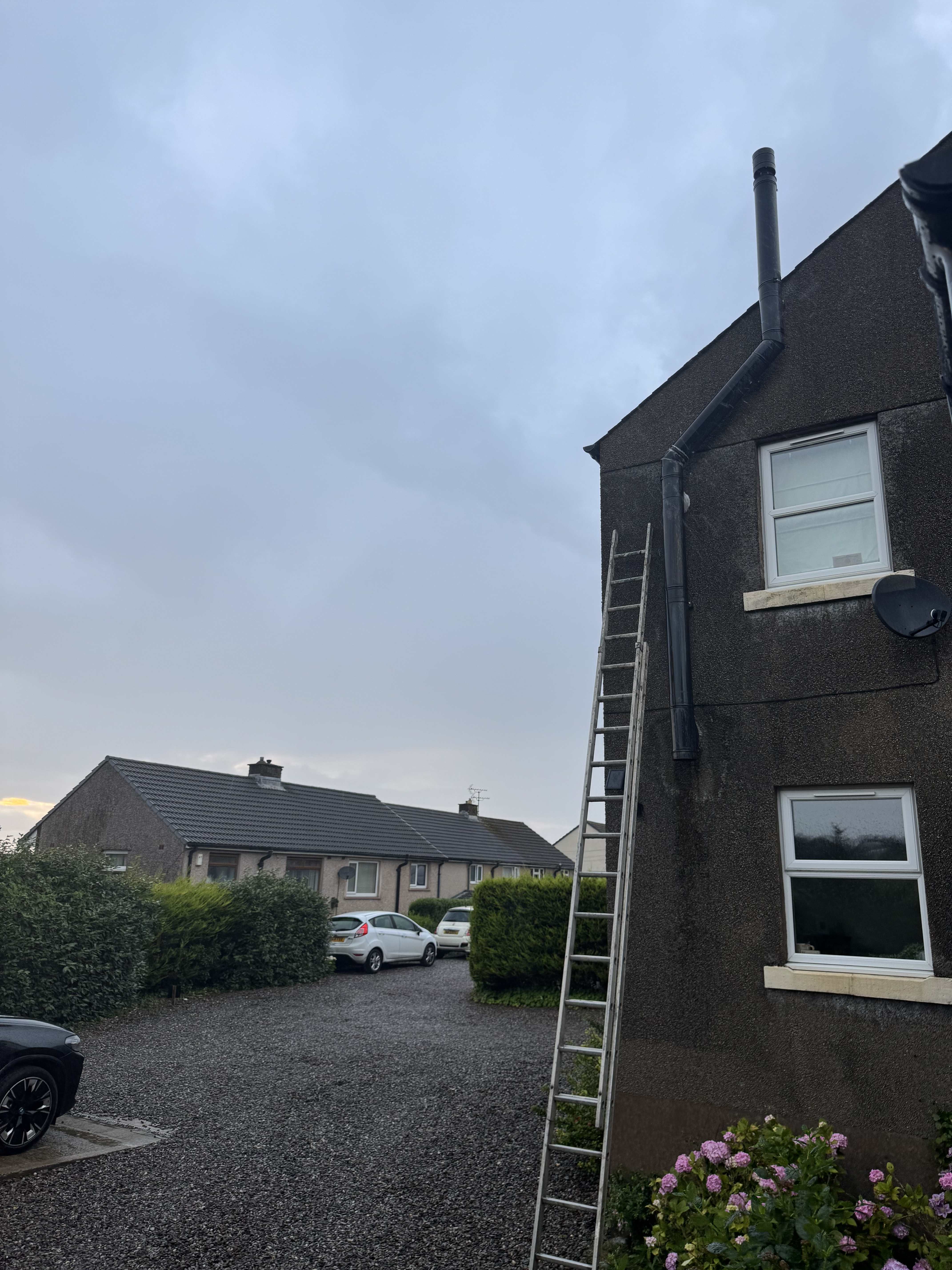

soapstar Posted January 25, 2021 Share Posted January 25, 2021 Hi Folks, Recently had our wood burning stove installed (all above board) by a qualified stove fitter and noticed the other day we have moisture on the top of the stove, didn't think much of it as we have hardly used it (maybe twice before this) and thought perhaps its condensation etc. However yesterday we now have a little pool of water sitting on top of the stove (picture attached), strange thing is we haven't had rain for a few days - only frost. Twin wall flue with cowl on top etc What on earth could cause this to happen?! ? Link to comment Share on other sites More sharing options...

PeterW Posted January 25, 2021 Share Posted January 25, 2021 This is twin wall isn’t it ..? Is the liquid clear and does it have any smell at all..?? Points to a potential issue where the cap of the flue may not have been installed correctly and the insulation layer is getting wet or has previously got wet and frozen / thawed and this is running down the inside of the insulation jacket. It would be very unlikely that this is flue leakage and more likely outer skin leakage if the liquid is clean looking. 1 Link to comment Share on other sites More sharing options...

soapstar Posted January 25, 2021 Author Share Posted January 25, 2021 (edited) 5 minutes ago, PeterW said: This is twin wall isn’t it ..? Is the liquid clear and does it have any smell at all..?? Points to a potential issue where the cap of the flue may not have been installed correctly and the insulation layer is getting wet or has previously got wet and frozen / thawed and this is running down the inside of the insulation jacket. It would be very unlikely that this is flue leakage and more likely outer skin leakage if the liquid is clean looking. Yes twin wall. At first the liquid was quite oily/watery to touch, when hot it stained the stove white. Now this time it seems to be just water, there is no oily consistency to it now. It certainly isnt black or sooty coloured Your theory seems the most likely actually. It would make sense as there is no wetness inside the stove. What exactly is inside the insulated part of the flue, would the water be absorbed into anything? Hence the time it takes to reach the bottom of the flue? Edited January 25, 2021 by soapstar Link to comment Share on other sites More sharing options...
PeterW Posted January 25, 2021 Share Posted January 25, 2021 Ok so oily would be the coating off the stainless potentially. What is the cap at the top of the flue ..? Got any photos ..?? Link to comment Share on other sites More sharing options...
soapstar Posted January 25, 2021 Author Share Posted January 25, 2021 Sorry I have just realised I have no close up photos of the external flue! Link to comment Share on other sites More sharing options...
PeterW Posted January 25, 2021 Share Posted January 25, 2021 Doesn’t look straight from there so cap could be leaking. Link to comment Share on other sites More sharing options...
soapstar Posted January 25, 2021 Author Share Posted January 25, 2021 3 minutes ago, PeterW said: Doesn’t look straight from there so cap could be leaking. I was thinking that myself ? Link to comment Share on other sites More sharing options...
PeterW Posted January 25, 2021 Share Posted January 25, 2021 That’s a cherry picker job by the looks of it. Wonder if the locking band hasn’t been done up properly...?? Link to comment Share on other sites More sharing options...
soapstar Posted January 25, 2021 Author Share Posted January 25, 2021 2 hours ago, PeterW said: That’s a cherry picker job by the looks of it. Wonder if the locking band hasn’t been done up properly...?? I will have to investigate later on, looks very suspect! Thanks Link to comment Share on other sites More sharing options...
soapstar Posted February 15, 2021 Author Share Posted February 15, 2021 To anyone interested down the line it was actually the cap that was leaking, it was changed out for a different style and this has fixed the issue! Yay on to the next issues! 2 Link to comment Share on other sites More sharing options...
