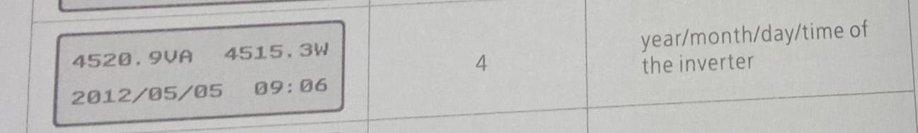

SteamyTea Posted January 25, 2021 Share Posted January 25, 2021 Make sure this is set right. Link to comment Share on other sites More sharing options...
canalsiderenovation Posted January 25, 2021 Author Share Posted January 25, 2021 (edited) 28 minutes ago, SteamyTea said: Make sure this is set right. That's the problem I can't get into anything now as the knocking thing brings up one screen and then it goes off and no amount of knocking can get back. I'll have to check it out tomorrow when it's on. I wonder if there is some additional type of monitoring system I can get. I think they do some sort of other connectors with the Growatt. Edited January 25, 2021 by canalsiderenovation Link to comment Share on other sites More sharing options...

canalsiderenovation Posted January 26, 2021 Author Share Posted January 26, 2021 Right I've now set the date and time which was wrong. That knocking is probably one of the most painfully slow processes ever. Resorted to hitting the damn thing with a rubber sandpaper block. Wife is going to look at the meter terminals later after work. Solic200 isn't working with all red lights so the electrician will need to sort that out because that's not been working since he installed it. Link to comment Share on other sites More sharing options...
