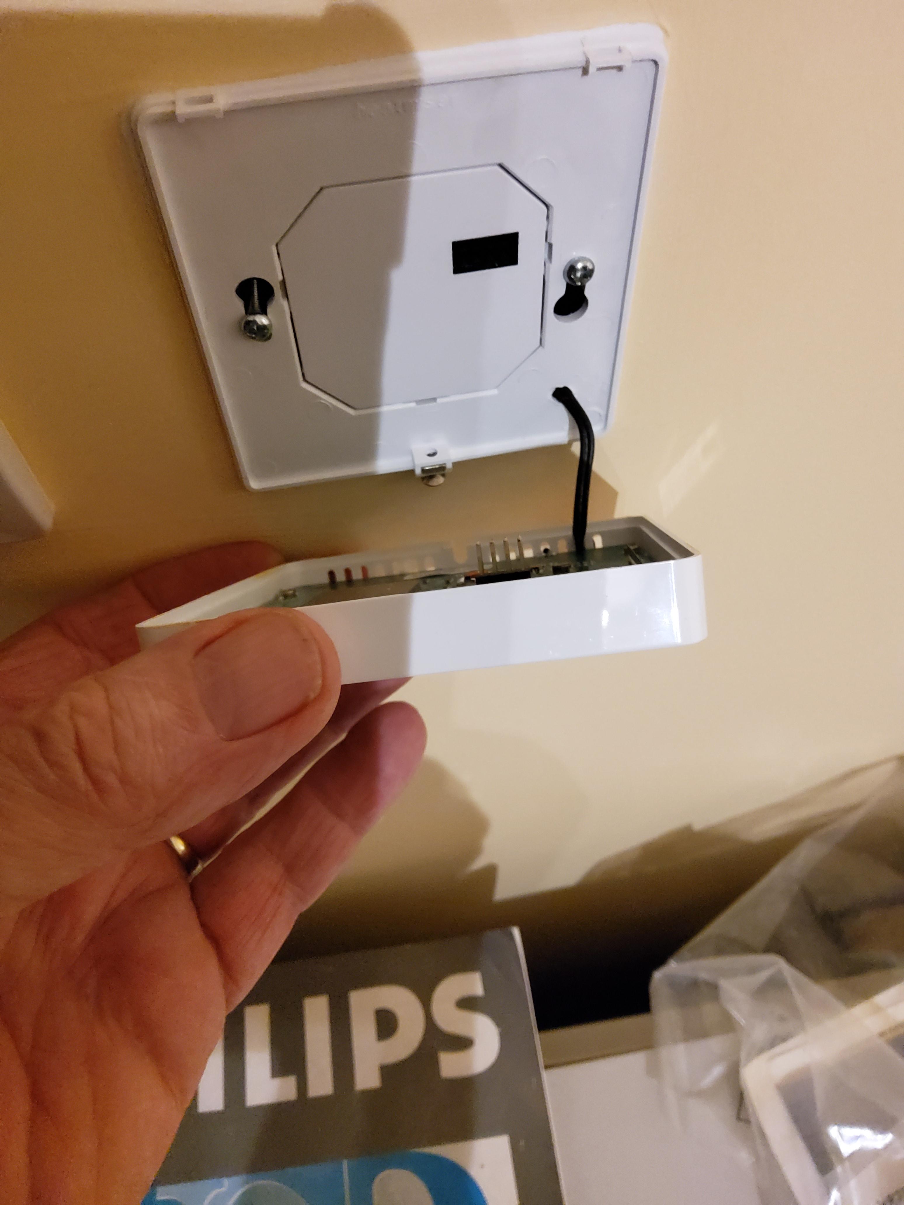

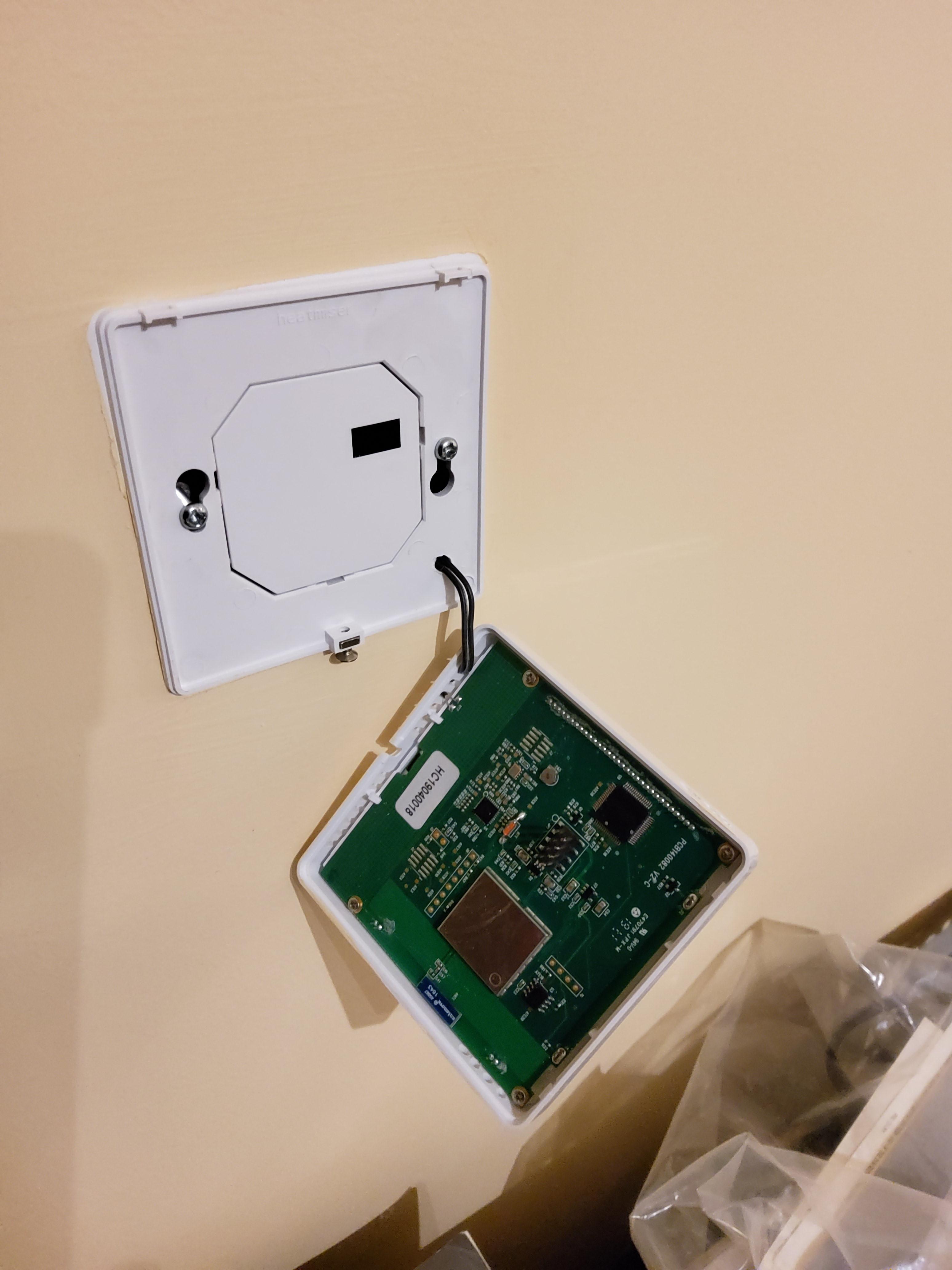

Ultima357 Posted January 21, 2021 Author Posted January 21, 2021 5 hours ago, JFDIY said: What about making a spacer plate to sandwich behind the stat and protrude below enough to house the sensor. Could make from acetal or white perspex sheet and polish the edges to look decent. Unfortunately in these stats, the face plate plugs into the backplate which houses the psu and 230vac terminals via a multipin connector moulded into the faceplate. Faceplate male, backplate female. Additionally it clips at the top and fastens via small screw at bottom. I did try easing it forward to see how that affected the internal temperature but it just isn't possible. Had iit been possible, it would have been a nice way to improve matters with a vented spacer. 1
Onoff Posted January 21, 2021 Posted January 21, 2021 1 minute ago, Ultima357 said: Unfortunately in these stats, the face plate plugs into the backplate which houses the psu and 230vac terminals via a multipin connector moulded into the faceplate. Faceplate male, backplate female. Additionally it clips at the top and fastens via small screw at bottom. I did try easing it forward to see how that affected the internal temperature but it just isn't possible. Had iit been possible, it would have been a nice way to improve matters with a vented spacer. Can't figure a female to male extender for the connector?

Ultima357 Posted January 21, 2021 Author Posted January 21, 2021 (edited) 8 minutes ago, Onoff said: Can't figure a female to male extender for the connector? No, the clip/screw arrangements are not compatible with bringing it forward. Pics show details hopefully. This one that I've experimented with remote sensor left over from heating installation. It only engages the terminals just as it clips back, so engaging the pins by 2mm max. All a bit fine detail to make a reliable/neat spacer I think? The wire is the remote sensor not there in normal install. Edited January 21, 2021 by Ultima357

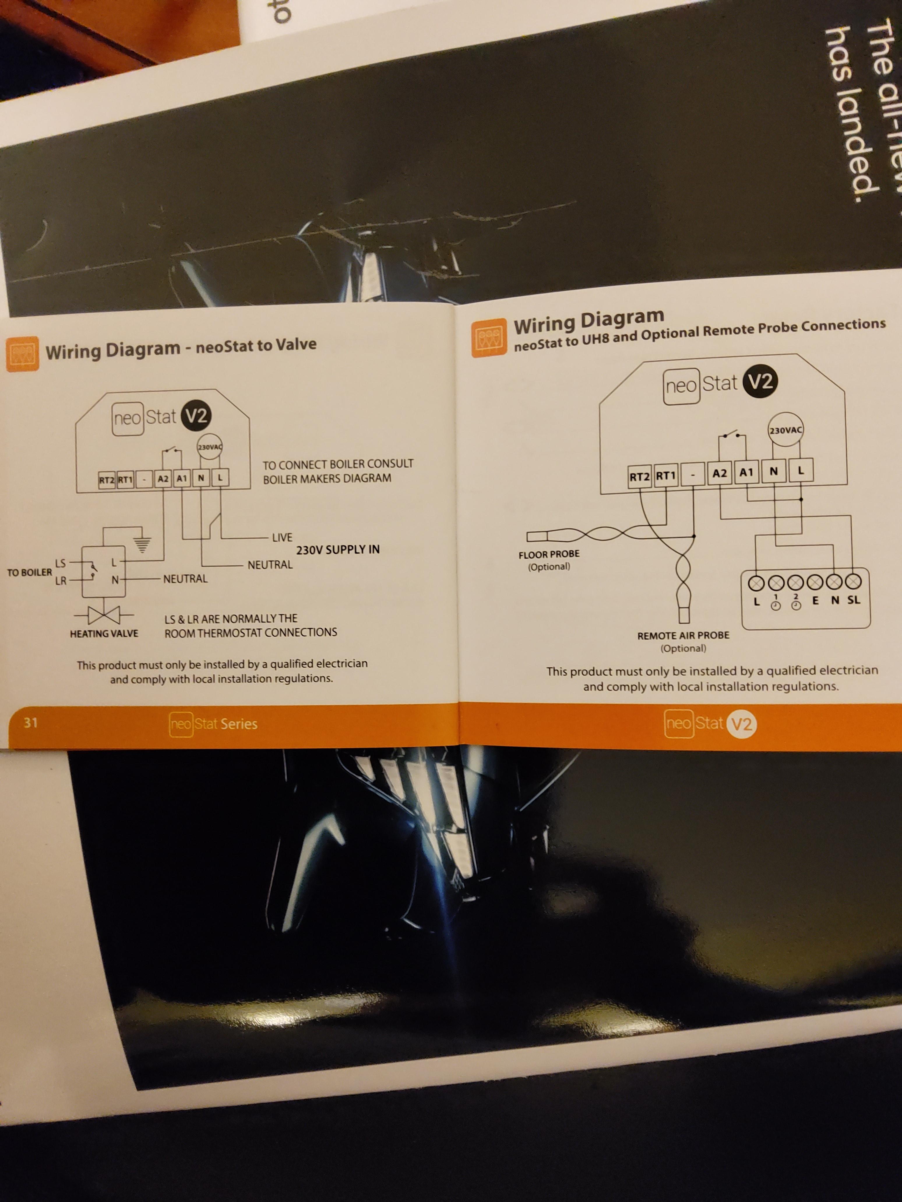

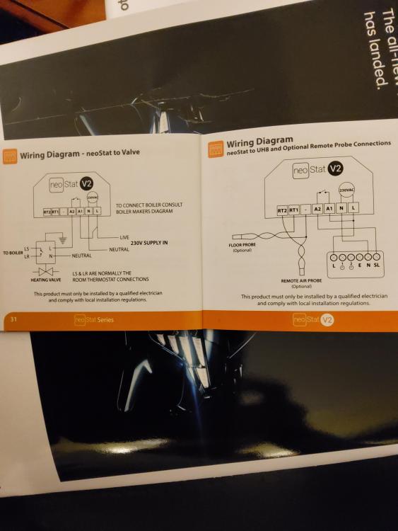

Ultima357 Posted January 21, 2021 Author Posted January 21, 2021 (edited) Wiring diagram below. This might help everyone understand how it's wired. Left hand diagram shows the wiring to Heatmiser wiring centre which operates the UHF actuators, turns on the pump and calls the ASHP into action. The 230vac circle indicates the psu for the stat faceplate. Edited January 21, 2021 by Ultima357
MJNewton Posted January 21, 2021 Posted January 21, 2021 That doesn't necessarily rule out powering it via low voltage if the volt-free relay is powered from the low voltage side of the PSU.

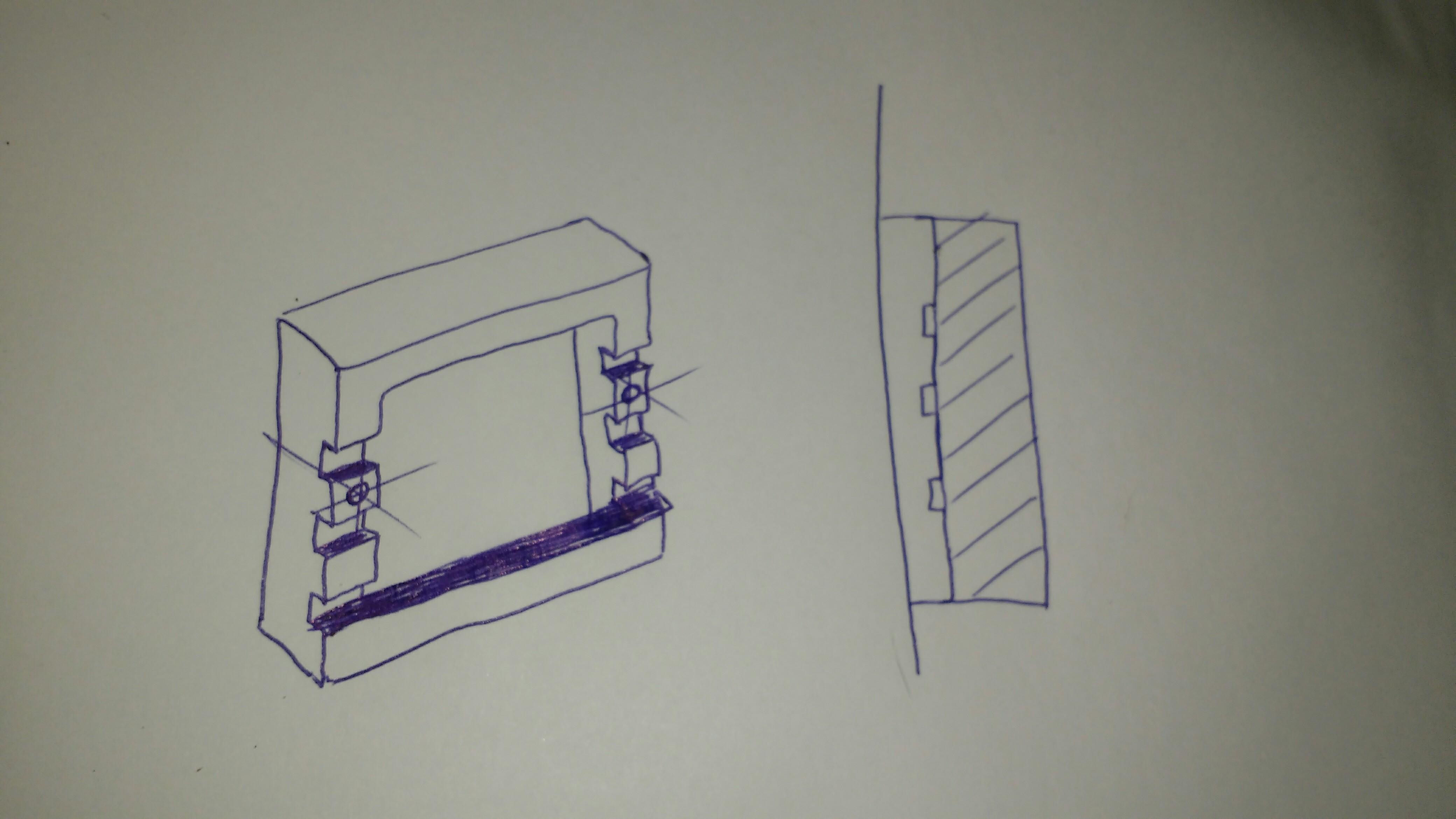

Onoff Posted January 21, 2021 Posted January 21, 2021 Fag packet sketch for a spacer, dead easy to draw / print:
PeterW Posted January 22, 2021 Posted January 22, 2021 8 hours ago, Onoff said: Fag packet sketch for a spacer, dead easy to draw / print: Isn’t that one of the things I posted and I’d do them top bottom so you get airflow ...
Onoff Posted January 22, 2021 Posted January 22, 2021 54 minutes ago, PeterW said: Isn’t that one of the things I posted and I’d do them top bottom so you get airflow ... Sorry, missed you saying/sketching that. Could even put the slots on a slight slant... top, bottom, side, wherever.
Ultima357 Posted January 22, 2021 Author Posted January 22, 2021 9 hours ago, PeterW said: How about one of these with slots cut in the top and bottom edges to allow air to flow ..? Isn’t the transformer in the back box behind that octagonal plate ..? Yep, that's a good one. You are correct, the transforrmer/psu and relay are in the back box behind the octagonal plate. You just ease the screws, rotate slightly and it all comes forward. Undoubtedly the source of the heat as I've measured the face of the octagonal bit at 29deg.
