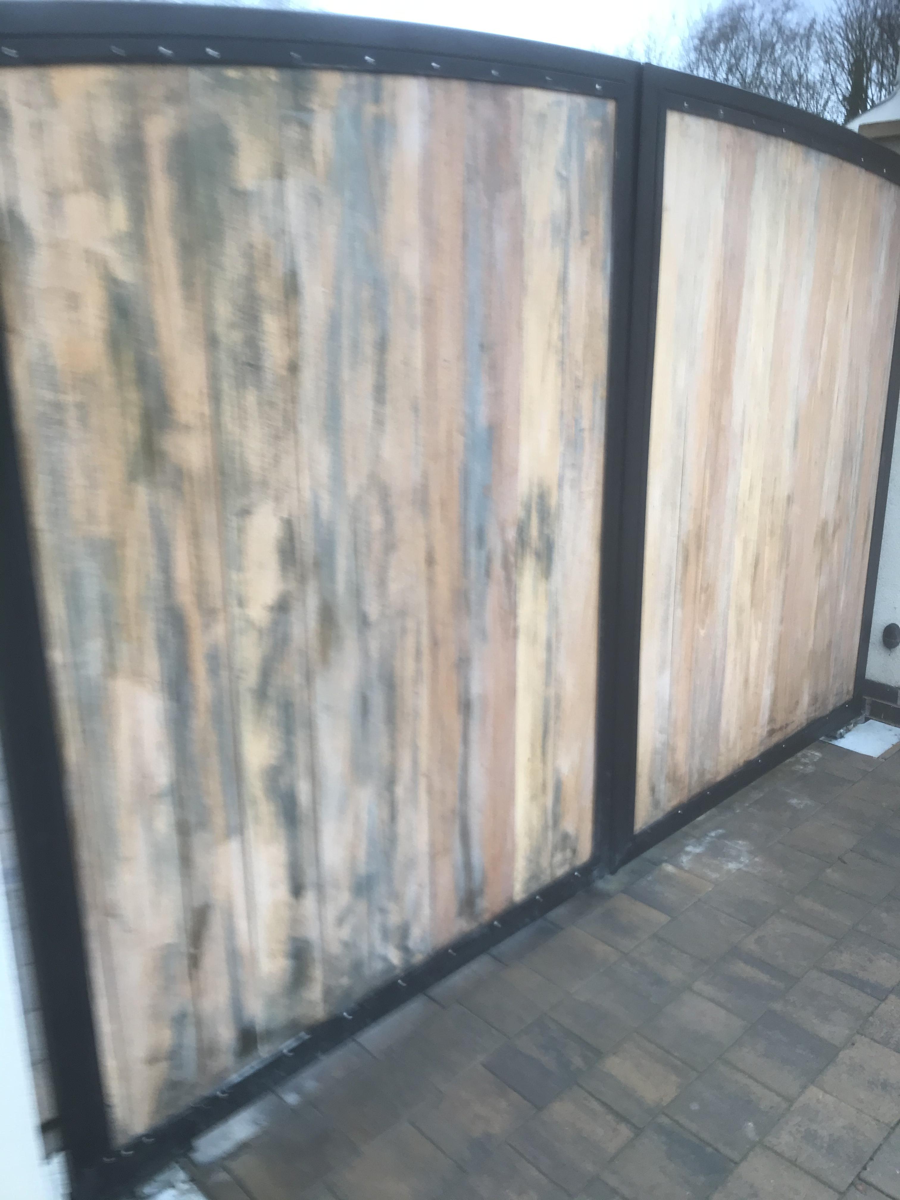

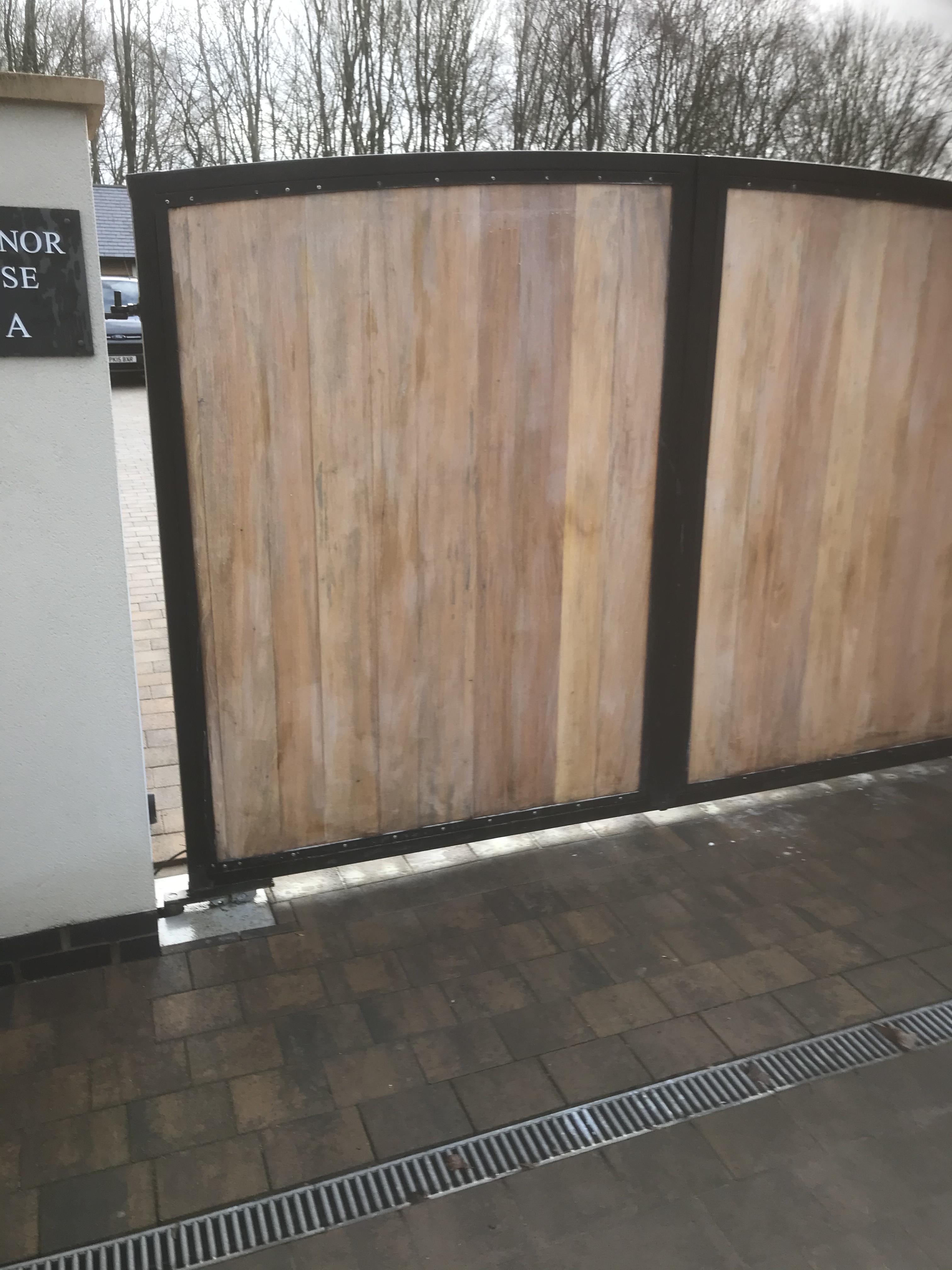

nod Posted January 16, 2021 Share Posted January 16, 2021 Quick tip for water stained hardwood Worktops etc Paint Oxalic acid on Leave for an hour Ready to wash off and re oil as pictured 3 Link to comment Share on other sites More sharing options...

nod Posted January 16, 2021 Author Share Posted January 16, 2021 Yep it’s had exactly that Two coats of Danish originally Then Osmo Nothing seems to stop the water staining Link to comment Share on other sites More sharing options...
