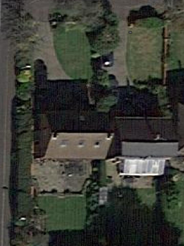

Ferdinand Posted January 13, 2021 Posted January 13, 2021 27 minutes ago, Buildmeupbuttercup said: I dont even understand what you mean but it sounds interesting, please can you elaborate? The back of my house faces North, so I get very little sun in my kitchen extension, as the sun goes E-S-W through the day.

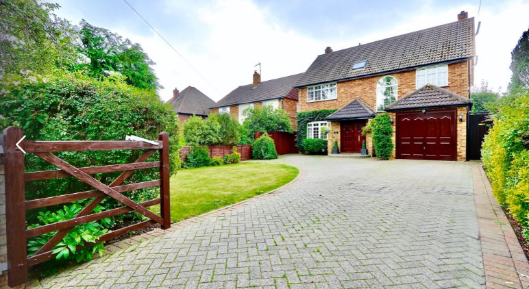

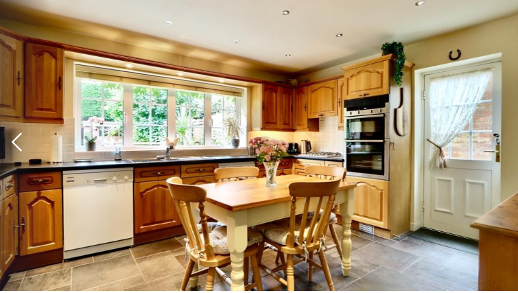

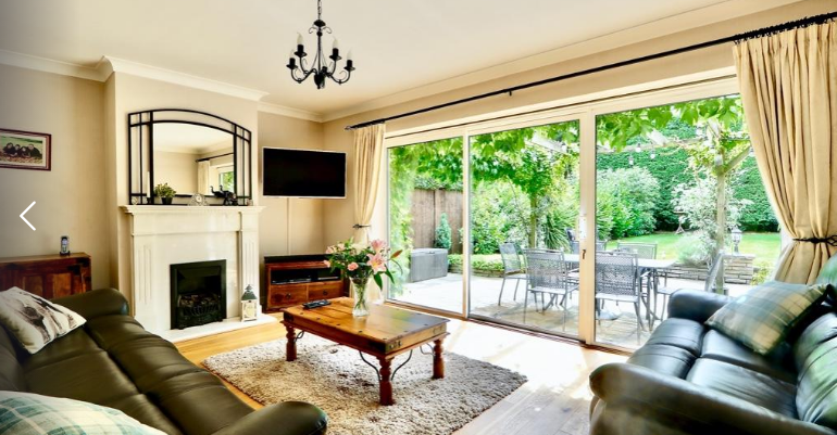

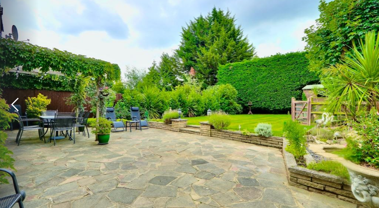

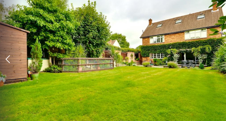

Buildmeupbuttercup Posted January 13, 2021 Author Posted January 13, 2021 The brown house. The living room currently, note fireplace Current kitchen Hope these help!
Ferdinand Posted January 13, 2021 Posted January 13, 2021 So if a usual Google image, the back gets sun through the day.

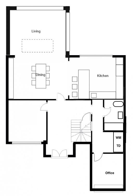

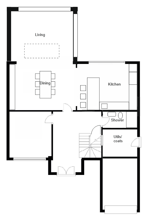

Mr Punter Posted January 13, 2021 Posted January 13, 2021 I suggest just extend the living room. Straighten the wall in the kitchen to increase the WC into a shower room. Use the under-stairs cupboard to access part of the garage as a utility / coat room. Like this: 1

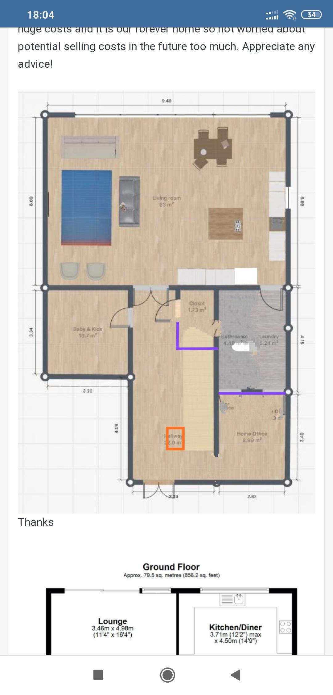

Buildmeupbuttercup Posted January 13, 2021 Author Posted January 13, 2021 On 12/01/2021 at 18:11, Declan52 said: Have the stairs turned at the bottom by a few steps which will push it back giving you enough room for a toilet and sink under the stairs. A door in the hallway to access the office. You can then make the utility room much bigger with the toilet under the stairs. The wall between the utility and office can be moved to suit which room you want to be bigger. Wow reading this again and we hadn't considered moving the stairs but might be a great option... thank you, instead of working around the stairs, move them!

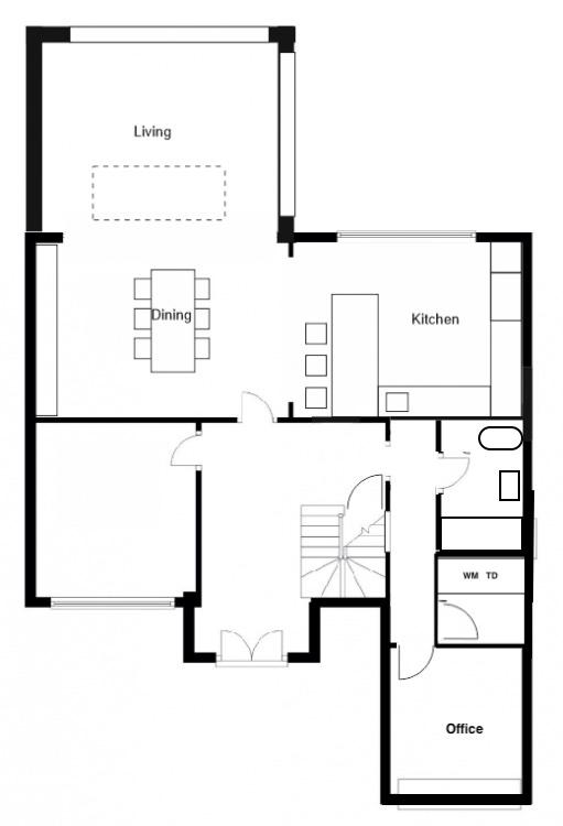

AliG Posted January 13, 2021 Posted January 13, 2021 OK, last try. 38 minutes ago, Buildmeupbuttercup said: Wow reading this again and we hadn't considered moving the stairs but might be a great option... thank you, instead of working around the stairs, move them! This is probably only possible if you are building an extension to the front. I liked what @Mr Punter posted for the rear as much cheaper and easier to build. Also it gives windows both to the south and west which are the best directions. But I thought I could do better with the garage area, so I came up with this, I don't think there is enough headroom under the stairs. The WC door becomes an arch into a new hallway. There is a shower room off this. There is then a utility area where you could put the washer and dryer into a cupboard and walk past them to the home office. Not ideal, but it is very hard to fit a utility room in downstairs without more extensive work (I would push for the upstairs laundry as this is where all the washing is anyway)
AliG Posted January 13, 2021 Posted January 13, 2021 (edited) You could have a totally separate laundry doing this but it gives you a long corridor and the laundry is only 1.25m wide. It would allow aside door if you wanted. I didn't perfectly scale the rooms but you get the idea. Edited January 13, 2021 by AliG 1

Ferdinand Posted January 14, 2021 Posted January 14, 2021 5 hours ago, AliG said: OK, last try. This is probably only possible if you are building an extension to the front. I liked what @Mr Punter posted for the rear as much cheaper and easier to build. Also it gives windows both to the south and west which are the best directions. But I thought I could do better with the garage area, so I came up with this, I don't think there is enough headroom under the stairs. The WC door becomes an arch into a new hallway. There is a shower room off this. There is then a utility area where you could put the washer and dryer into a cupboard and walk past them to the home office. Not ideal, but it is very hard to fit a utility room in downstairs without more extensive work (I would push for the upstairs laundry as this is where all the washing is anyway) If your laundry is upstairs then you need drying arrangements upstairs too. You don't really want everything to be tumbler dependent. Otherwise you are carrying the wet washing downstairs and outside every time. There are other variations we have not talked about yet. One is to do the full width extension at 3m or 4m, and have the utility room in the corner of the kitchen back to back with the improved shower room. That would also give you mops, buckets, food etc out of sight. That gives you the option of keeping the garage, or turning it into a long office, or a storage area plus an office. What I like about that is it puts your nonhabitable rooms in the area of the house with no natural light, and allows you to separate kitchen storage from workshop type storage. F 1
