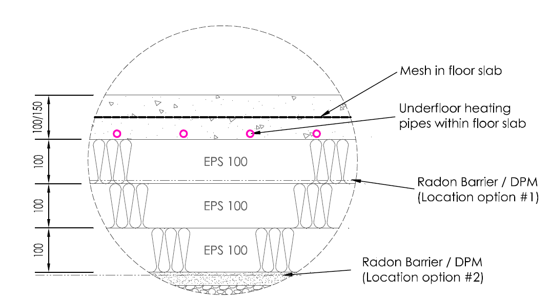

Nearly there with starting the foundations for my insulated raft foundation, just sorting out the nuts and bolts and getting prepped for installing the UFH pipework, to be supplied by Wunda.
My Pipework is to go in the slab which is 250mm ringbeam with 150mm main section. I will be installing the month, and hence it'll be cold and likely freezing temps for some time yet. I have the design now I just have a few questions if anyone can provide some input:
1) Most with insulated foundation seem to attached pipes to mesh with cable ties or similar. However Kore (foundation supplier) seems to mention that they should be installed first before mesh to keep them protected (makes sense) see image at bottom. Hence stapled into the EPS and out the way. Seems like the best plan (and a lot easier to fit not walking on mesh) probably two questions here:
        1a) Is there any good reason others fit it to the mesh? rather than then EPS?
        1b) Will it matter with pipes being that 'deep' in the slab?. Heat rises obviously, but it the only down side that the reaction time takes longer than say being on mesh at half the depth of slab? (I.e.                   150mm deep vs 75mm deep)

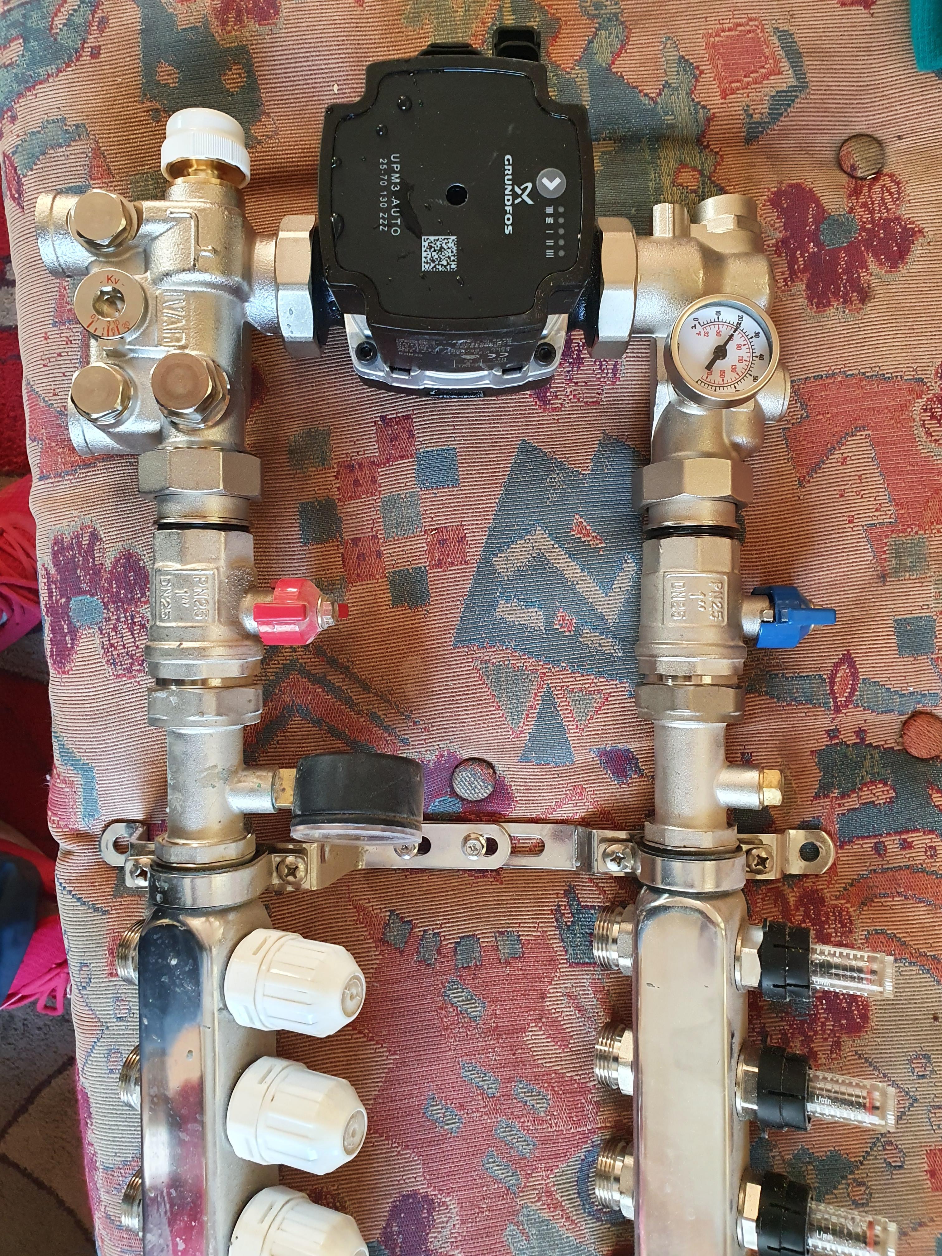

2) Should I get manifold just now or just cap ends and leave attached to wooden support. (saves manifold getting damaged?)

1. I attached mine to the top of the mesh, the thing i didn't like about it is where you have mesh laps it means your pipes are even higher and so less cover. I seem to recall thinking that putting the pipes onto the insulation first would be better.
2. I'd get the manifold.  Position it where it will go, but higher so you have excess pupe allowing you to adjust once house is up. Better to have too much pipe. Also allows you to pressure test. I just wrapped some foam around mine during the pour.

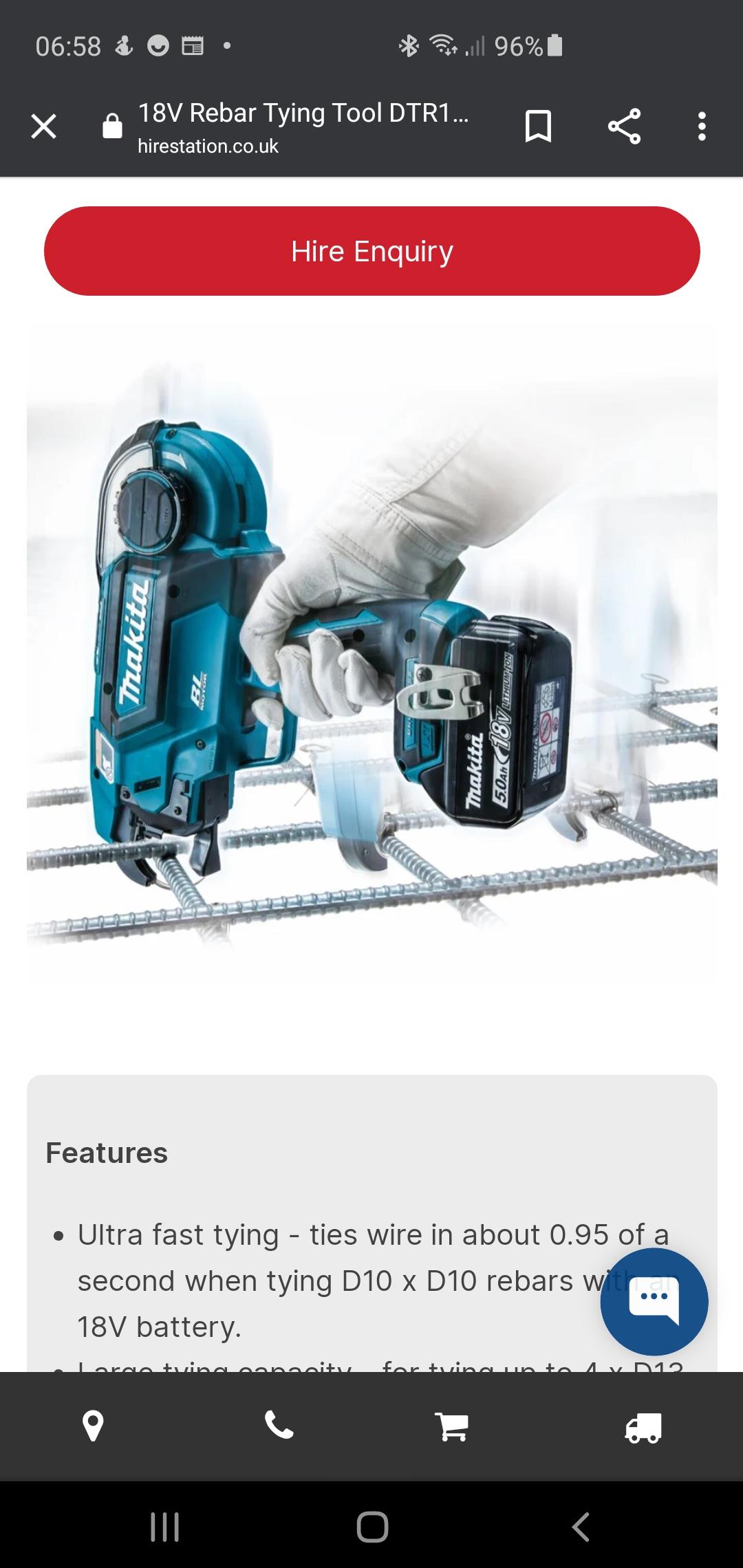

7. I used cable ties to mesh. PITA as you get through thousands so takes a while and then have to snip ends off. Dont do it. Stapling to EPS get a stapler in for in, if tying to mesh use the same twist wires as you use to tie mesh.
Hire a wire tie gun when doing the mesh, and then you can use it to tie the pipes too.
Don't tie mesh together by hand, I did, its not hard just bloody slow.
You can get a gun that does it for you, try and hire one of those.

1a Certainly easier if you csn staple to the EPS. I cable tied to the top of the mesh. Are you putting a thin layer of DPC to stop any concrete seepage between the EPS joins?
1b No I don't think it matters at all. Over time, the slab will be heated to a uniform temp regardless of the position of the pipes. I imagine some vertical variation in slab temp will occur when cooling down. It could be advantageous to have the pipes lower down, Im not sure.
Thanks. I just hadn't figured out the IVAR manifold yet or the Wunda one. (IVAR website seems a pain and too many options)
I have the wunda manifold and my ivar pumpset arrived about 15mins ago. I assume that the two will go together, may involve the purchase of some additional couplers. I intend to look at it this week at some point.

The insulation will fill with water regardless of if it has a dpc or not. If you don't need to put a dpc in then don't, corners are a pita, leave it underneath.
Ah, I'd assumed it was an IVAR manifold with pump/blending set - this would make it less of a decision just now for me. @Nickfromwales any insight here you can provide please? Do you buy a full IVAR manifold and pump/ blending set or Wunda manifold with IVAR blending set?
The corners is exactly what I wanted to avoid - as I'd seen you other posts! Stuff it  - DPM underneath only, all about making life easy.

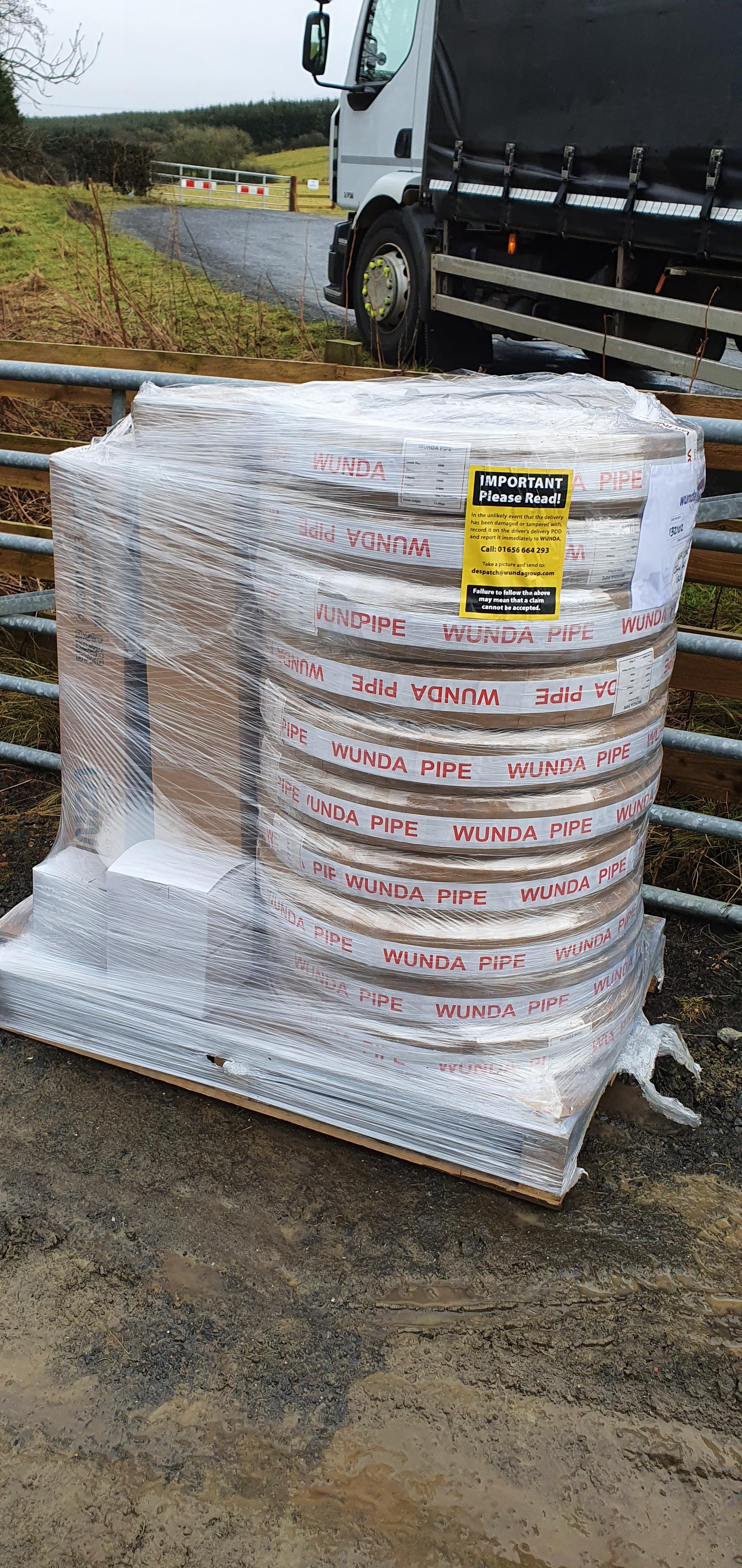

Iirc, the UFH pipes from Wunda come Pre-pressurised with air / gas and the ends plugged sealed and factory tight  judging by one I cut ( without knowing they’d started doing this, so subsequently nearly ? myself ), it’s at quite high pressure too. You’d 100% know you’d damaged it, but would the person who’s damaged it tell you? Also, a tiny puncture may not be notable so maybe not the immaculate solution.
A pressure gauge is the only true way of knowing that the integrity has not been compromised. Water is not necessary, but it’s 500 times quicker to find a leak with water squirting out vs using leak detecting fluid with air.
@Nickfromwales they are (i received them the other day.)  And I was thinking the same...also in reality I'm the only one laying them. So I might fit them all. Then leave them capped and fit the manifold once all laid so hopefully o should be able to tell them are all OK.  I also bought the pressure gauge so will likely pressurise to check prior to concrete pour.
