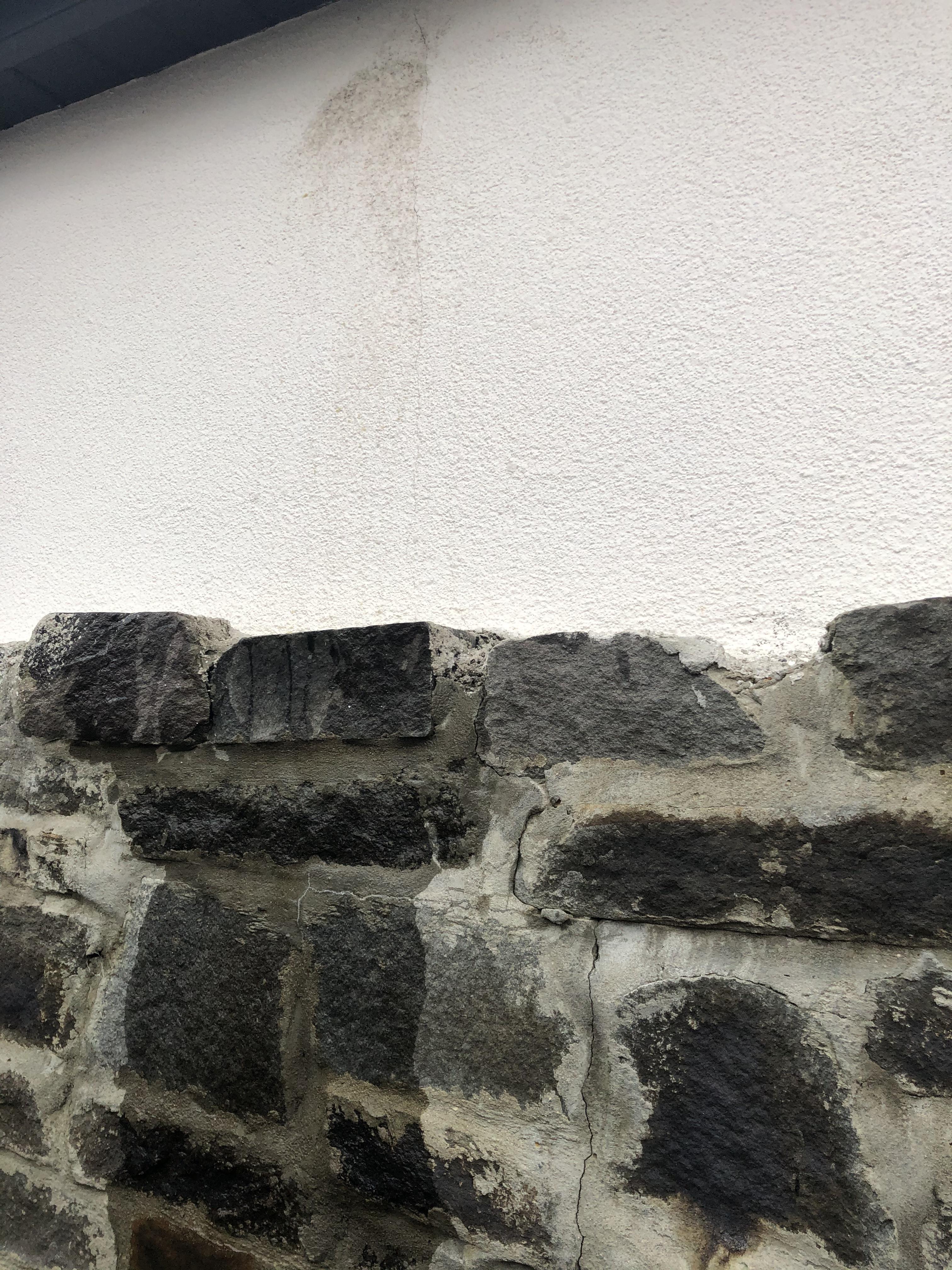

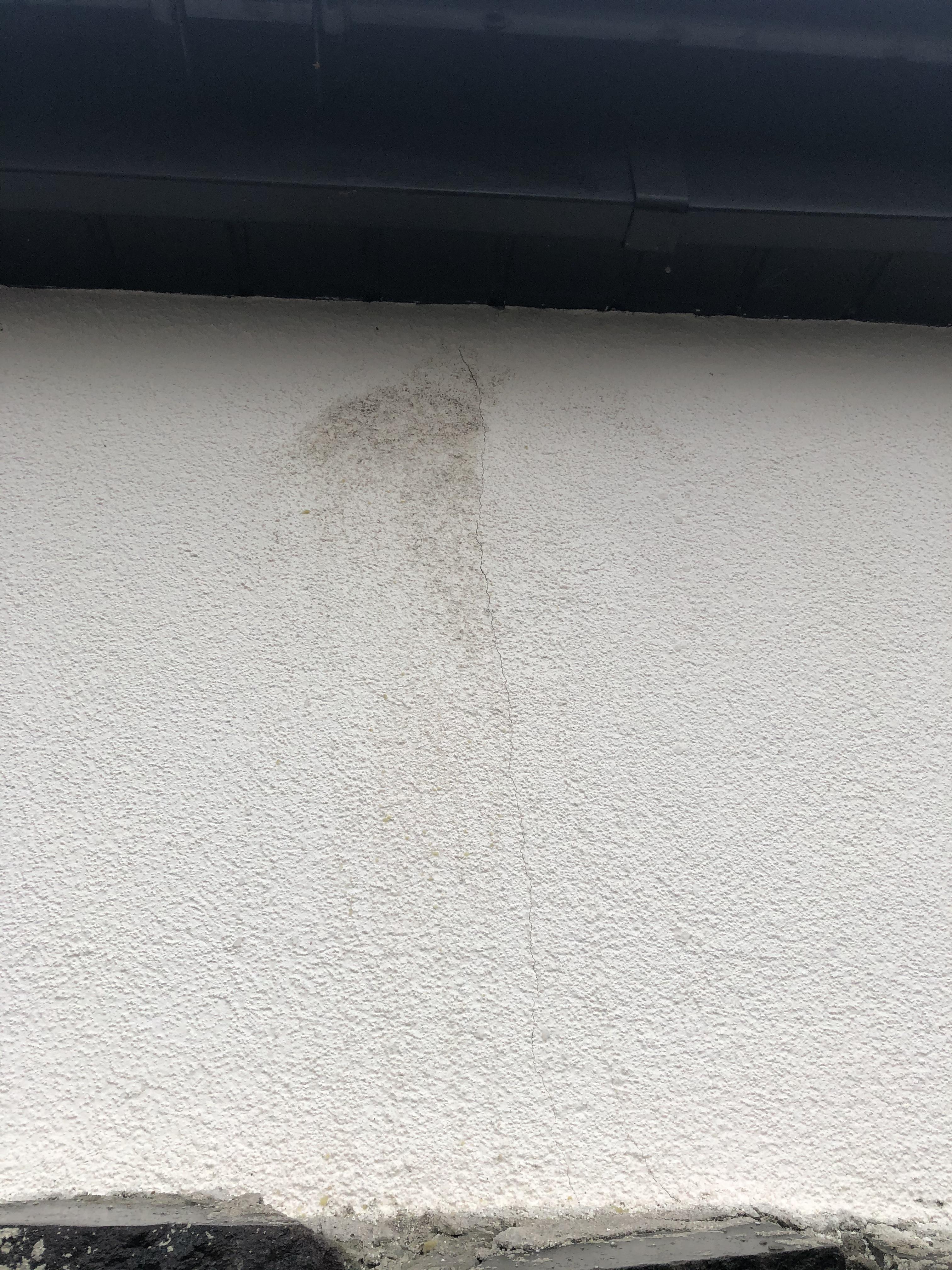

Noticed a crack in the k rend .

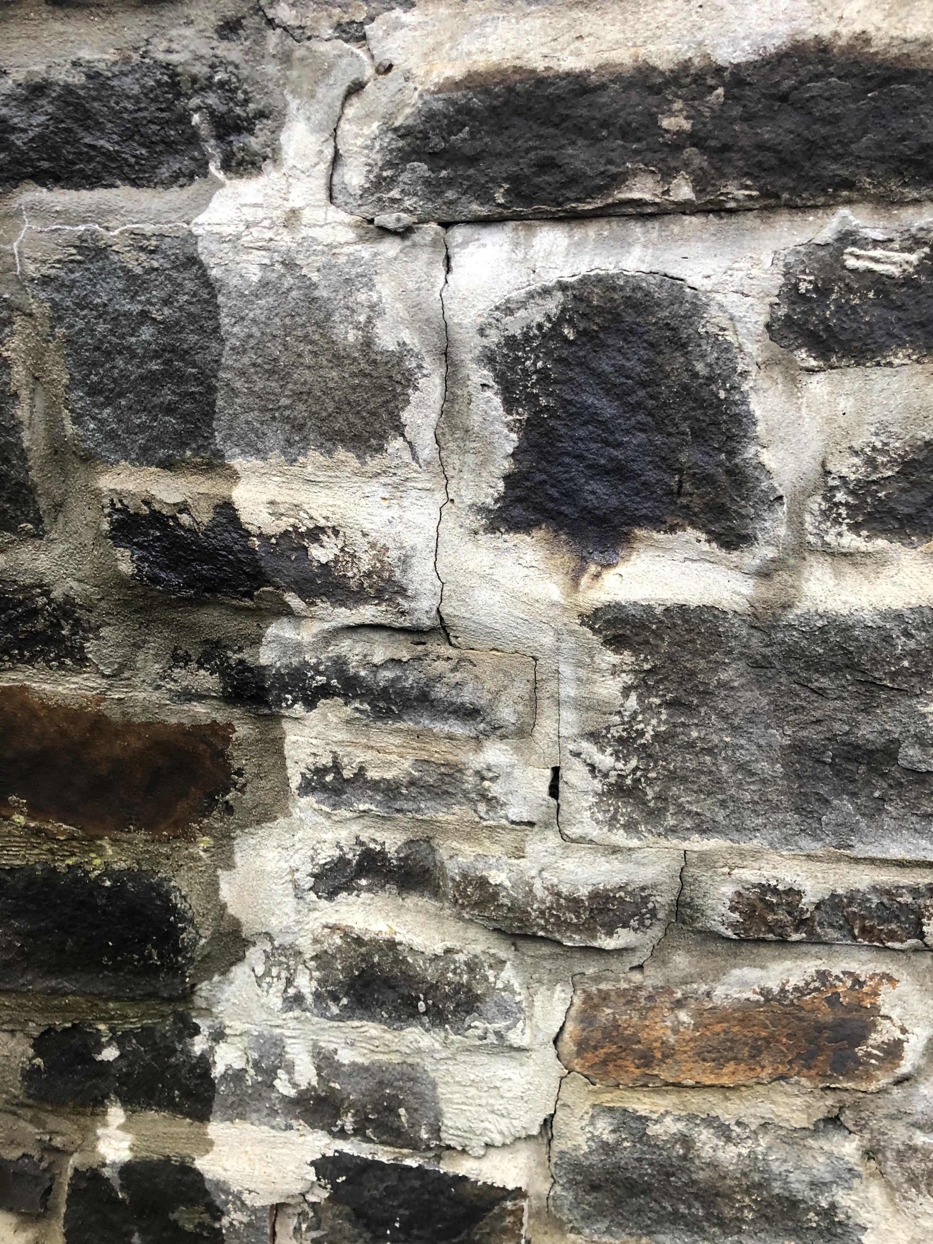

The crack continues down the cement of the stone wall . Presumably an expansion gap should of been put in . What’s a fix for render and wall ? . Just ct1 over it to stop water getting in ?? Not critical - but dont want it getting worse .

How long is the wall and do you have an expansion joint, as the can be hidden with downpipes if planned a bit

The stone wall is about 15 metres long - there are no expansion joints - I know this because I built it ?
I would have one at 5m intervals
I have a 10m wall with one in the middle with the expansion joint filled with a mastic to match my render.
4 minutes ago, AliG said:
TBF that probably needs an expansion joint
Sure . Where the cement has cracked can I  get that out and refill with something ? Or must an expansion joint be a vertical strip ?
Normally they are made with a plastic strip, but I don't see why you can't cut the render out and put in a line of mastic.
The problem you have is that the crack is not vertical, so you will need to fix some of it also.

What about on the k rend ? . Can that have a vertical cut inserted and then expansion joint inserted ?
The reason for the render beads as shown is to get a neat and strong edge. But as the K-Rend is already on the wall you cannot get a bead behind it, so will just need to cut a groove into it and fill with mastic. Without the bead the edges will be prone to chipping but I wouldn't worry about it over such a short distance.
Am I right in thinking this is the side wall by the footpath? If so it’s not in your front elevation so not “in your face”. That wall has subsided a bit and may move a bit more yet so I would just cut into the cracks with an angle grinder and put in a bead of mastic, this will allow it to move and stop any water getting in.

Yeah - on the side
