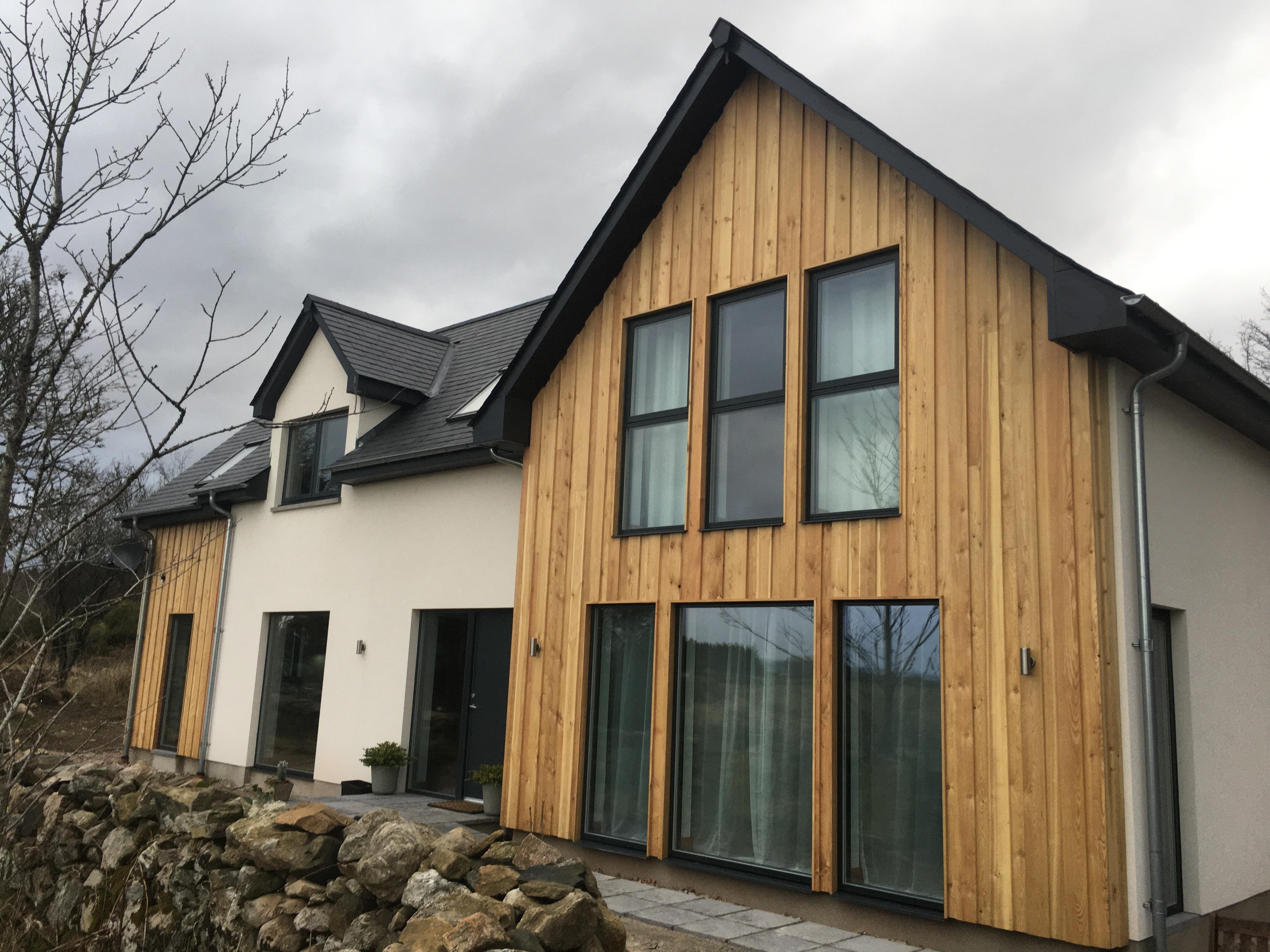

ProDave Posted April 2, 2021 Share Posted April 2, 2021 Our "wall" height upstairs is only about 1.2 metres. But by building with "gable ends" rather than dormers, and using a cut roof hung from a ridge beam, so no unwanted internal timber structure, we get almost full standing room in all rooms. Link to comment Share on other sites More sharing options...
stubiff Posted April 2, 2021 Share Posted April 2, 2021 Suppose the downside is that the roof windows would be too high for a view! (if wall is 1.8m) Link to comment Share on other sites More sharing options...
stubiff Posted April 2, 2021 Share Posted April 2, 2021 2 minutes ago, ProDave said: Our "wall" height upstairs is only about 1.2 metres. But by building with "gable ends" rather than dormers, and using a cut roof hung from a ridge beam, so no unwanted internal timber structure, we get almost full standing room in all rooms. Does that turn it into a 1.75, if you have vertical windows in those gable ends? Link to comment Share on other sites More sharing options...
ProDave Posted April 2, 2021 Share Posted April 2, 2021 Just now, stubiff said: Does that turn it into a 1.75, if you have vertical windows in those gable ends? I don't care what label anyone wants to put on it. All I cared about was the planning was granted and it fitted in with all the other houses in the road. If you wan't to call it 1.75 I will not argue. You don't see this "gable end" style much here, i first noticed it on a trip to Skye and thought it made a lot of sense. Link to comment Share on other sites More sharing options...
stubiff Posted April 2, 2021 Share Posted April 2, 2021 Sorry, was meaning it more in relation to the planning, as you see quite a lot that say it has to be 1.5. Wondered if they said 1.5 on yours and then were happy with your plans. Link to comment Share on other sites More sharing options...
ProDave Posted April 2, 2021 Share Posted April 2, 2021 I think the general planning policy here is 1.5 or 1.75 so it would not have mattered. Link to comment Share on other sites More sharing options...
