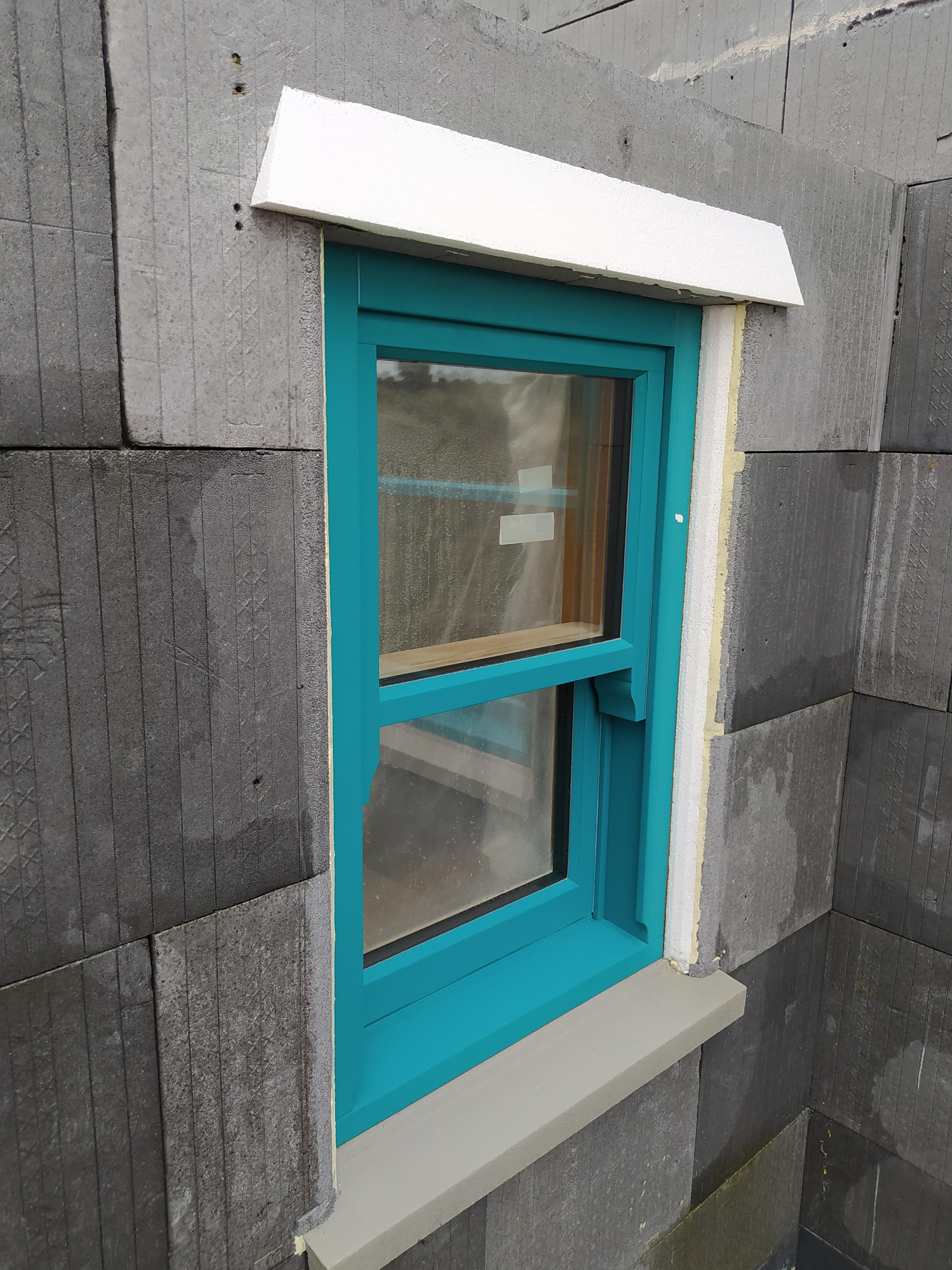

willbish Posted December 31, 2020 Share Posted December 31, 2020 33 minutes ago, NickK said: Hi and all the best in 2021 (although I said the same last year and look how it turned out). Does anyone have any experience with performance of sash windows at all? I was doing some reading about Georgian style house, which tick quite a lot of boxes for me. Easy shapes to build, symmetricity, simple roof, etc. However, I do wonder about sash windows. You can get some with very good U values but if they are not airtight, isn't it a false economy? Any real live experience or solutions? I have seen Mock Sash Windows but not really sold on them. I am not building anything right now, just gathering knowledge :-). Thanks, Hi Nick, This year i've installed Green Building Store timber sash windows on my new build, which I think look loads better than a lot of the 'mock' sash windows on the market. They score a class 3 on air tightness (out of max 4), this is with both top and bottom sash openers. I specified many of my windows as fixed, non opening and some with only one sash sliding. I am hoping that, having installed them correctly, I will still be able to achieve a very good air tightness score. Link to comment Share on other sites More sharing options...

NickK Posted January 4, 2021 Author Share Posted January 4, 2021 6 hours ago, willbish said: @NickK Apologies if I want clear. I haven't installed the mock sash but the sliding sash. I love the colour. Really stands out. What are walls going to be? Link to comment Share on other sites More sharing options...
willbish Posted January 5, 2021 Share Posted January 5, 2021 @NickK Walls will be rendered, in a TS06 from the Fassa range https://www.fassabortolo.it/it/365-a-year-of-colors?line=Tuscany Link to comment Share on other sites More sharing options...

willbish Posted January 12, 2021 Share Posted January 12, 2021 7 hours ago, NickK said: @willbish just out of interest, how much did your windows set you back? If you don’t mind me asking. The porch window pictured above, as an example, was £785 Link to comment Share on other sites More sharing options...
