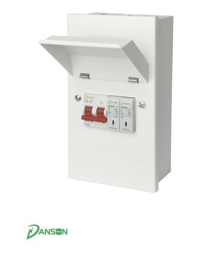

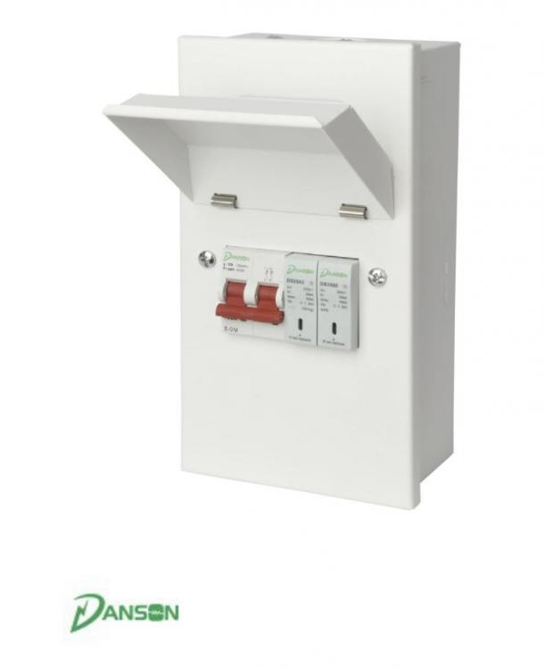

PeterW Posted December 31, 2020 Share Posted December 31, 2020 5 minutes ago, Russell griffiths said: Any idea what is added at the CU to do this. module that looks a bit like an RCD with no switch in it ..! Considering retrofitting one of these https://www.electricaldirect.co.uk/product/danson-100a-main-switch-4-modules-metal-consumer-unit-with-spd-type-2-750647 Link to comment Share on other sites More sharing options...
