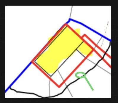

LSB Posted December 29, 2020 Author Posted December 29, 2020 (edited) ok, the first picture is an extremely rough layout to show where the waste need to go to the tank. the barn is 25m x 16m and then another 30m ish to the tank. waste path.pdf then the site layout from the road 3 - Block and Site Location Plan.PDF the slope from the road to the barn is approx 120m long with a rise of about 4-5m. we are planning on putting the tank about 30m down the hill so an approx drop of 1m. sorry first printout only shows building. Edited December 29, 2020 by LSB change

PeterW Posted December 29, 2020 Posted December 29, 2020 By 30m down the bull do you mean down your drive ..?? Or in the blue square ..??
LSB Posted December 29, 2020 Author Posted December 29, 2020 3 minutes ago, ProDave said: But where is it going to drain to FROM the tank? Land soakaway? Watercourse? Are you assuming the tanker must remain on the road so you need to be within 30M of the road? Or will your track be capable of taking the weight ans size of the tanker? tanker can come up the drive, we will have a huge soakaway and then the final soak will be into our field, as happens now, it mustn't go to a watercourse. the original location was the opposite end of the barn which only have 4WD or tractor vehicle access. the barn is at the top of the slopes and it goes down all around. we own all the fields in the site plan and also some others. our house at the bottom goes to 4 tanks over the road and then into one of our fields.
LSB Posted December 29, 2020 Author Posted December 29, 2020 6 minutes ago, PeterW said: By 30m down the bull do you mean down your drive ..?? Or in the blue square ..?? within the blue square, planning to place just above the the label saying track.
ProDave Posted December 29, 2020 Posted December 29, 2020 So if you own all the field outlined in blue, and the tanker can use your track, then just down the slope a bit from the barn anywhere, as long as the tank is within 30M of the track. So you have lots of options, the higher up the slope the better as that gives you more options for the soakaway I see no need for the pipe to pass under your track at all.

PeterW Posted December 29, 2020 Posted December 29, 2020 Ok so how much of the “square” is the barn and how much is the garden ..? As in, how much outside have you got in front of the barn..? The tank can go on your land, the council cannot stop you putting a drainage field under agricultural land, it happens all the time, is not visible and does not amount to works requring planning permission.
LSB Posted December 29, 2020 Author Posted December 29, 2020 5 minutes ago, PeterW said: Ok so how much of the “square” is the barn and how much is the garden ..? As in, how much outside have you got in front of the barn..? The tank can go on your land, the council cannot stop you putting a drainage field under agricultural land, it happens all the time, is not visible and does not amount to works requring planning permission. So, the badly coloured yellow is the barn, the black is the garden. The rest of the red bit is slightly odd as adding that in would make an area of 375m2, so not for conversion. I guess the LPA can only do regular shapes ! The blue is the edge of our land, so one side of the barn is right on the perimeter, we have about 6' and we are not building right to the end as the existing wall on that side is 1m from the edge. That is the side where all the bathrooms and some of the bedrooms are because it is a steep bank into the next field, which is about 2m higher at that point, so not a lot of light and no view. The LPA has not told us where to have the garden, that is up to us, only what the maximum size is, but we need to be aware in the future of what land we will keep and what we will sell. Anything outside of the curtilage will stay as ag land so should not be used as garden. The view is from the L side of the barn.
ProDave Posted December 29, 2020 Posted December 29, 2020 There is still nothing stopping you having the tank under agricultural land, and if that ever gets sold separately it would be sold with a wayleave to allow access to maintain, repair or replace the tank. 1
PeterW Posted December 29, 2020 Posted December 29, 2020 I’d put the rank where the green circle is, leach field under the field with an easement written up for replacement in the future, or do a linear field. 1
