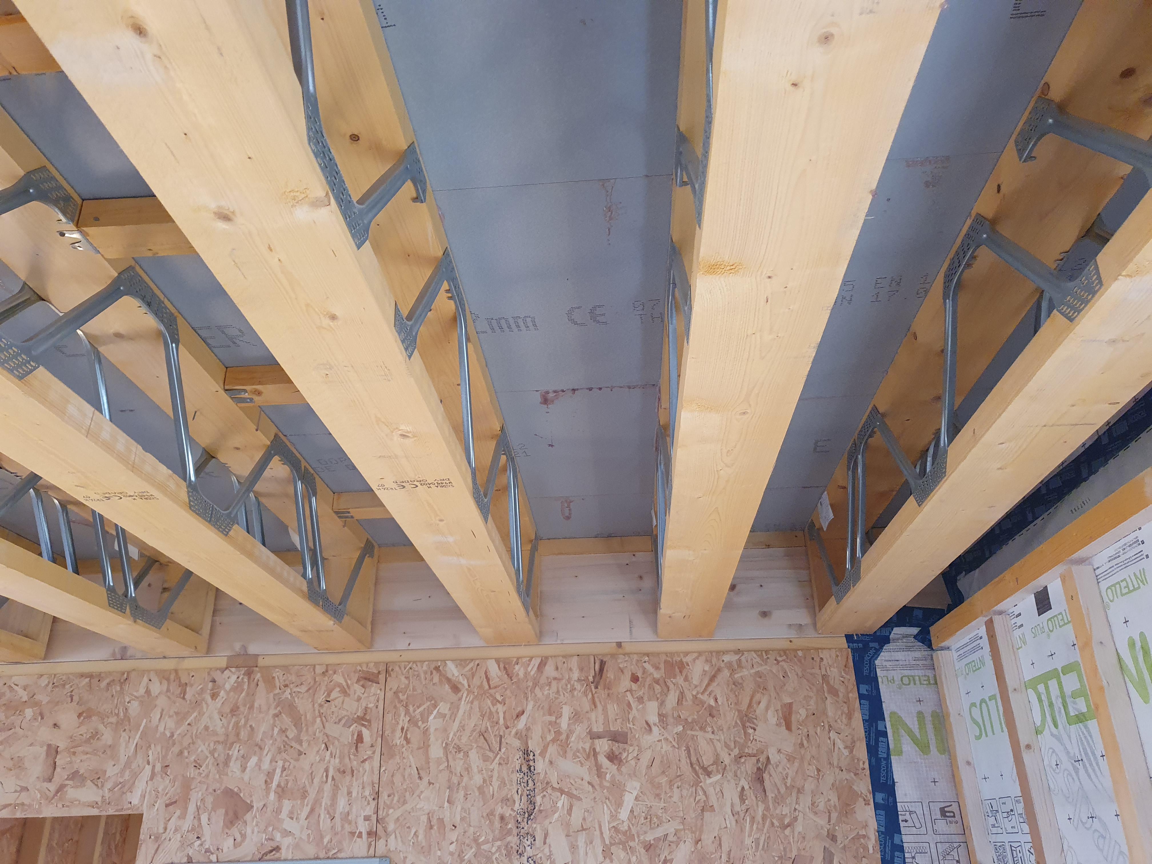

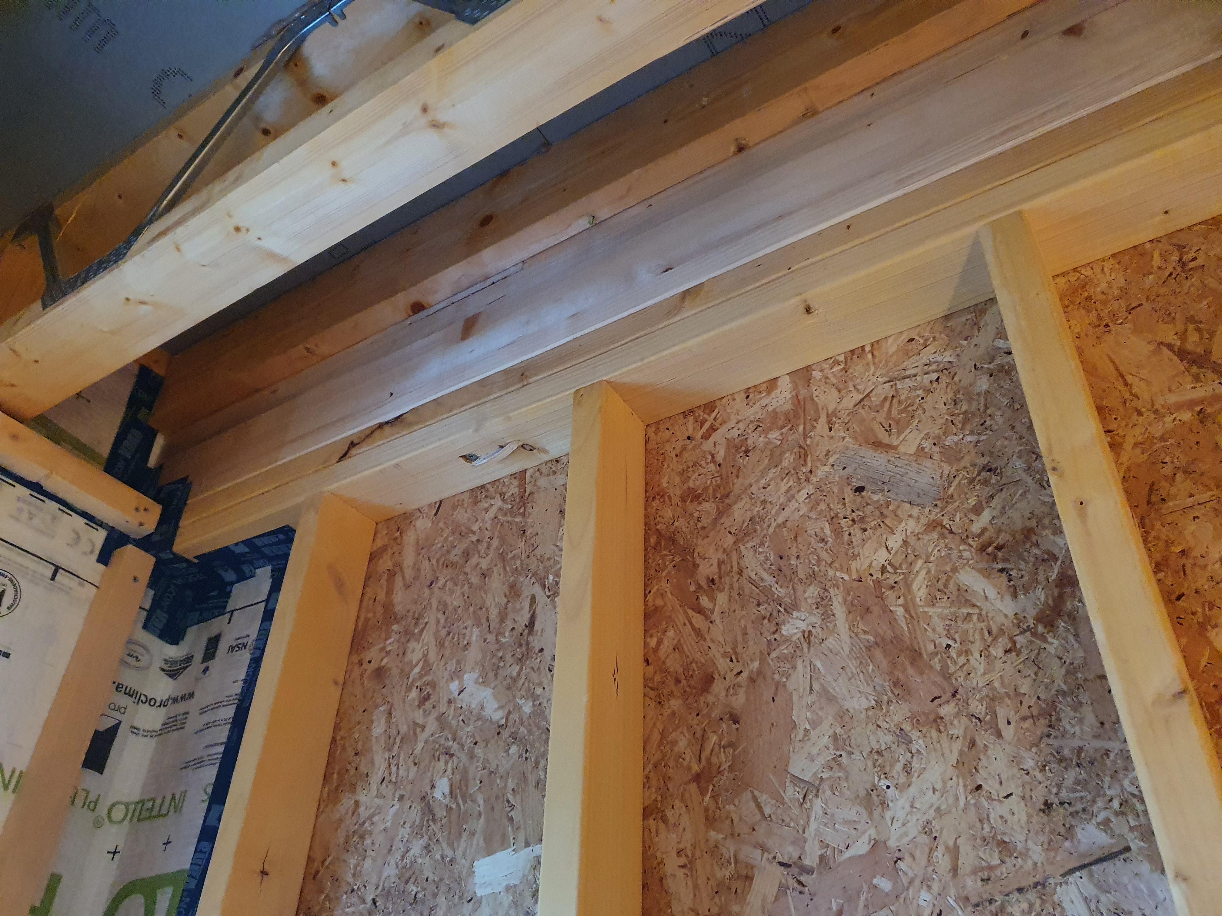

LA3222 Posted December 28, 2020 Posted December 28, 2020 The wall running along my kitchen is load bearing and takes the weight of a wall directly above. The wall above carries three point loads, the ridge beam and purlins supporting the roof and transmits this load down through to the foundations. Ground & 1st floor it is 89mm C16 construction. Ground floor has 9mm OSB racking. The studs for the ground floor are 2.5m high. To fill the void between the top of the studs and the underside of the first floor deck solid 89mm timber (glulam) has been used (approx 350mm deep). Now to my question. Can I put a 110mm dia hole through that solid timber to run a soil pipe through? It would be right next to where the stud wall 'T's into the external wall. No door openings below it so the timber isn't acting like a beam there. No point loads from purlins directly over it. To my mind that timber is just a space filler for the most part except over the two doorways where I expect it acts as a structural beam so I'm leaning towards it not being an issue. Thoughts from my fellow self builders would be appreciated. Attached are pics of the offending article from both sides.
ProDave Posted December 28, 2020 Posted December 28, 2020 I would say yes. In a similar situation in my own build, I don't have the solid glulam there, just isolated pieces of it directly under point loads like the supports to the ridge beam. You are probably going to want to drill that a lot more for cables, pipes and MVHR ducts.
PeterW Posted December 28, 2020 Posted December 28, 2020 Ask your engineer. That is a big hole to be drilling in a beam with no support. I would as a minimum be putting 6mm plates either side with a 120mm hole bored through them.
Nickfromwales Posted December 28, 2020 Posted December 28, 2020 If you removed a section 120mm wide, you’d have no issue whatsoever. It’s a load well distributed / managed over the whole width of the wall vs any specific point loading. If you can drill a circular hole at 120mm diameter then that would leave meat above and below and he more than acceptable. If it was a glulam this would be totally different.
SuperJohnG Posted December 28, 2020 Posted December 28, 2020 On 28/12/2020 at 22:28, Nickfromwales said: If it was a glulam this would be totally different Expand On 28/12/2020 at 21:31, LA3222 said: To fill the void between the top of the studs and the underside of the first floor deck solid 89mm timber (glulam) has been used (approx 350mm deep). Expand Dunno if that's been missed? In my view. The glulam is there to support whats above. Where is the glulam supported?. You can see there is a direction change of the floor joists so.its a key interface. That glulam.is in bending doing all the work. You could not remove a section in between the floor joists as you remove the ability of the beam to support the UDL. I dont know much about Glulams, but if it was steel beam and JJI you can get a hole schedule for it. But dunno how that works with beams glued together. Disclaimer: I've been drinking so I feel I have read everything above but could have misread your post above 1

ProDave Posted December 29, 2020 Posted December 29, 2020 I agree with the others above that you should consult the engineer that designed it. Several things seem odd to me about that construction. The Glulam is not acting as a beam in the conventional way with a support at each end and a load in the middle. It appears to be in compression (vertically) supporting the load above down onto the load bearing wall, and that bit of it to me suggests you could cut a dirty great hole in it without anything falling down. I would want to know why it was done like that. In a similar situation I usually (and in our own house) just see the joist ends extending onto the top of the wall, not being hung from a glulam like this. It seems to make the construction more complicated. I would want to know why. As i said before you are going to want a lot more than just one soil pipe through there. The other thing that strikes me as odd is the supporting wall is made of 89mm studs. That seems very small. I wonder if this glulam beam is what enables the load bearing wall to be so thin and that is it's main purpose? Was there a reason for this wall to be made so thin? (our two internal load bearing walls are 150mm)
Nickfromwales Posted December 29, 2020 Posted December 29, 2020 On 29/12/2020 at 09:44, ProDave said: Was there a reason for this wall to be made so thin? (our two internal load bearing walls are 150mm) Expand Once racked with OSB, a 98mm stud wall, with double header and footer, becomes incredibly strong. I’ve only ever seen 150mm used on walls which are excessively high eg divider between two rooms that share the same vaulted ceiling each side. The glulam is used here for plug n play construction IMO as two bits of C24 would likely need to be packed and trained into position due to natural timbers instability. Glulam beams are inherently flat, straight and uniform, when pre-cut and sent as part of a TF kit. They’re usually oversized in length and trimmed during installation in this type of instance.
ProDave Posted December 29, 2020 Posted December 29, 2020 On 29/12/2020 at 09:51, Nickfromwales said: Once racked with OSB, a 98mm stud wall, with double header and footer, becomes incredibly strong. I’ve only ever seen 150mm used on walls which are excessively high eg divider between two rooms that share the same vaulted ceiling each side. The glulam is used here for plug n play construction IMO as two bits of C24 would likely need to be packed and trained into position due to natural timbers instability. Glulam beams are inherently flat, straight and uniform, when pre-cut and sent as part of a TF kit. They’re usually oversized in length and trimmed during installation in this type of instance. Expand But my point is why do it this way? In our house, and many others I have worked on, the posi joists span onto the top of the wall. Whatever is above sits on the top of the posis joists. Only in a few select places is a short length of glulam inserted to fill the space between joists, for instance where the cripple studs supporting the ridge beam land. The construction in the OP is elegand and simple but makes it a bugger for services so somebody at the design stage must have thought about that and have an answer. Ours probably has 150mm studs due to the height of the upper section all the way up to the ridge beam.
Mr Punter Posted December 29, 2020 Posted December 29, 2020 Yes, you can drill your hole. To play safe, install a couple of vertical 38 x 89 studs in the wall under and ask the TF engineer to confirm this is acceptable. Be careful when you drill as the drill can jam without warning. Incidentally, with the two horizontal 89mm timbers, one is the top part of the timber framed panel and the other is a top plate to join all the panels together. They are not really regarded as structural beams. It is this large build up of horizontal timber that causes shrinkage in timber framed buildings, but it is the standard way of doing things.

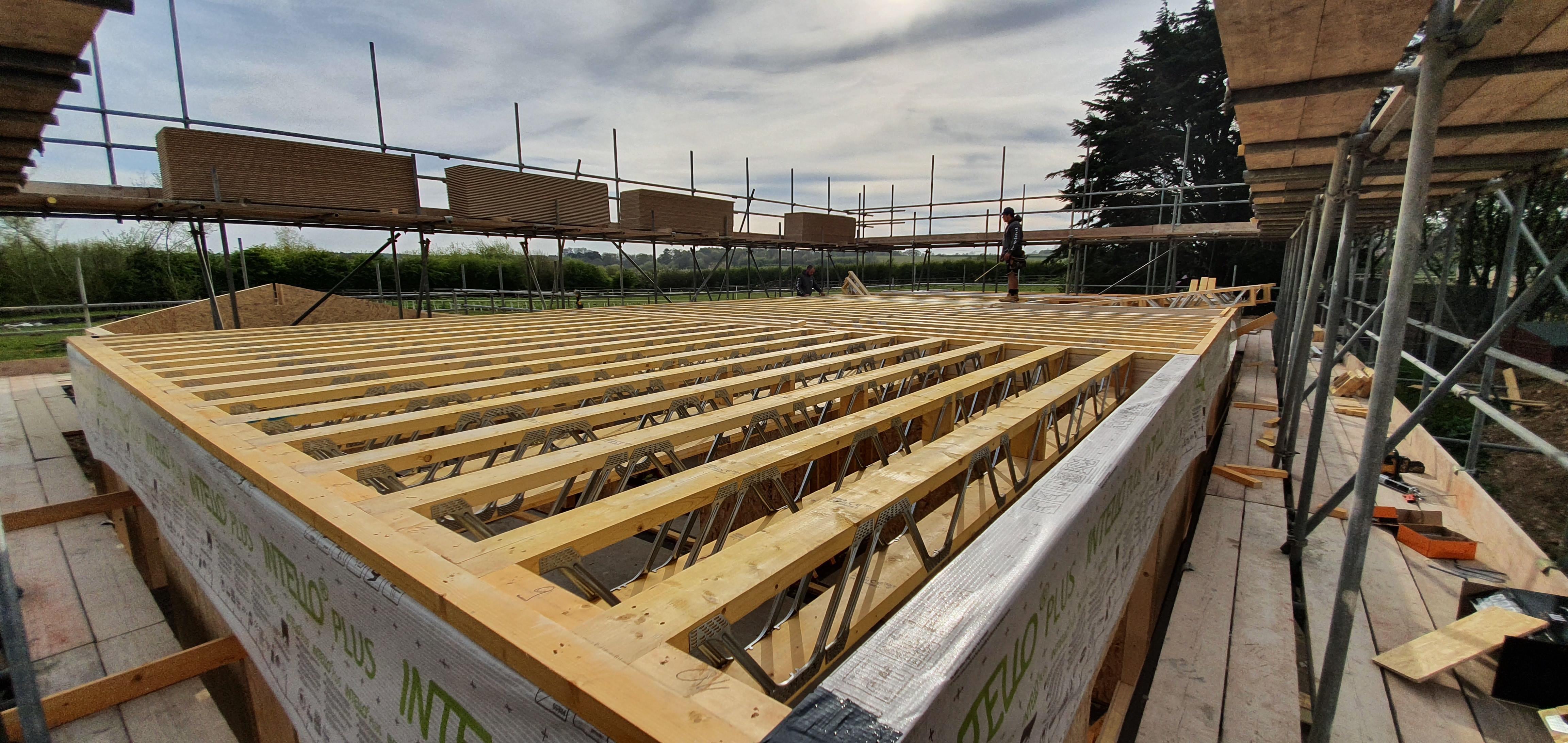

Nickfromwales Posted December 29, 2020 Posted December 29, 2020 (edited) On 29/12/2020 at 09:58, ProDave said: But my point is why do it this way? Expand Because the pozi joists don’t ( can’t ) take the load They stop and start at the beam on purpose as they have no compressive / load bearing qualities at the tail ends. The above loads need to be transferred directly to the load bearing stud wall, and that can happen if the header is a broken mix of overlapped joust rails and noggin in-fills. Edited December 29, 2020 by Nickfromwales

ProDave Posted December 29, 2020 Posted December 29, 2020 On 29/12/2020 at 17:11, Nickfromwales said: Because the pozi joists don’t take the load They stop and start at the beam on purpose as they have no compressive / load bearing qualities at the tail ends. The above listings need to be transferred directly to the load bearing stud wall, and that can happen if the header is a broken mix of overlapped joust rails and noggin in-fills. Expand There are multiple ways of designing a structure to do the same thing. Our posi joists are made with a solid timber section between the top and bottom chords at the end to they do sit on top of the wall and do take a compressive load on the end. but I think we have established in this instance the glulam is in compression, not being used as a beam as such, so subject to confirming with the engineer just for comfort there should be no issue drilling it.
Nickfromwales Posted December 29, 2020 Posted December 29, 2020 On 29/12/2020 at 17:14, ProDave said: Our posi joists are made with a solid timber section between the top and bottom chords at the end to they do sit on top of the wall and do take a compressive load on the end. Expand Yes, but that’s only permissible up to a certain weight / load.

Nickfromwales Posted December 29, 2020 Posted December 29, 2020 On 28/12/2020 at 21:31, LA3222 said: The wall running along my kitchen is load bearing and takes the weight of a wall directly above. The wall above carries three point loads, the ridge beam and purlins supporting the roof and transmits this load down through to the foundations. Expand
