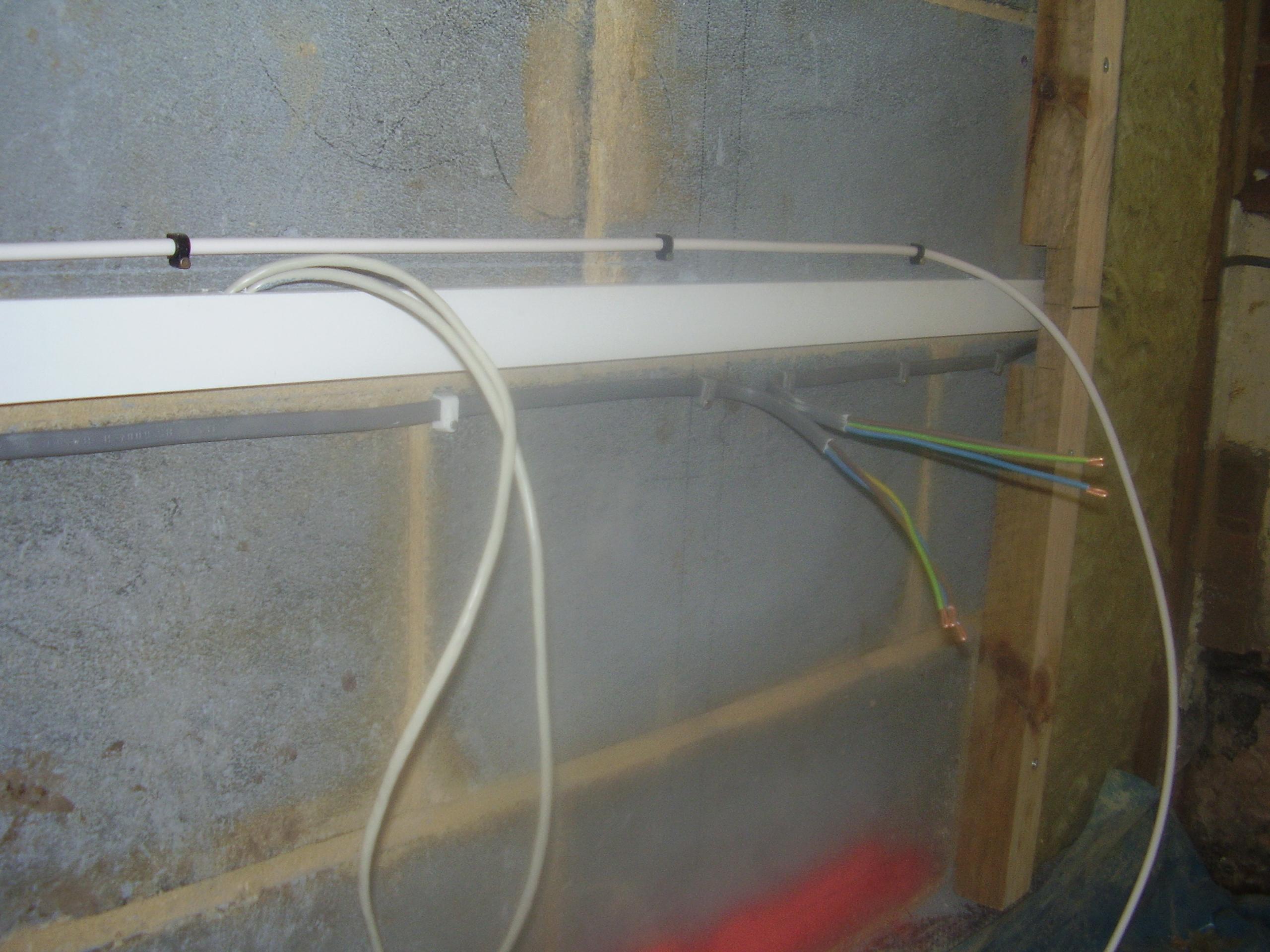

ProDave Posted December 25, 2020 Share Posted December 25, 2020 I seem to be in the minority of electricians that routinely runs cables horizontally around the room at socket height. As long as you have at least 1 socket on each wall you can run the cable all the way round at socket height meaning if you want to add another socket later at any point, the cable is there. I even had a stand up finger wagging argument once with a joiner working on the job who told me I could not do it like that and the cable must only come up or down to a socket. The main thing to get right on a job like this is the detail. As the back of the insulation will be open to a cold space, you need to be sure the insulation cannot fall out the back, and be sure there are no gaps in the insulation to let cold air in. It is very disappointing even on a new build today to find a howling blast of cold air come out of a back box when you remove a switch or a socket due to poor detailing. 1 Link to comment Share on other sites More sharing options...
Onoff Posted December 25, 2020 Share Posted December 25, 2020 (edited) 16 minutes ago, ProDave said: I seem to be in the minority of electricians that routinely runs cables horizontally around the room at socket height. As long as you have at least 1 socket on each wall you can run the cable all the way round at socket height meaning if you want to add another socket later at any point, the cable is there. I even had a stand up finger wagging argument once with a joiner working on the job who told me I could not do it like that and the cable must only come up or down to a socket. The main thing to get right on a job like this is the detail. As the back of the insulation will be open to a cold space, you need to be sure the insulation cannot fall out the back, and be sure there are no gaps in the insulation to let cold air in. It is very disappointing even on a new build today to find a howling blast of cold air come out of a back box when you remove a switch or a socket due to poor detailing. I've run cables horizontally like this since, well forever. Last time was though without the wisdom since learnt on here (& eBuild before) ref air tightness etc. Next time I'll do it all different! Edited December 25, 2020 by Onoff Link to comment Share on other sites More sharing options...
Alexphd1 Posted December 25, 2020 Share Posted December 25, 2020 @Prodave you seam to be one of the few tradesman that uses common sense. Our sparkle run drops even with a socket a meter along the wall from the other socket and large eaves behind. When I questioned this..... its the way we do it! Link to comment Share on other sites More sharing options...
ProDave Posted December 25, 2020 Share Posted December 25, 2020 4 minutes ago, Alexphd1 said: @Prodave you seam to be one of the few tradesman that uses common sense. Our sparkle run drops even with a socket a meter along the wall from the other socket and large eaves behind. When I questioned this..... its the way we do it! Yes he has used more cable, introduced more chances of cold air getting in, and made it hard to add extra sockets. Link to comment Share on other sites More sharing options...
