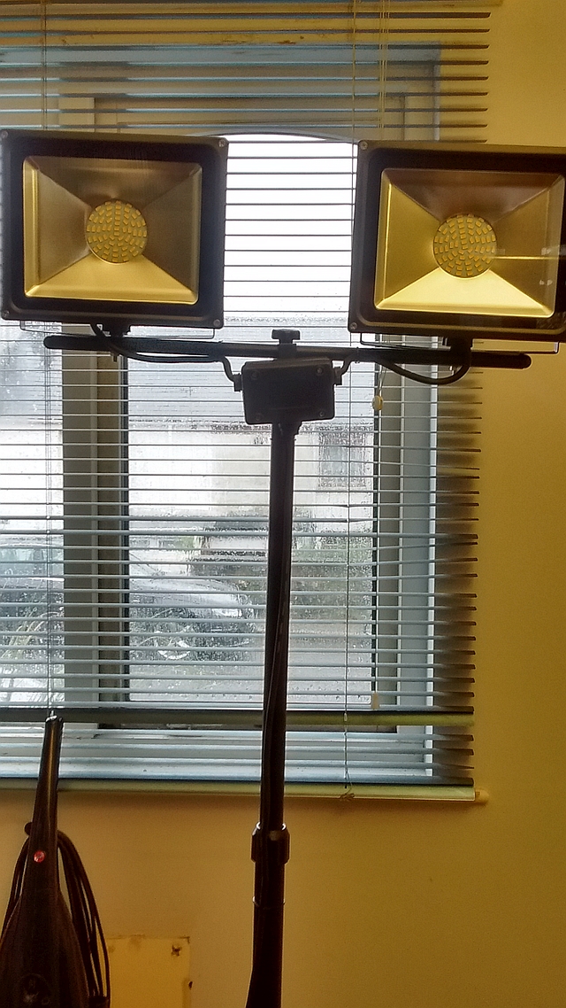

Barney12 Posted January 28, 2017 Share Posted January 28, 2017 Ive put these in my double headed tripod work lights. They're not as bright as the original bulbs but as you said they blow for a pastime. http://www.toolstation.com/shop/p28889?table=no the 78mm version is here: http://www.toolstation.com/shop/p52367?table=no 1 Link to comment Share on other sites More sharing options...
Steptoe Posted January 28, 2017 Share Posted January 28, 2017 (edited) 12 minutes ago, Barney12 said: Ive put these in my double headed tripod work lights. They're not as bright as the original bulbs but as you said they blow for a pastime. http://www.toolstation.com/shop/p28889?table=no the 78mm version is here: http://www.toolstation.com/shop/p52367?table=no this may sound counter intuitive , have you tried fitting them backwards? ie, facing the reflector rather than outwards I'm not saying it will be any better, (it may be worse!), but worth a try. Edited January 28, 2017 by Steptoe Link to comment Share on other sites More sharing options...

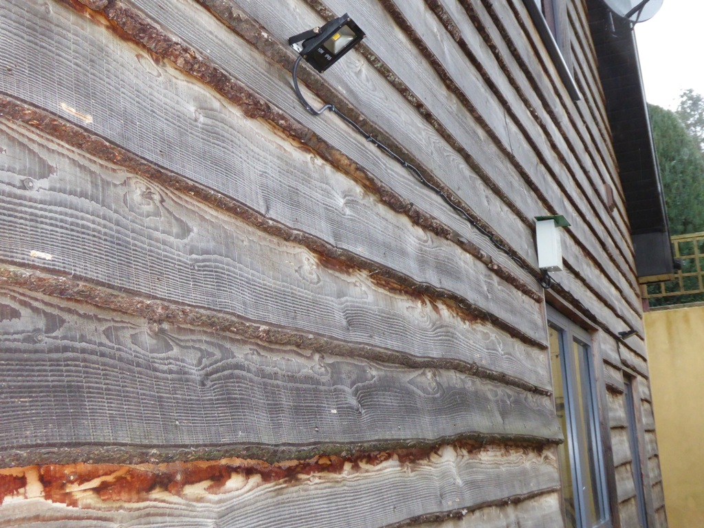

vfrdave Posted January 30, 2017 Share Posted January 30, 2017 23 hours ago, JSHarris said: 12V, 20W ones on the wall of our new house for well over a year now, running from a home made battery pack, solar panel charger and PIR switch @JSHarris any details on the make up of the above. I am about to start construction on site with no elec but would like some lighting around the container etc Link to comment Share on other sites More sharing options...
Jeremy Harris Posted January 30, 2017 Share Posted January 30, 2017 (edited) 1 hour ago, vfrdave said: @JSHarris any details on the make up of the above. I am about to start construction on site with no elec but would like some lighting around the container etc Sure, although I have two types now, the ones around the side of the house were the originals, put up quickly because there was no easy way of getting mains power to that wall (the problem being that I hadn't thought to run a cable up outside, and being a passive house it's not at all easy to run a new cable through an external wall). The ones around the side are two 10W 12V COB LED floodlights, like these: http://www.ebay.co.uk/itm/10W-LED-Flood-Lamp-Outdoor-Security-Light-IP65-Landscape-Floodlight-Lamp-G4-Corn-/360944005882?var=&hash=item5409f072fa:m:m5cZS9BBL3vdujKSXrmVZRw They aren't as powerful as their rating suggests, mine are closer to 7W than 10W, but they are plenty bright enough. I wired both of these lights back to a waterproof plastic box, screwed to the wall. At the bottom of the box I fitted a 12V PIR switch, with a night sensor (lots of the ones on Ebay don't have a light sensor and won't switch a couple of amps DC, so you need to hunt around for one). I made a bracket to go inside the box to take a 12V, 7Ah sealed lead acid alarm battery (they are about the cheapest around, because they are so commonly used as alarm back-up batteries). The charging is from a small 18V 2.5W solar panel (one of these: http://www.ebay.co.uk/itm/HOT-5-6-18V-0-2-1-5-2-5W-Solar-Panel-Module-System-Solar-Cells-Charger-Energy-/291545049148?var=&hash=item43e170683c:m:mp3hyNZPOYxpyvy3pfLAzGg ) fitted on a slightly angled bracket on top of the battery box. To control the charge to the battery and get the most out of the small solar panel. I used a switched mode MPPT charge regulator, one of these: http://www.ebay.co.uk/itm/New-5A-MPPT-Solar-Panel-Controller-Voltage-Step-down-Module-Constant-Current-/291991743947?hash=item43fc106dcb:g:KdQAAOSwnHZYbaqO, set to give a float voltage of 13.2V, for a long battery life. The panel only charges the battery at a maximum of around 100mA or so, but that is ample, even in winter, to keep the battery fully charged, as the timer on the PIR switch only keeps the flood lights on for around 5 minutes, and it's rare for them to come on more than two or three times in the evening. Doing the sums, the worst case energy used by the lights if they used their rated 10W each and were on for 20 minutes every evening, would be around 6.7 Wh, and the panel charges at around 0.5 to 1.5 W in winter daylight, so the batteries are charged by just about enough on a winters day to allow for the worst case. In practice, there are many evenings when the lights only come on once or twice, or maybe not at all, so the battery always has plenty of spare capacity. The battery theoretical capacity is 84 Wh, so discharging it with 20 minutes worth of lighting is only using around 8% of its capacity. This means there's enough reserve capacity for the system to go for a few dull days without the battery being discharged significantly. At the front of the house I've opted for a more discreet solar power lighting system. We have a glazed gable, with the glazed front door in the centre. The lower glazing is connected to the upper glazing with a joining cill, that has an alloy drip lip. The groove behind this was exactly the right width to take a 1.8m length of high power waterproof 12V LED strip. Instead of the bulky sealed lead acid battery, I used a very small 1,8Ah 12V lithium battery pack, with an inbuilt charging and battery protection circuit. This charging circuit needed to be fed with a constant 12.6V, so I made a small voltage regulator, set to 12.6V, and connected it via a diode to the same solar panel as I used around the side. I also used the same type of PIR switch. This is a lot more compact, and the LED strip throws light exactly where it's needed, and complies with our "Dark Skies" rules on outdoor lighting (the AONB we are in is seeking official "Dark Skies" certification, so all households are being told to shield outdoor lights and put them on PIRs or timers - we have no street lighting either). I'll try and take some photos later showing how the lights look when fitted. When I warned about the 240V versions of these floodlights being very dodgy, here are some photos I took when I stripped one down that show the earth problem (or, rather, the lack of an earth!) These were sold in the UK and are branded GLW, and I note that a safety recall was put out about this very problem. The 12V ones are fine, they are safe as the voltage is too low to be a risk. This is how they arrived from the UK seller - obviously Chinese made! This was my quick and dirty earth test, as I was suspicious about the earthing and like to check Chinese stuff, as I've seen far too much rubbish from there. As you can see, the earth wire is not connected to the case, which is scarily dangerous. When opened up, the reason for the open circuit in the earth was obvious, the idiot manufacturer had made no attempt to connect the earth wire - it was just floating loose inside the case! My solution was to solder on an earth tag that could then fit under a screw (I cleaned the paint off before doing this). This is the partly re-assembled flood light with the earth tag secured to the case. I checked and got good continuity between the case and the earth lead, so the light is now reasonably safe. This is the only 240V one of these lights I have used, it sits above my car charge point, pointing down and operated via a PIR switch, so that I can see to connect the car up at night. Edited January 30, 2017 by JSHarris Link to comment Share on other sites More sharing options...

Jeremy Harris Posted January 30, 2017 Share Posted January 30, 2017 Yes, should do the job just fine, and has the benefit of more adjustments than the one I used. I fitted my PIR in the bottom of a watertight plastic box, that was like this, with mounting lugs at the ends: http://www.ebay.co.uk/itm/24x12x7-5cm-IP65-Plastic-Electrical-Junction-Project-Box-White-Gray-/252639923825?hash=item3ad2834e71:g:Ep0AAOSwHMJYLXnO This one's from a Chinese supplier, but I'm sure I bought mine for a pound or two more from a UK seller. A 7Ah 12V sealed lead acid battery will just fit in one of these boxes, with a small bit of room either end. Link to comment Share on other sites More sharing options...

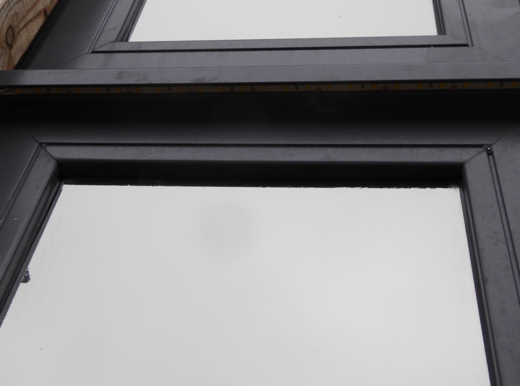

Jeremy Harris Posted January 30, 2017 Share Posted January 30, 2017 (edited) Right, had a chance to take some photos, unfortunately in the rain, so not the best. First off, this is the side of the house, where I have two "10 W" LED floodlights running from a solar-charged 7Ah sealed lead acid battery in the box on the wall: I have one light over the back door and the other pointing more or less at the wheelie bin storage area, The battery box is a bit big and bulky, and I may change it later to a lithium battery, like the one I've more recently fitted at the front, as that seems a bit less conspicuous. This is what the lights look like when on. They point downwards and really just light the path and that junk-filled area at the front right which is where the wheelie bins will go (when the Council get around to sending them............). The spread of light is pretty even, with no real dark spot between the two lights at all at ground level. This is the newer lithium battery powered system at the front of the house, it has the same solar panel as the one at the side, but uses a very much more compact battery, so is less intrusive looking. You can just about make out the LED strip stuck on inside the drip rail groove, on the stacking cill above the front door. And this is what the front lights look like when on, they light up the area aroudn the front door steps well. There is some light coming from the 240V PIR switched "10 W" floodlight I have fitted above my electric car charge point, that lights the path from the end of the drive to the path at the side to the back door, lit by the first set of lights. I could use a 240V LED here as I already had power to the charge point. Hope these give an idea of the sort of light output these things put out. Edited January 30, 2017 by JSHarris 4 Link to comment Share on other sites More sharing options...
PeterW Posted January 30, 2017 Share Posted January 30, 2017 1 hour ago, JSHarris said: You can just about make out the LED strip stuck on inside the drip rail groove, on the stacking cill above the front door. And this is what the front lights look like when on, they light up the area aroudn the front door steps well. There is some light coming from the 240V PIR switched "10 W" floodlight I have fitted above my electric car charge point, that lights the path from the end of the drive to the path at the side to the back door, lit by the first set of lights. I could use a 240V LED here as I already had power to the charge point. Hope these give an idea of the sort of light output these things put out. Now that is really neat ! I like that a lot..! Link to comment Share on other sites More sharing options...
Jeremy Harris Posted January 30, 2017 Share Posted January 30, 2017 Glad you like it! It was a pure fluke that the high power waterproof LED strip I already had was an EXACT fit into the groove in the alloy cill! The neat thing is that no one ever notices the light until is comes on, plus it sends all the light downwards, so keeps our "Dark Skies" inspectors happy...................... I also like the idea of having exterior lights that have no running cost. There are plans for more solar powered lights around the edge of the drive, as being such a steep slope, and with a tight curve, it's really difficult to tell where the outer edge is when reversing up it. Link to comment Share on other sites More sharing options...
