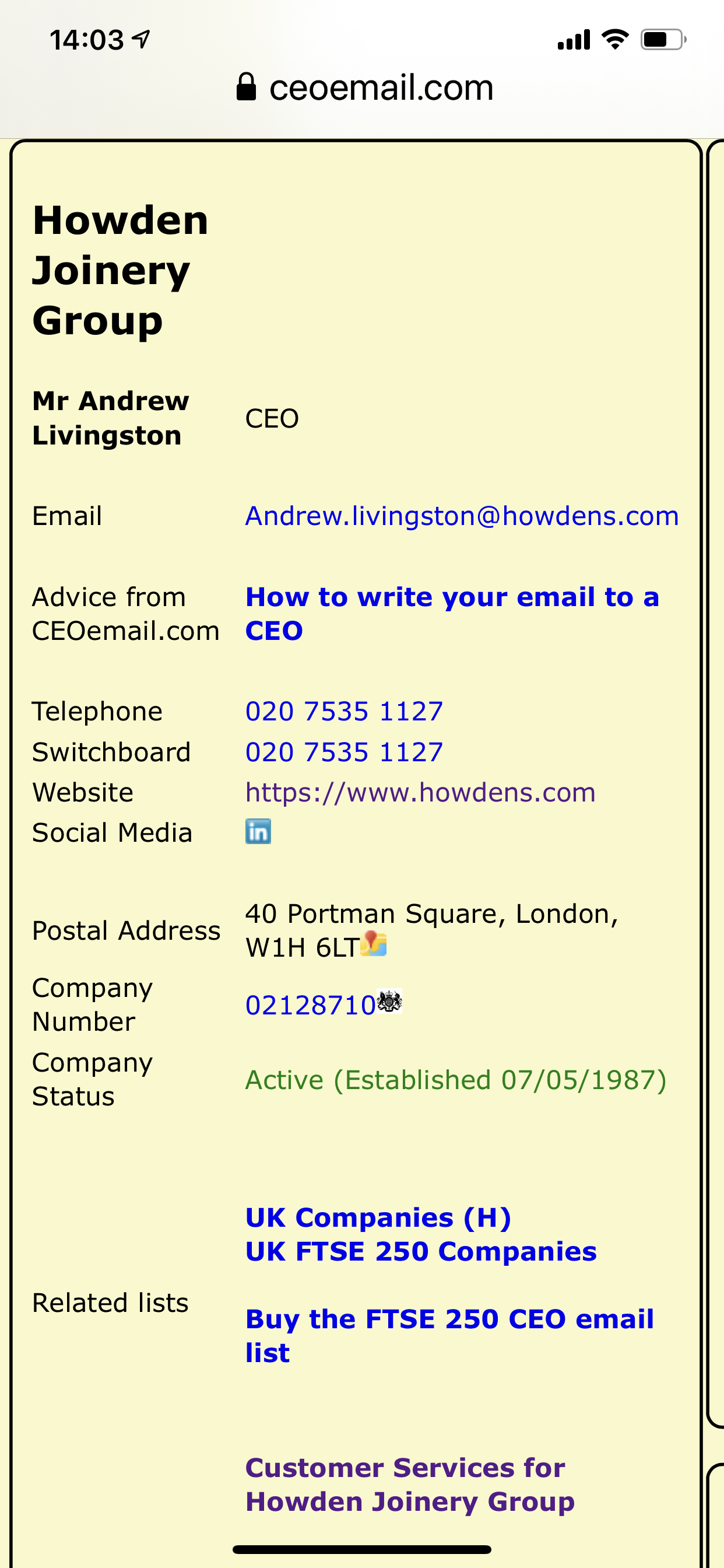

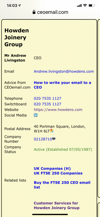

So you’ve rather complicated it for yourself having the work invoiced to your builder. I think you will get away with reclaiming the VAT on the supply of the kitchen as noted above but a 3rd party has ordered the supply and fit of the worktops so that muddies the water a bit. It’s still worth another go however as the work on a new build should have been zero rated. I assume you’ve simply spoken to someone in the shop? Forget them, and contact head office with an email explaining that supply and fit work on a new build property should be zero rated and point them at VAT Notice 708 Section 11.
https://www.gov.uk/guidance/buildings-and-construction-vat-notice-708#section11
If you can’t find a contact write a comment on their Facebook page (you’ll probably have to randomly comment on one of their posts as others have done) and you should get a response from them.
Failing that write to the CEO Andrew Livingston.
  • Like 1
Link to comment
Share on other sites
