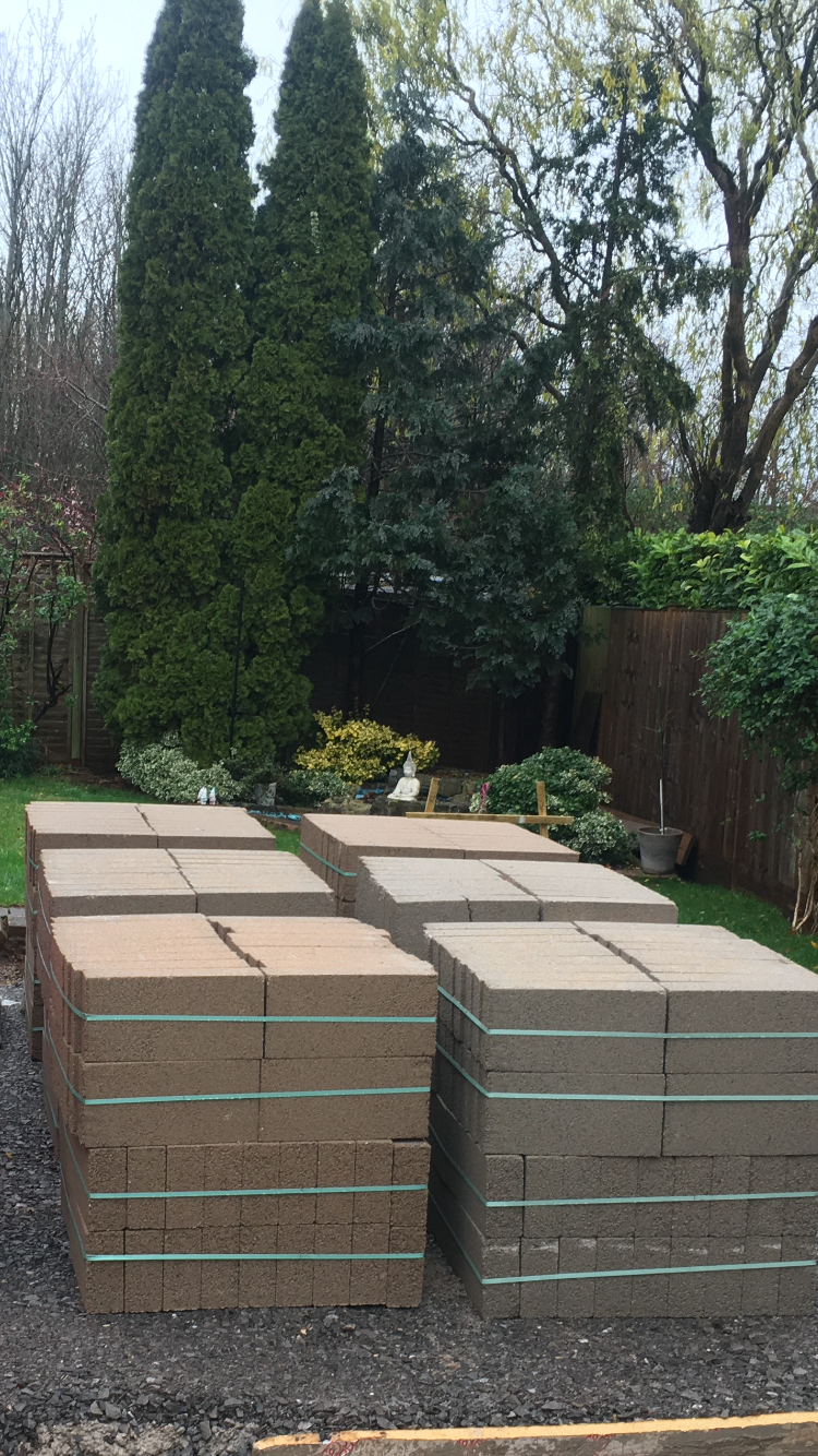

dangti6 Posted December 16, 2020 Share Posted December 16, 2020 Took delivery of several pallets of blocks earlier and they are wet. Weather permitting, brickies may make a start on Saturday. It's still raining out there now and Tomorrow is due to be a fairly dry day. I'm wondering whether to cover them over now (free at the sides for airflow), potentially holding in that moisture on top (a guess) or perhaps just cover them tomorrow once they have dried out a bit. What would you do? Link to comment Share on other sites More sharing options...
Gav_P Posted December 16, 2020 Share Posted December 16, 2020 Cover them now. Uncover them tomorrow. 1 Link to comment Share on other sites More sharing options...
dangti6 Posted December 16, 2020 Author Share Posted December 16, 2020 Ta da. Thanks. Why didn't I bloody think of that ? 1 Link to comment Share on other sites More sharing options...

dangti6 Posted December 16, 2020 Author Share Posted December 16, 2020 Picture speaks a thousand words. Link to comment Share on other sites More sharing options...
Declan52 Posted December 16, 2020 Share Posted December 16, 2020 They will never dry out in stacks like that. All your going to be able to do is cover them up so they don't get any wetter. Link to comment Share on other sites More sharing options...
Vijay Posted December 16, 2020 Share Posted December 16, 2020 so what happens when you lay wet blocks? Link to comment Share on other sites More sharing options...
Declan52 Posted December 16, 2020 Share Posted December 16, 2020 They sink and the mortar draws the water out of the blocks and you get salt patches on the wall. And of course they are much heavier and rip the skin of your fingers much quicker. No suction on the blocks as well. Link to comment Share on other sites More sharing options...
epsilonGreedy Posted December 16, 2020 Share Posted December 16, 2020 3 hours ago, Declan52 said: They sink and the mortar draws the water out of the blocks and you get salt patches on the wall. And of course they are much heavier and rip the skin of your fingers much quicker. No suction on the blocks as well. Will the brickies try to compensate for the wet blocks by mixing a drier/stiffer mortar? Link to comment Share on other sites More sharing options...

wozza Posted December 16, 2020 Share Posted December 16, 2020 Restack the top layer or two by removing every other block and then alternating the next layer to allow airflow - then cover them. Link to comment Share on other sites More sharing options...
Declan52 Posted December 16, 2020 Share Posted December 16, 2020 33 minutes ago, epsilonGreedy said: Will the brickies try to compensate for the wet blocks by mixing a drier/stiffer mortar? They should. They need stacked in rows, 3 blocks wide on their edge then the next row 3 on their edge the opposite direction and so on 5/6 block high. This will give plenty of room around all the sides of the block to get air in-between to dry them out. Then covered at the top with polythene or a mortar board. Link to comment Share on other sites More sharing options...

dangti6 Posted December 16, 2020 Author Share Posted December 16, 2020 Threw a poly sheet over them. Will stack some out tomorrow. They are laying a course of block followed by 3 courses of facing up to DPC - I’ll be surprised if they do much more than that Saturday morning. They can either create multiple stacks where they want ‘em in preparation or tell me so I can have it sorted for them to return on the Monday. No doubt they’ve laid worse and will adjust mix accordingly. Link to comment Share on other sites More sharing options...
