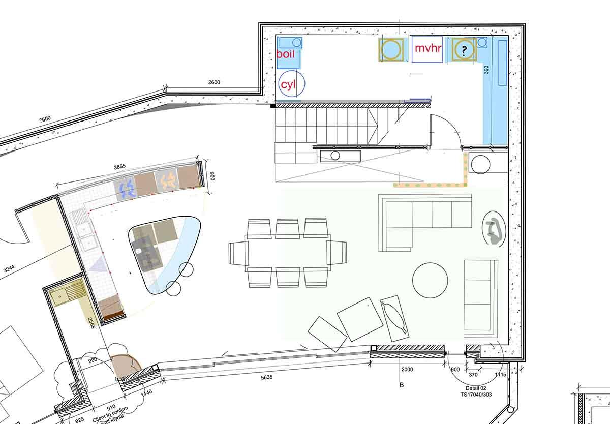

revelation Posted December 14, 2020 Share Posted December 14, 2020 Hi all I was wondering if someone could offer a little insight. We are having our heat recover system installed soon, we have the decision to make whether to install it in our downstairs utility room, or our loft (has been converted and is fully insulated with easy access). The utility room would be our preference as we have space and it allows for a larger bathroom in the loft, and will make external venting (supply and extract) easier. However, I biggest concern is the noise. The utility room is next to our open plan kitchen and our living room too, we plan to use Zehnder comfowall attenuators and manifold so that should help too. Does anyone have much experience with such a set up that could offer some advice? Regards Link to comment Share on other sites More sharing options...

revelation Posted December 15, 2020 Author Share Posted December 15, 2020 Thats handy to know. We will be using the Zehnder silencer/attenuated manifolds which go directly on the main unit. Our sitting space will be pretty close to the utility room, (around 2-3 metres away from the unit). I guess due to the airflow you will have some low level sound all of the time anyway, which I expect. Would anyone recommend going for a Q450 instead of the Q350. my house is pretty much 165m sq which is the upper limit of the Q350, so I assume the Q450 would run at a lower level to do the same work? Regards Link to comment Share on other sites More sharing options...

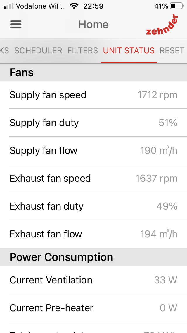

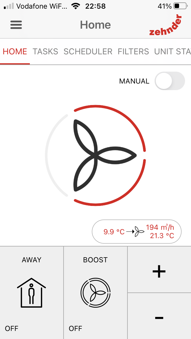

mvincentd Posted December 15, 2020 Share Posted December 15, 2020 10 hours ago, revelation said: my house is pretty much 165m sq which is the upper limit of the Q350, I'm 200sqm, the attached screenshots from the app show currently it's shifting 194cubic m by using 50% fan duty. My commissioning cert' says medium supply-54.6%, high supply-72.2% I'd assume like you re' the q450 though so if space and money is no issue.....but i don' think you NEED it. Link to comment Share on other sites More sharing options...
