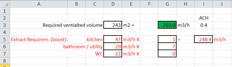

john0wingnut Posted December 12, 2020 Posted December 12, 2020 Hi all I have attached a spreadsheet with my current calculations, and just wanted to run them past the forum to make sure I am on the right track. The current Bungalow floor area is 168m2, so at 0.3l/s that would require a minimum of 50l/s or 180m3/h. High rate would be 45l/s or 162m3/h for kitchen and 3 bathrooms and utility) We are planning on doing a 1st floor extension under the new PD rules, which would bring the total floor area to 243 m2, which would require 73l/s (263m3/h) minimum ventilation and high rate of 69l/s (248m3/h) 1) Have I worked those out correctly 2) I was looking at the Brink Flair 400 unit, which maxes out at 400m3/h. So in theory my background ventilation of 263m3/h would mean the unit is running at 65%, which I would assume is too high, so am I looking at needing a bigger unit, or getting say 2 units, one for upstairs and one for downstairs. Many thanks in advance John MVHR Calculations.xlsx

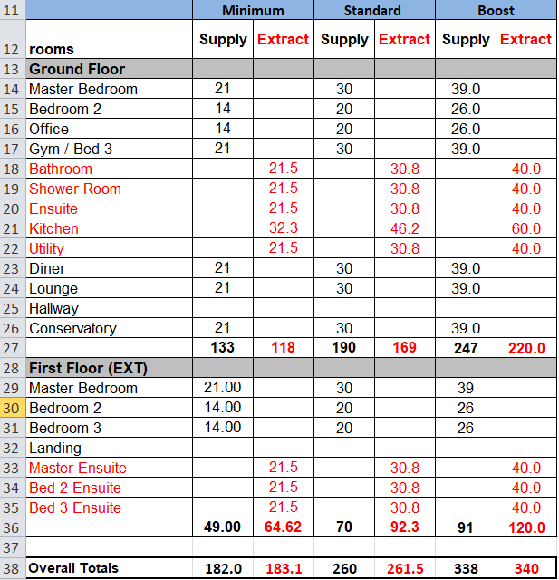

john0wingnut Posted December 17, 2020 Author Posted December 17, 2020 Ok, so no replies, I figured I've probably done something daft and no one wants to say anything...... So, I've had another go using the English Building Regs minimum Vs Passive House good practice guide. Via BR: Via PH Good Practice Guide: So via BR method the required boost value is lower than the minimum ventilation requirement, which doesnt make sense to me, and would mean I under spec the unit! But via the PH method, I get a similar ventilation number @ 260m3/h and a boost of 340m3/h, which makes much more sense. So the 400m3/h unit I was considering should be absolutely fine, so long as it is turned down to the minimum setting of 183m3/h, after signoff / commissioning etc, which would mean it was running at 45% of max capacity.
CC45 Posted December 17, 2020 Posted December 17, 2020 I've attached calcs for ours - done by BPC. I had the impression that as long as you are there overall with a bias towards more ventilation in bathrooms & kitchens then its OK. Kitchen is approx 0.5m3/hr with bathroom @ about 2m3/hr. Despite the ensuites being a fair bit smaller they still seem to get the same extract rate. I assume I've got it right... (all my notes are down the plot - not here).

PeterW Posted December 20, 2020 Posted December 20, 2020 On 17/12/2020 at 15:43, CC45 said: Despite the ensuites being a fair bit smaller they still seem to get the same extract rate. I assume I've got it right... (all my notes are down the plot - not here). Those convert to the boost rates for the minimum required for the Building Regs - nothing scientific about it.
