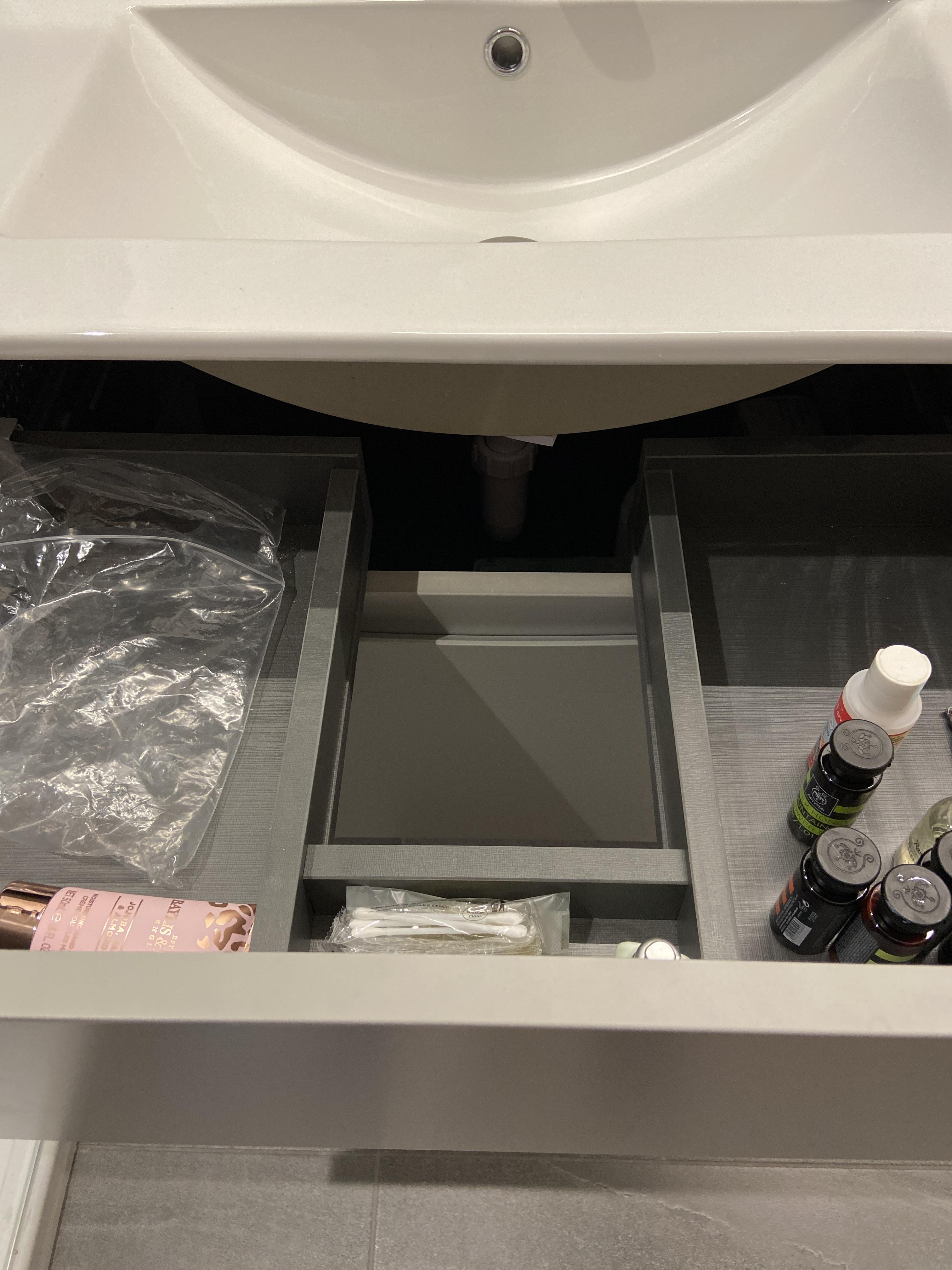

ProDave Posted December 6, 2020 Share Posted December 6, 2020 I saw one just last week where when you opened the top drawer, it was in fact two narrow drawers with a gap in between for the basin trap to hang down into. Link to comment Share on other sites More sharing options...

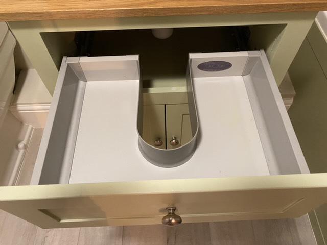

Gav_P Posted December 6, 2020 Share Posted December 6, 2020 (edited) The top draw in ours has a u shape cutout for the trap. Edited December 6, 2020 by Gav_P Add pic Link to comment Share on other sites More sharing options...

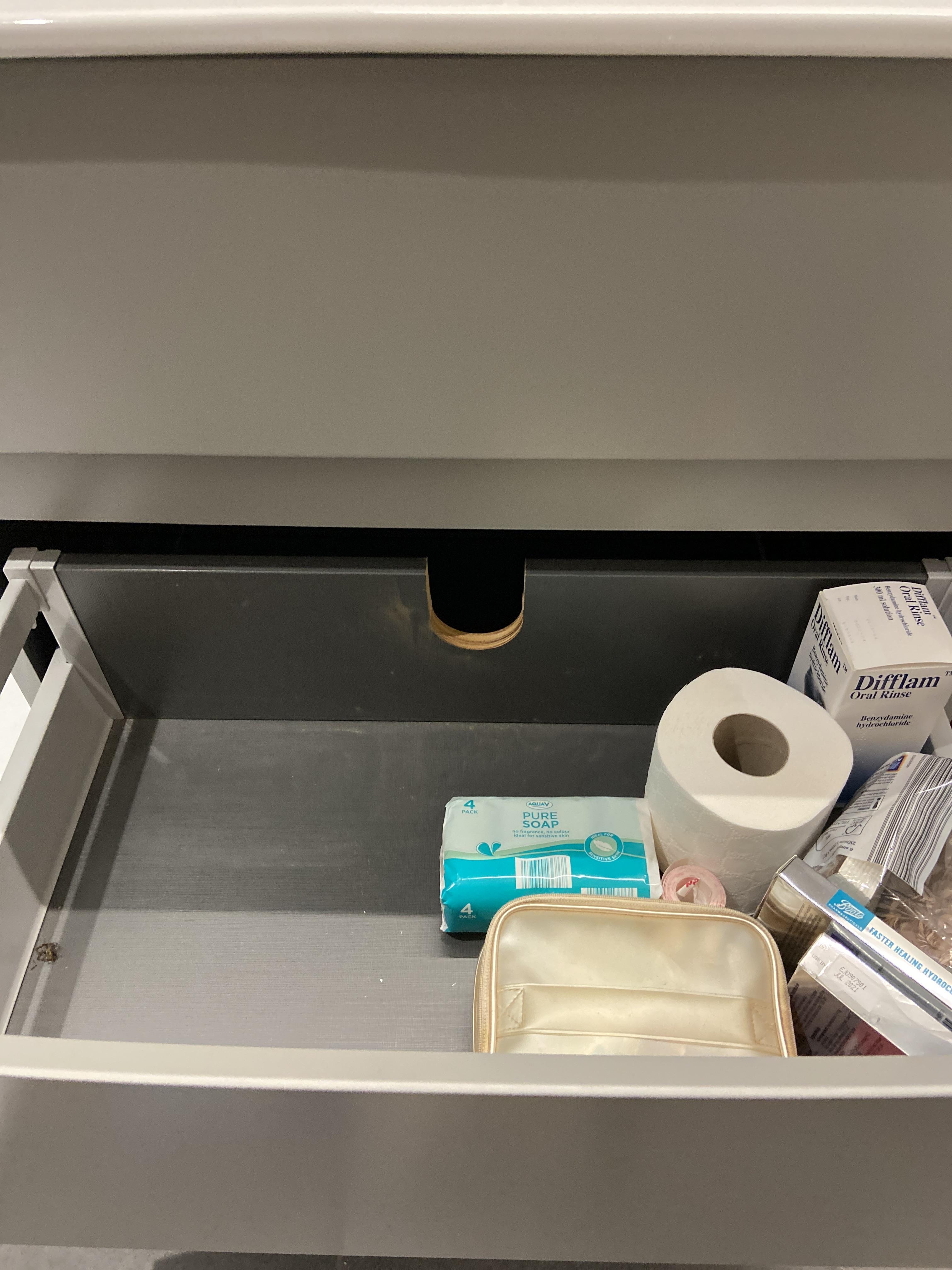

Weebles Posted December 6, 2020 Share Posted December 6, 2020 Top drawer of ours is missing a bit to allow for the waste. Bottom drawer had to be adapted a little. Link to comment Share on other sites More sharing options...
