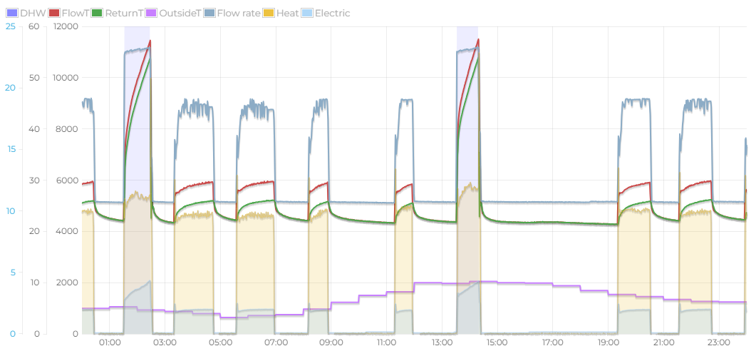

Dreadnaught Posted September 29, 2024 Share Posted September 29, 2024 (edited) Just to clarify… the Energy Integral for the "Vaillant Arotherm Plus" heat pump is the name given to a way that the heat pump's microprocessor controller decides when to turn off the compressor pump, and hence stop heating. And the same Energy Integral also then informs the controller when to subsequently to turn it back on again. (There is also another way the compressor turns on and off unrelated to the Energy Integral, but that's by-the-by). The Energy Integral in this case has the units of "º minutes" ("degree minutes"); note this is not degrees "per" minute. Simplified and only dealing with heating … the controller calculates the number of degrees that the "flow temperature" deviates from the "targeted flow temperature" each minute. This is then summed cumulatively each minute to keep a running total. For example… if the flow temperature in the pipe leaving the heat pump is 42º and the controller is targeting a 38º flow temperature then (42-38) = "4" is added to the Energy Integral at the end of that minute. If in the next minute the figures are 45 and 38 then "7" is added at the end of the subsequent minute. And so on minute by minute. This cumulative sum is the "Energy Integral". Then… when that cumulative sum of these figures reaches zero (from its negative starting point; default is "-60" but this can be changed in the settings) the controller turns the compressor pump off and heating stops. There are more subtleties than I have mentioned above … such as overrun of the sum and the control of the separate building-circulation pump … but that's the essence of it. It's simple and elegant. I suspect that cumulative counters are used commonly in electronic control-systems. Perhaps an engineer here could confirm this. Edited September 29, 2024 by Dreadnaught 1 Link to comment Share on other sites More sharing options...
JamesPa Posted September 29, 2024 Share Posted September 29, 2024 (edited) 36 minutes ago, Dreadnaught said: I suspect that cumulative counters are used commonly in electronic control-systems. Perhaps an engineer here could confirm this. You are correct. The classic PID (proportional, integral, differential) controller uses the current deviation of the variable (eg temperature) from the desired value, the cumulative difference between the target and actual value, and the current rate of change of the variable into account (in various proportions) to decide the change made in the controlled parameter (eg energy input) PID controllers appear in many control systems, there is a raft of theory on them and tuning them to get the right proportions of p, I and d can be 'interesting', particularly if there is long delay between changing the input and when the output changes (as there is in a heating system) or nonlinearity. Edited September 29, 2024 by JamesPa 1 Link to comment Share on other sites More sharing options...
sharpener Posted September 29, 2024 Share Posted September 29, 2024 (edited) 42 minutes ago, Dreadnaught said: Perhaps an engineer here could confirm this. The energy integral is the I part of a standard PID control loop (Proportional, Integral, Differential). Weather compensation is a feed-forward Proportional term. The closed-loop Integral term takes out any residual error and avoids long-term drift. I do not know if there is a differential term, this would be needed to cope with sudden changes of room temp or OAT which are unlikely - the classic theory was developed for radar tracking of fast-moving targets. It might though be included in the Room Temp mod settings (if used, I don't). @JamesPa Snap! Edited September 29, 2024 by sharpener Great minds! 1 Link to comment Share on other sites More sharing options...
JohnMo Posted September 29, 2024 Share Posted September 29, 2024 Big question - do you need the Energy Integral? Does add to system efficiency or house comfort? Suspect the answer is maybe or sometimes. But generally a good marketing tool, has kept this thread talking about it for a few years. Link to comment Share on other sites More sharing options...
Dan F Posted September 30, 2024 Share Posted September 30, 2024 On 29/09/2024 at 11:08, JohnMo said: Big question - do you need the Energy Integral? Does add to system efficiency or house comfort? Suspect the answer is maybe or sometimes. But generally a good marketing tool, has kept this thread talking about it for a few years. It's not marketing (and I haven't seen it mentioned in marketing materials), it's a control strategy that is important to control cycling when heating load is less than minimum output. Without an integral-based control mechanism how would ASHP control cycles? Using simple hystersis would result in more temperature swings impacting efficiency and comfort AFAIU.. 1 Link to comment Share on other sites More sharing options...
JohnMo Posted September 30, 2024 Share Posted September 30, 2024 33 minutes ago, Dan F said: Without an integral-based control mechanism how would ASHP control cycles? Using simple hystersis would result in more temperature swings impacting efficiency Interesting thought, but not sure I agree, many ASHP don't have that functional control. We are currently putting in less than an average of 1kW into the house with a 6kW heat pump, so well below any modulation, controlled on hysteresis and pure WC. House fluctuating a massive +/-0.25 degs and daily CoP generally around 5 for heating, as I get thing optimised. Generally cycling is good, its an easy way to control capacity, when below min modulation. The only caveat the run time needs to be long enough to do some useful heating, this varies with different systems, this is easy to tweak with hysteresis. Link to comment Share on other sites More sharing options...
sharpener Posted September 30, 2024 Share Posted September 30, 2024 2 hours ago, Dan F said: Without an integral-based control mechanism how would ASHP control cycles? Using simple hystersis would result in more temperature swings impacting efficiency and comfort AFAIU.. The obvious way would be to run the HP on a mark-space ratio to give an average power defined by the WC algorithmn. You might want to fine tune it with room temperature feedback but it would surely be better than allowing it to just switch on and off as it oscillates about the room temp setting (bang-band servo mode). Link to comment Share on other sites More sharing options...
Dan F Posted September 30, 2024 Share Posted September 30, 2024 1 hour ago, JohnMo said: Interesting thought, but not sure I agree, many ASHP don't have that functional control. We are currently putting in less than an average of 1kW into the house with a 6kW heat pump, so well below any modulation, controlled on hysteresis and pure WC. House fluctuating a massive +/-0.25 degs and daily CoP generally around 5 for heating, as I get thing optimised. Generally cycling is good, its an easy way to control capacity, when below min modulation. The only caveat the run time needs to be long enough to do some useful heating, this varies with different systems, this is easy to tweak with hysteresis. Which ASHP is this? What is hysteresis? My understanding is that with a target flow temp of 23C and a 7K hysteresis (as an example) with an open loop system the ASHP is going to run until flow temp reaches 30C and then shut down. Is this how yours behaves, or does it do something different e.g. mark-space ratio. I assume you much have hysteresis much lower than 7K? Otherwise, if flow temp does have to ramp up to 30C before ASHP shuts down, this risks temperature fluctuations and possibiity to overshoot. Link to comment Share on other sites More sharing options...
JohnMo Posted September 30, 2024 Share Posted September 30, 2024 1 hour ago, Dan F said: What is hysteresis You have a start and stop hysterisis for the compressor. So for a target of 25, the return flow will drop by a predetermined amount below the target flow temp, once at that point compressor starts. It will run until the shut off hysterisis temp is reached. How long it runs depends on system volume, heat demand and how deep the heat pump modulates. My settings are based on my system and what it does and doesn't do. Mine at a target flow of 25, start up hysterisis is 5.1, so return temp is allowed to fall to 19.9, before compressor start. Cut off hysterisis is 2.3 so cuts off at 27.3. My total hysterisis is 7.4. All this changes with different heating systems and houses. Mine is 300mm spacing UFH in 100mm concrete screed. Heat pump is a Maxa i32V5. Today excluding DHW the compressor has started 5x times up to 10pm, shortest run time was 18 mins (9 degs OAT) and longest run 2.5 hrs (5 Deg OAT). WC is all about running just enough to top up the energy in the house, so I use the hysterisis and a WC curve to play with the floor heat output. Based on the floor average temperature, to get the correct heat output. The WC curve starts at 15 Deg OAT at 25, this gives a floor minimum temperature of 19.9 (don't want the heating on really at that temperature), at -9 the WC curve stops at 30.3, so floor temp is a minimum of 25.2 (not tested this temp yet). So far this is working fine down to +3 degs. Depending on actual run times at sub zero this will affect where WC stops and at what flow temp. But once set it's set for ever. 1 Link to comment Share on other sites More sharing options...
