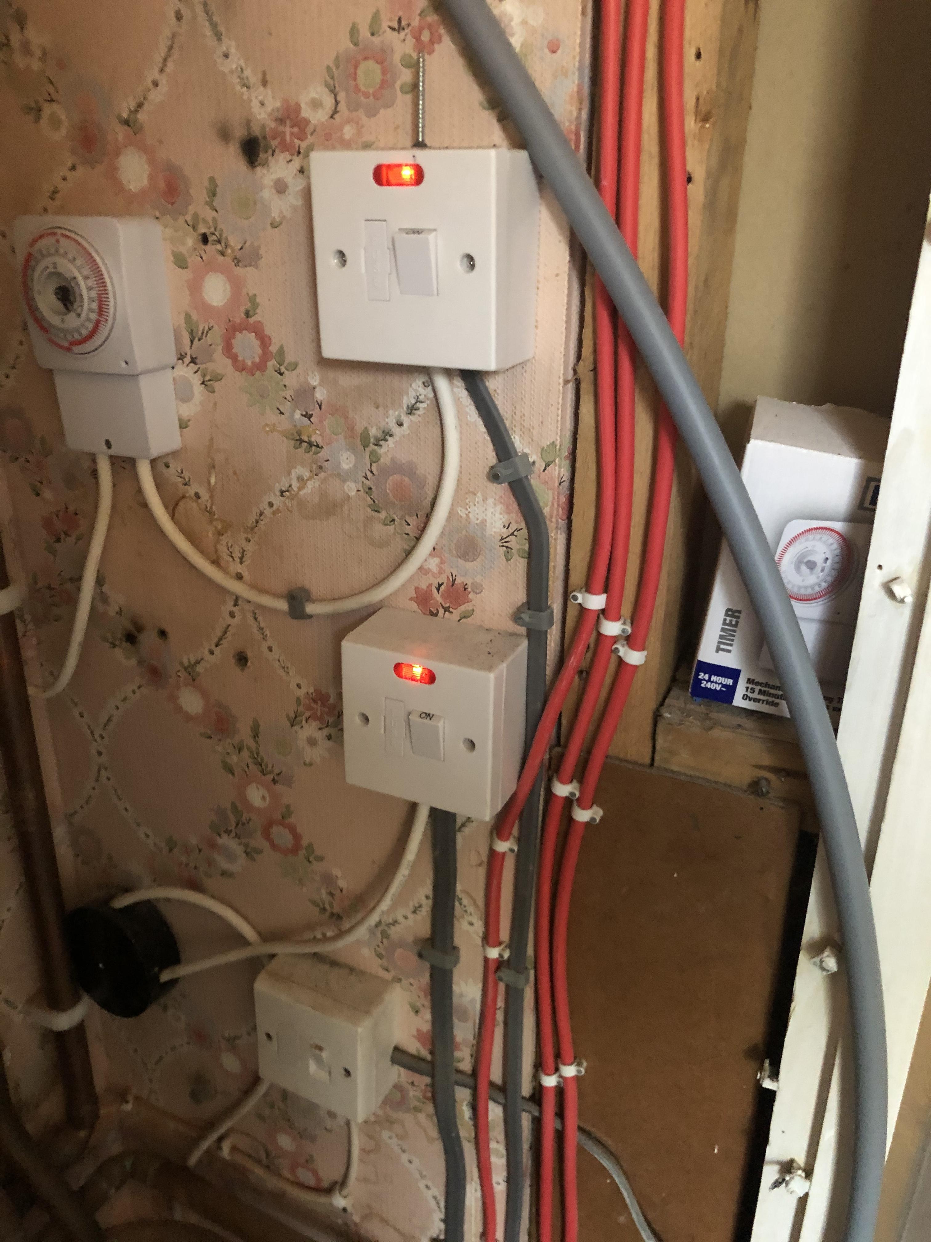

Pocster Posted December 4, 2020 Posted December 4, 2020 Tenants tell me no hot shower water which comes from a uvc . Taking a look I see for some reason the second switch down with orange light is not lit . I literally apply almost no pressure and the light comes on . So assume the switch mechanics are dodgy . The orange light though now ‘wobbles’ ( or my eyes are bust ) - is that a further sign of an impending issue ?
joe90 Posted December 4, 2020 Posted December 4, 2020 The orange light is a neon, and they do tend to flicker a bit, but change that switch or take it off and make sure the screws holding the wires are tight, there is a fair bit of current through those things. 1
ProDave Posted December 4, 2020 Posted December 4, 2020 The neon lights are notoriously unreliable and often fail, often because of the appallingly bad way they are connected inside the switch, so no light does not automatically mean no power. the only sure way is to take it off and measure the voltage at the output. But hold on, what is going on there? Top switch I would expect to be daytime boost, but it connects to a timer, so are you giving the tank a daytime boost regardless of whether it needs one or not? And the bottom switch I would expect to be off peak and would not expect any power to it in the daytime, but it has power, and why does it connect to a junction box going to multiple places not just straight to it's immersion heater element?
Pocster Posted December 4, 2020 Author Posted December 4, 2020 14 minutes ago, ProDave said: The neon lights are notoriously unreliable and often fail, often because of the appallingly bad way they are connected inside the switch, so no light does not automatically mean no power. the only sure way is to take it off and measure the voltage at the output. But hold on, what is going on there? Top switch I would expect to be daytime boost, but it connects to a timer, so are you giving the tank a daytime boost regardless of whether it needs one or not? And the bottom switch I would expect to be off peak and would not expect any power to it in the daytime, but it has power, and why does it connect to a junction box going to multiple places not just straight to it's immersion heater element? Lol ! I don’t know ! I didn’t wire it ! ? I’ll see if it works ( I’ve allowed an hour so will contact tenant now ) . In theory though even if bottom switch was off , top timed one should of provided a tank of hot water anyway ....

ProDave Posted December 4, 2020 Posted December 4, 2020 I suspect you have TWO problems: Off peak heater has failed some time ago, but has gone unnoticed until now that the TOP immersion (or the timer) has failed. Or possibly vice versa. Either way an electrician, armed with a spare immersion element or 2 should sort it. 1

Pocster Posted December 4, 2020 Author Posted December 4, 2020 12 minutes ago, ProDave said: I suspect you have TWO problems: Off peak heater has failed some time ago, but has gone unnoticed until now that the TOP immersion (or the timer) has failed. Or possibly vice versa. Either way an electrician, armed with a spare immersion element or 2 should sort it. Will a sparky be able to check if the elements are dead ? . I would guess also more than 1 issue at work here . Super Sparky will solve it ?
ProDave Posted December 4, 2020 Posted December 4, 2020 6 minutes ago, pocster said: Will a sparky be able to check if the elements are dead ? . I would guess also more than 1 issue at work here . Super Sparky will solve it ? It just takes a multimeter to check the continuity of the element, typically in the region of 19 ohms for a good one. So if there is no off peak, why the 2 feeds and only one on a timer? Perhaps a bit of understanding of what you have got and check it matches what you need?

Pocster Posted December 4, 2020 Author Posted December 4, 2020 3 minutes ago, ProDave said: It just takes a multimeter to check the continuity of the element, typically in the region of 19 ohms for a good one. So if there is no off peak, why the 2 feeds and only one on a timer? Perhaps a bit of understanding of what you have got and check it matches what you need? No idea why it’s done like that . Perhaps the ‘plan ‘ ( not my plan ) was a timer for when demand is higher . I expect they didn’t understand it’s a hmo and ( especially now ) demand for hot water can be 24/7 I.e shift work so not a simple boost in the morning type scenario you would get in a ‘family’ household . What I need is hot water 24/7 so the timer might be pointless BUT ( I remember now ! ) there are 2 elements so assume one is the timer the other the always on . Was installed 2 years ago - can’t remember!!!!
