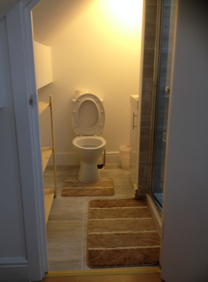

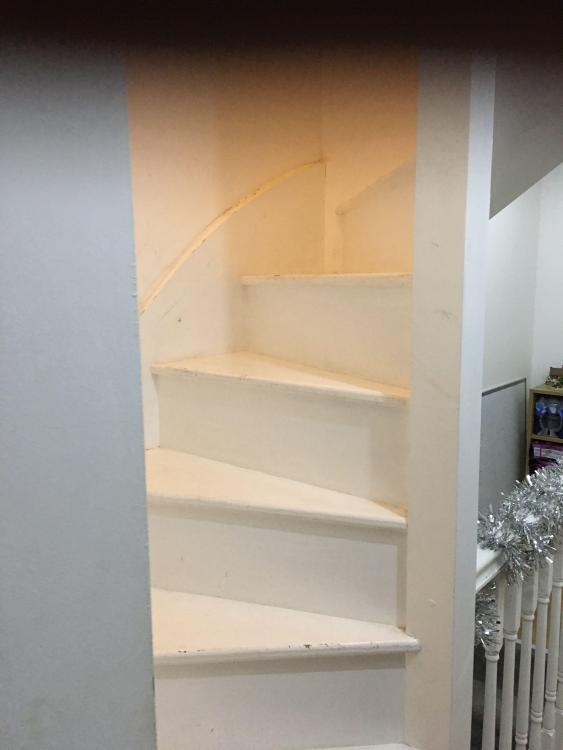

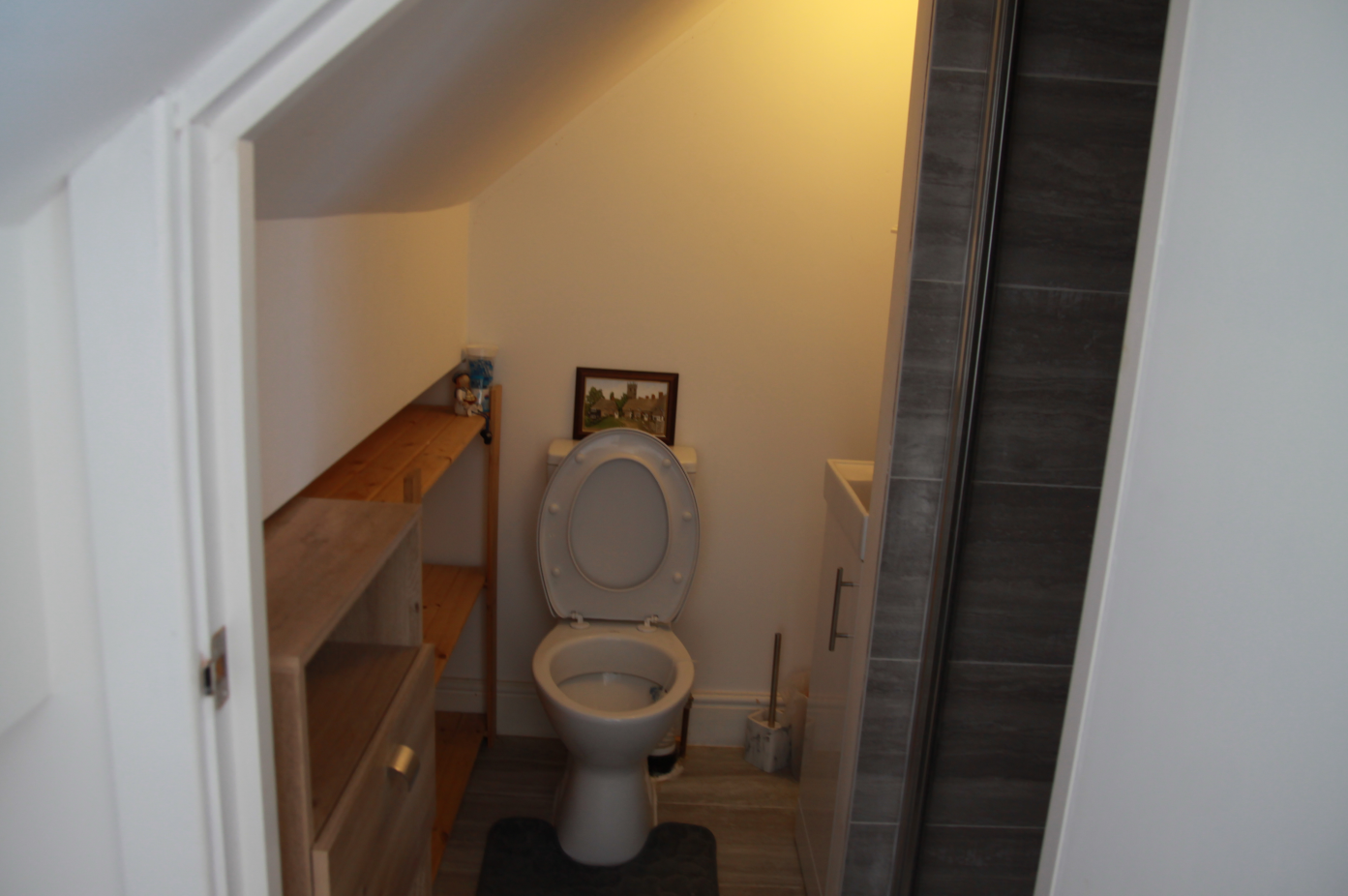

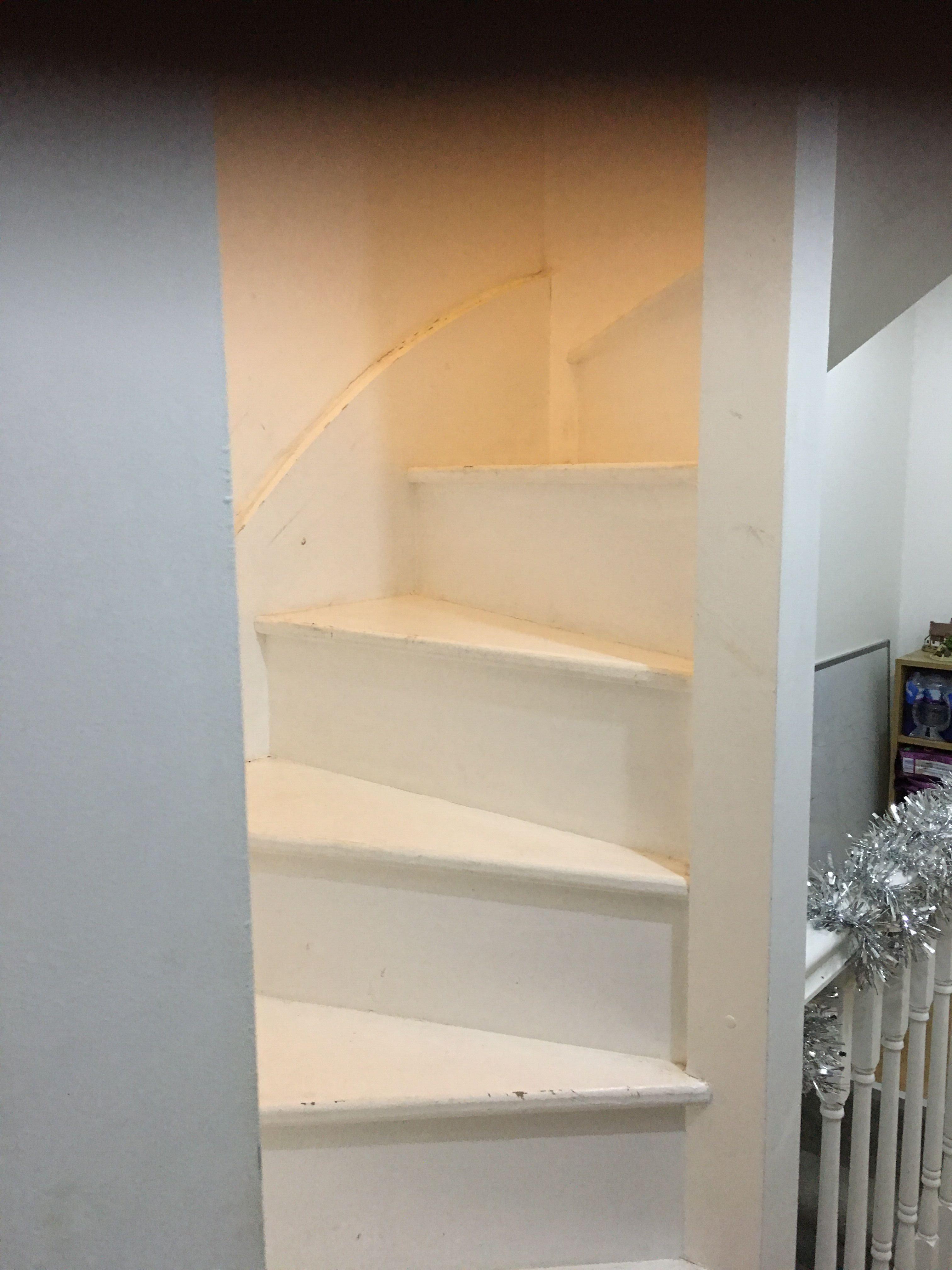

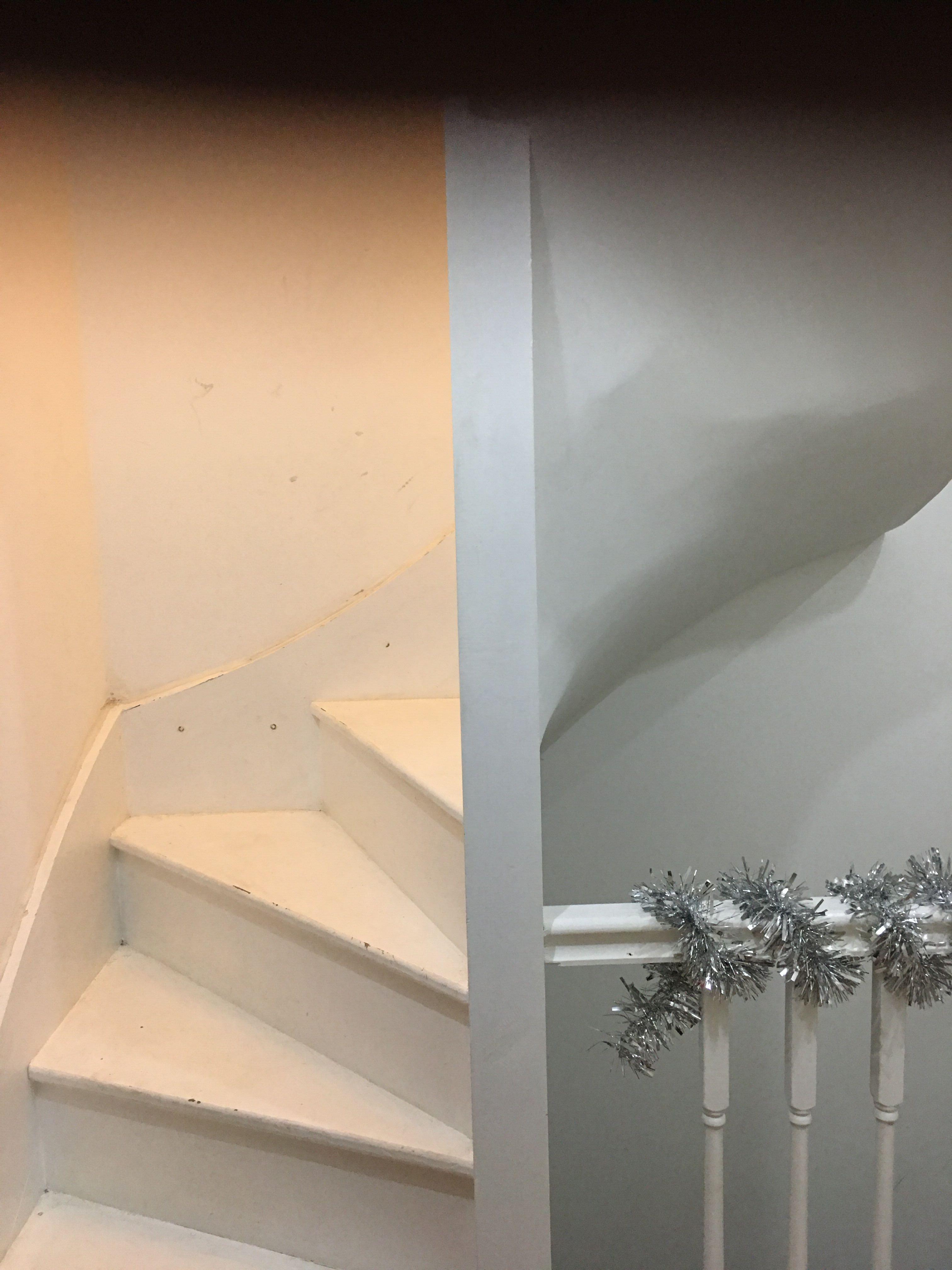

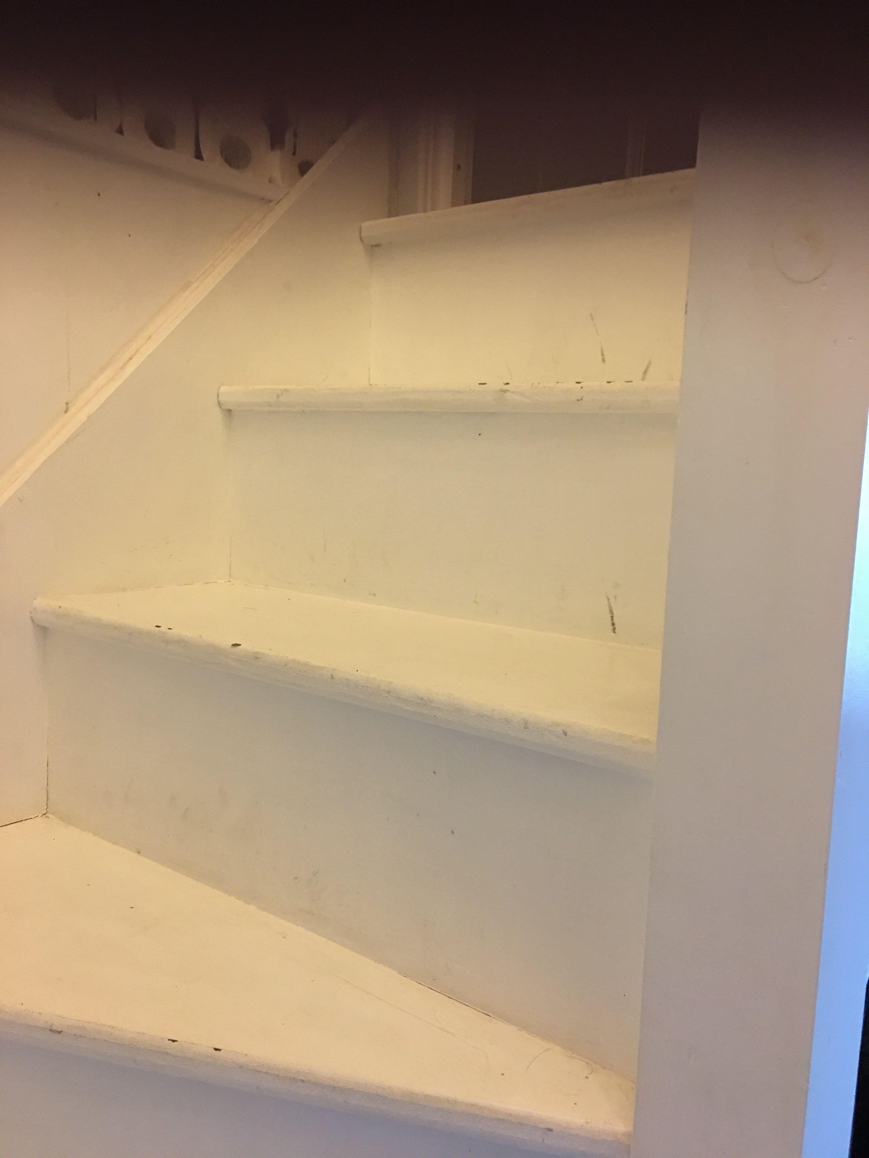

ProDave Posted December 4, 2020 Posted December 4, 2020 Do you feel inclined to post some pictures so we might get an idea what complies or not? The major things are Structure. BC will probably want the structure exposed so they can see if it is adequate and possibly structural engineers calculations. Insulation: Proof the walls and roof are insulated to required standards. Windows and fire escapes, a window will need to be a maximum height from the floor and a minimum opening to be used as a fire exit. Stairs will need to comply with normal stair rules of width, steepness and headroom. Fire doors if it is a loft conversion of a 2 storey property making it now 3 storeys.

nina Posted December 4, 2020 Author Posted December 4, 2020 (edited) 5 hours ago, ProDave said: Do you feel inclined to post some pictures so we might get an idea what complies or not? The major things are Structure. BC will probably want the structure exposed so they can see if it is adequate and possibly structural engineers calculations. Insulation: Proof the walls and roof are insulated to required standards. Windows and fire escapes, a window will need to be a maximum height from the floor and a minimum opening to be used as a fire exit. Stairs will need to comply with normal stair rules of width, steepness and headroom. Fire doors if it is a loft conversion of a 2 storey property making it now 3 storeys. not sure if the toilet or staircase (the height is fine just uncertain about steep and width) , any advise will be highly appreciated... to start from strach is really gona be too much pain and money Edited December 4, 2020 by nina
