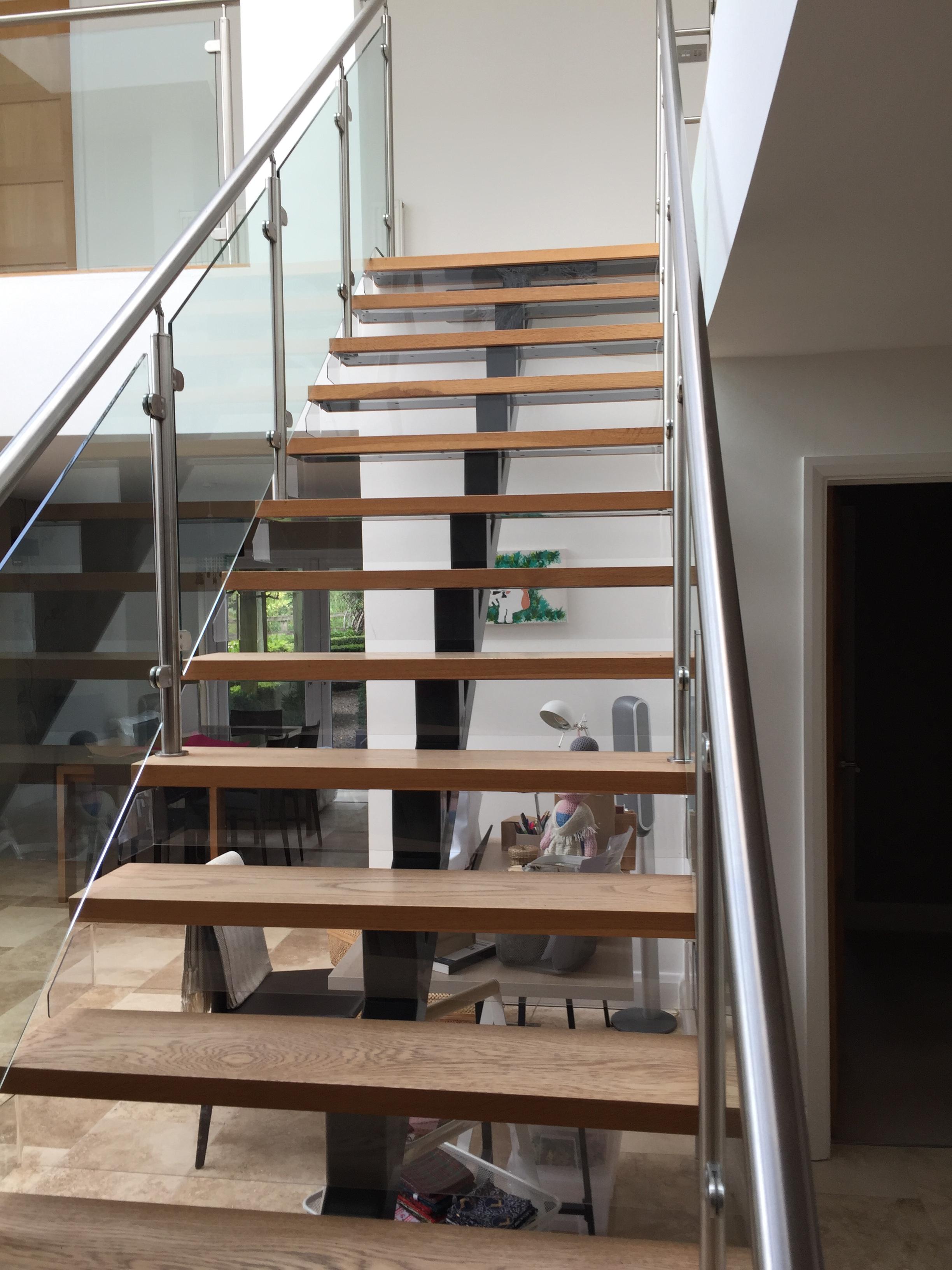

We’re planning on a 34mm timber tread, rebated on to a 10mm steel plate. To satisfy building regs we plan on using Perspex like this staircase we saw a while ago.

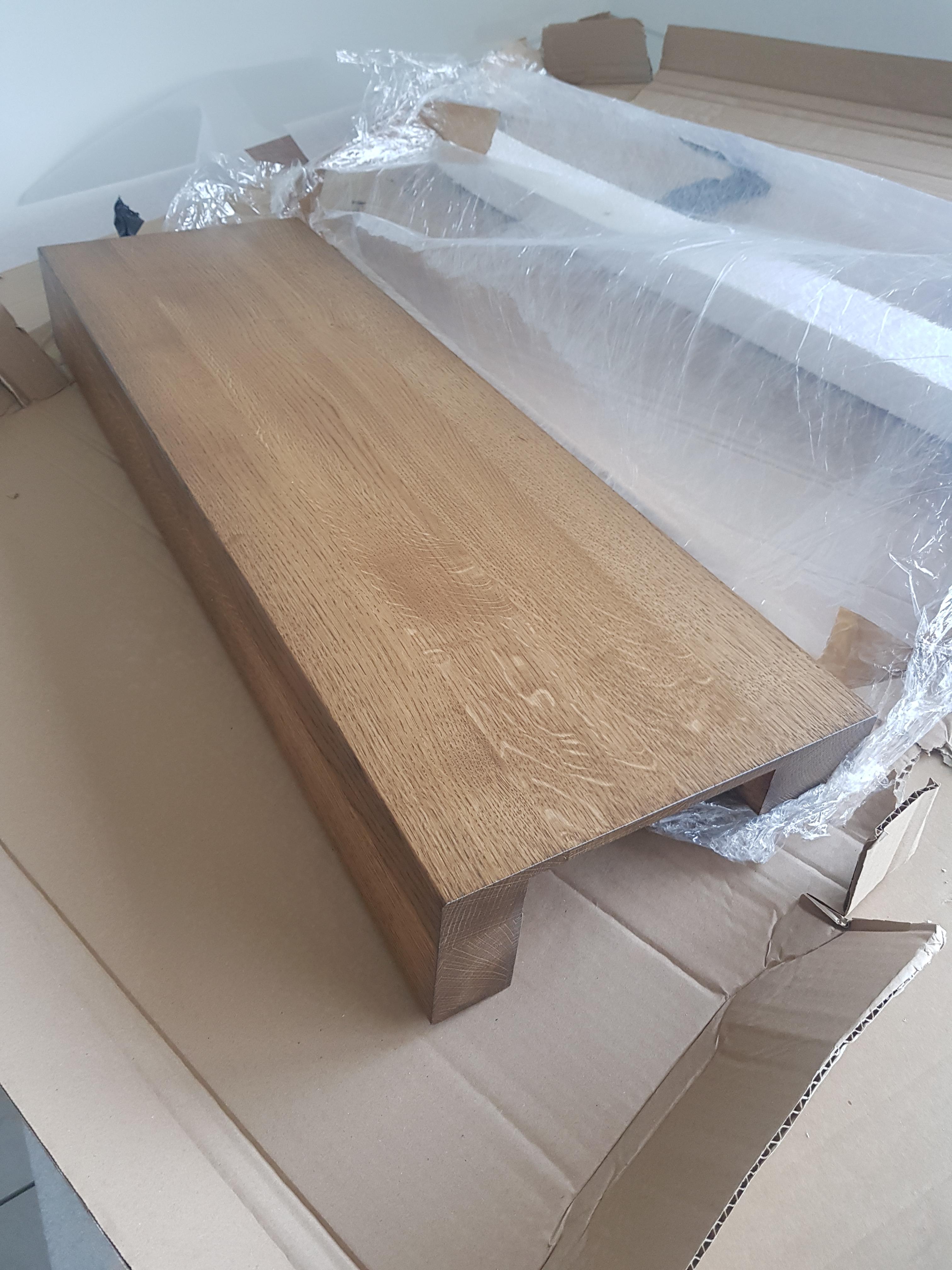

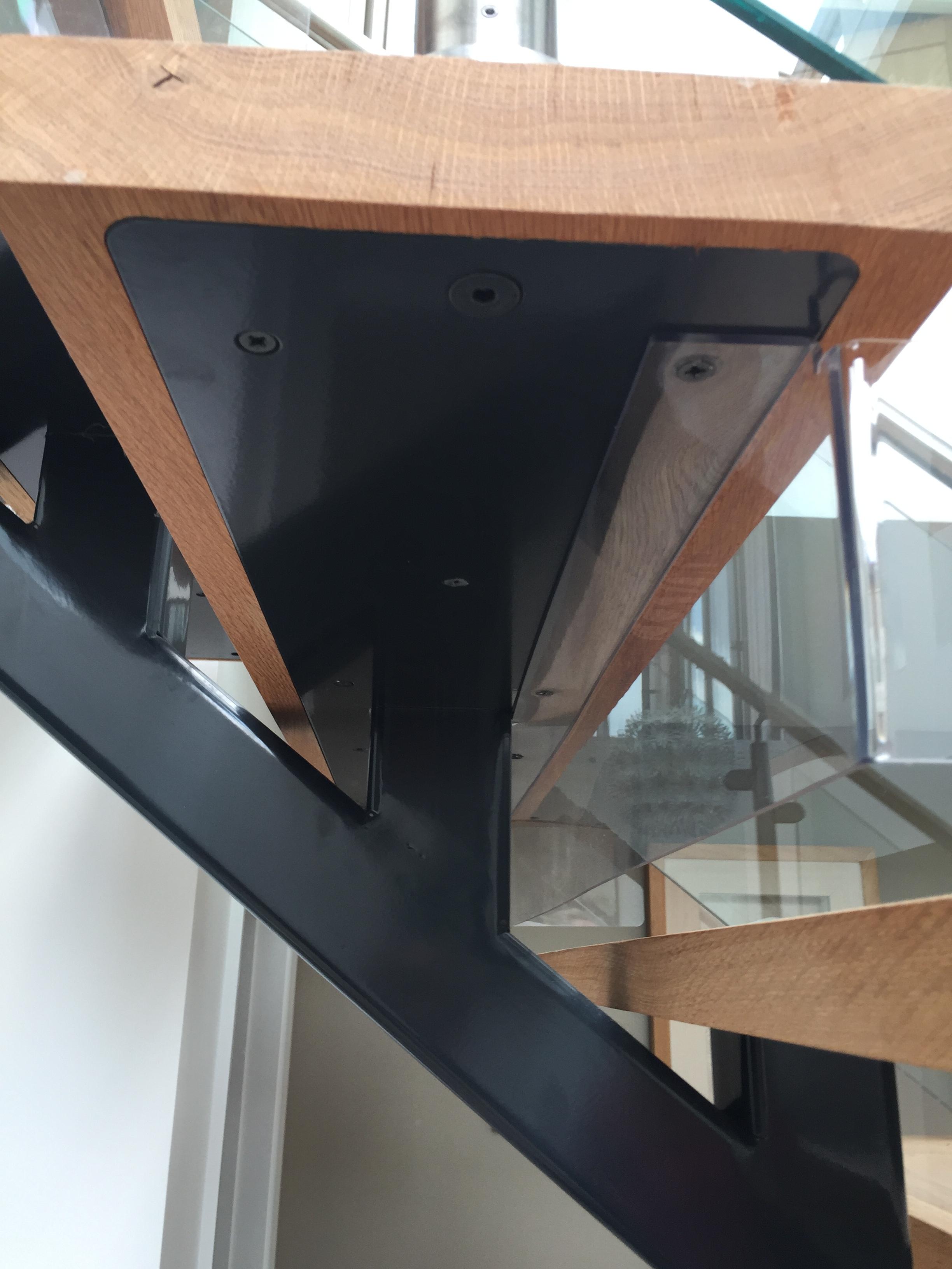

We have the L shaped ones. Made in Poland and they look amazing. Not fitted yet (still sorting sensor lights?). Will post some pics later.

They are rebated underneath to fit metal staircase and colour matched to Oak floor on the landing.
Nice job, nice and light @Pete is that glass balustrade all the way around?
This is not mine, it was posted as an example by @Russdl

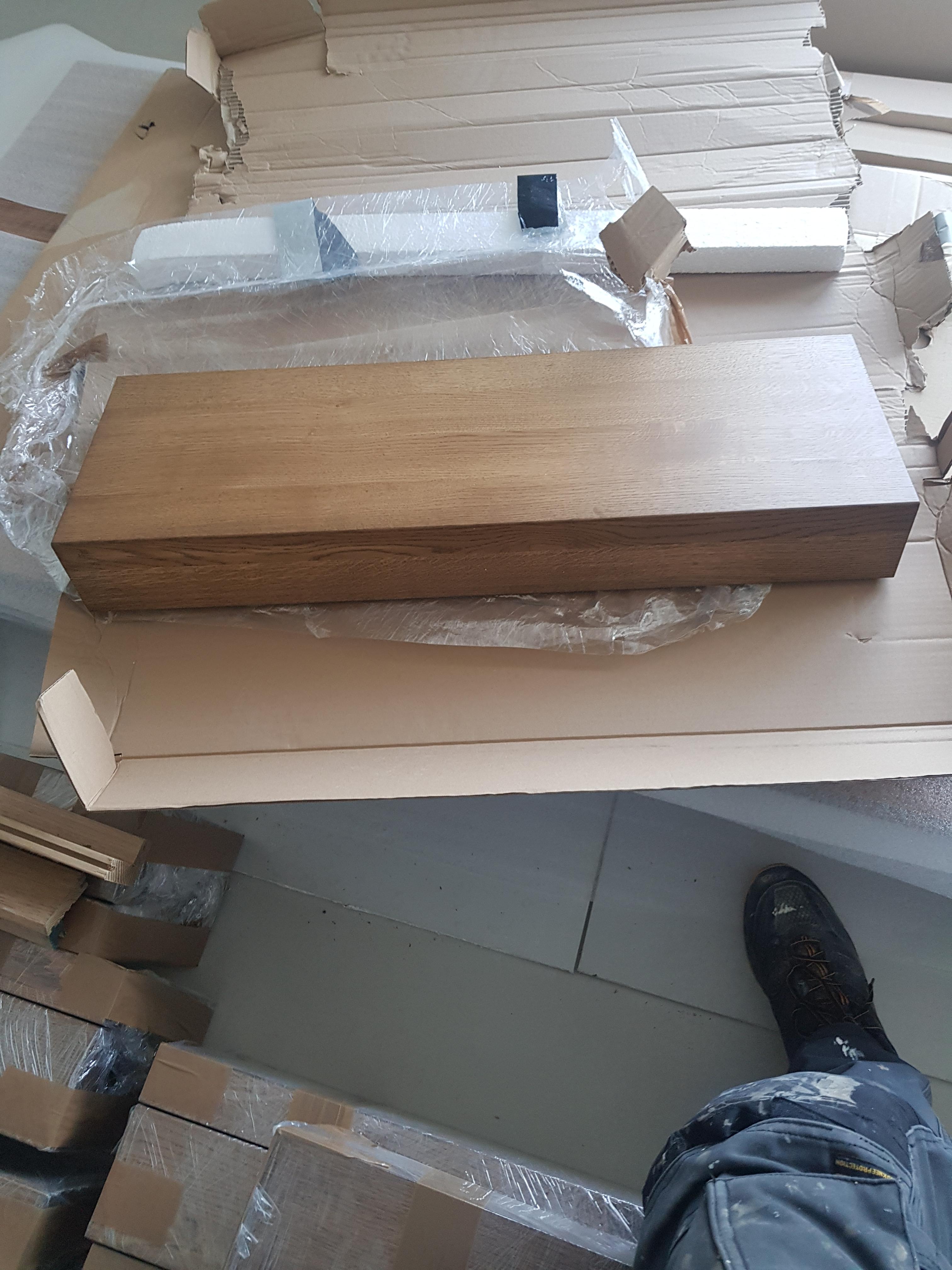

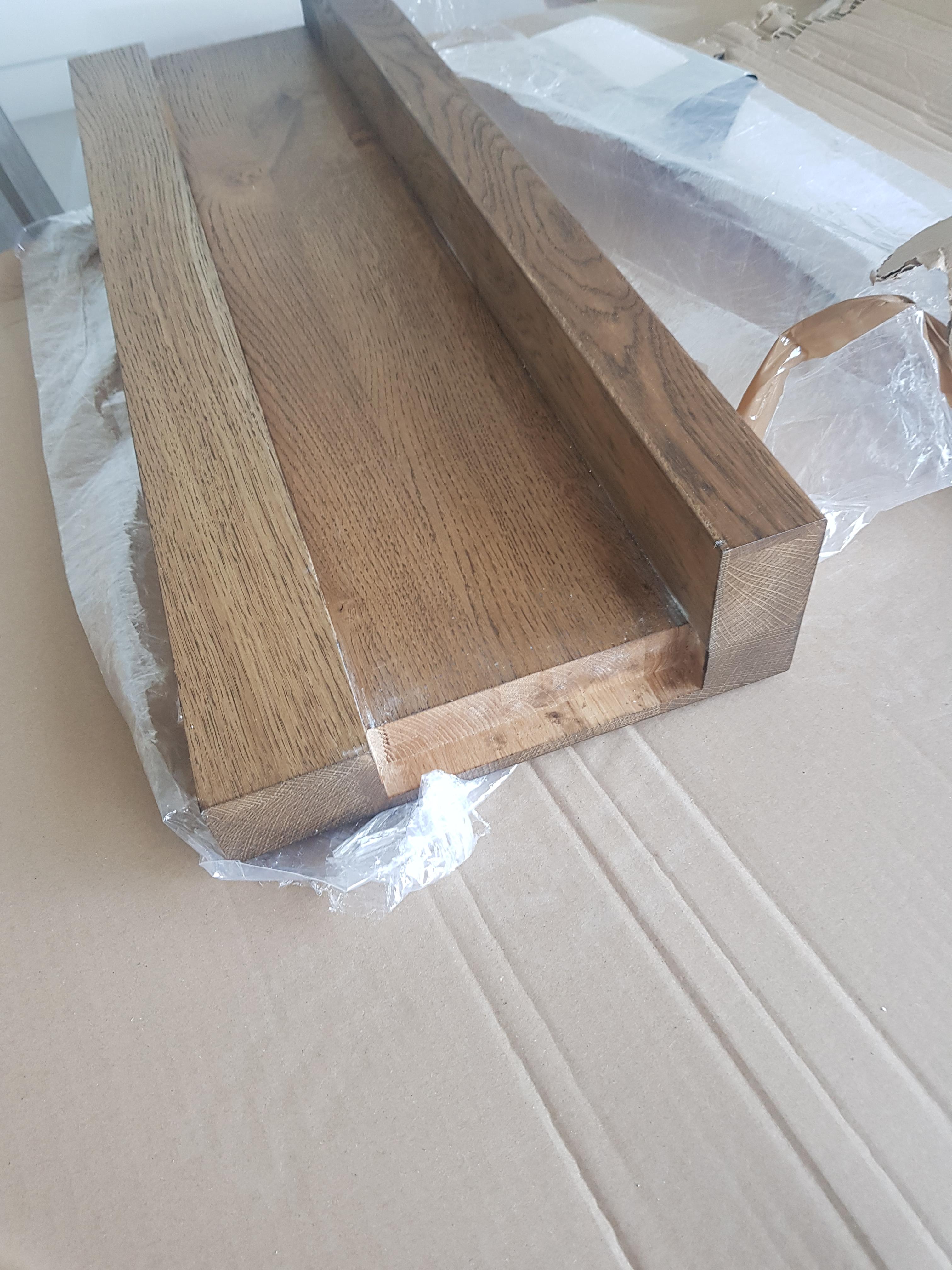

Pictures of my treads. Just got to fit them!!
They look good.
How are they connected to the stringer?
3 hours ago, GaryM said:
They look good.
The middle photo shows a rebate and this sits onto a 10mm plate that connects the strings together. In this metal plate there are 6 holes to attach the wooden treads to. The bottom photo is what you will see when fitted and hopefully matches the Oak floor on the landing.

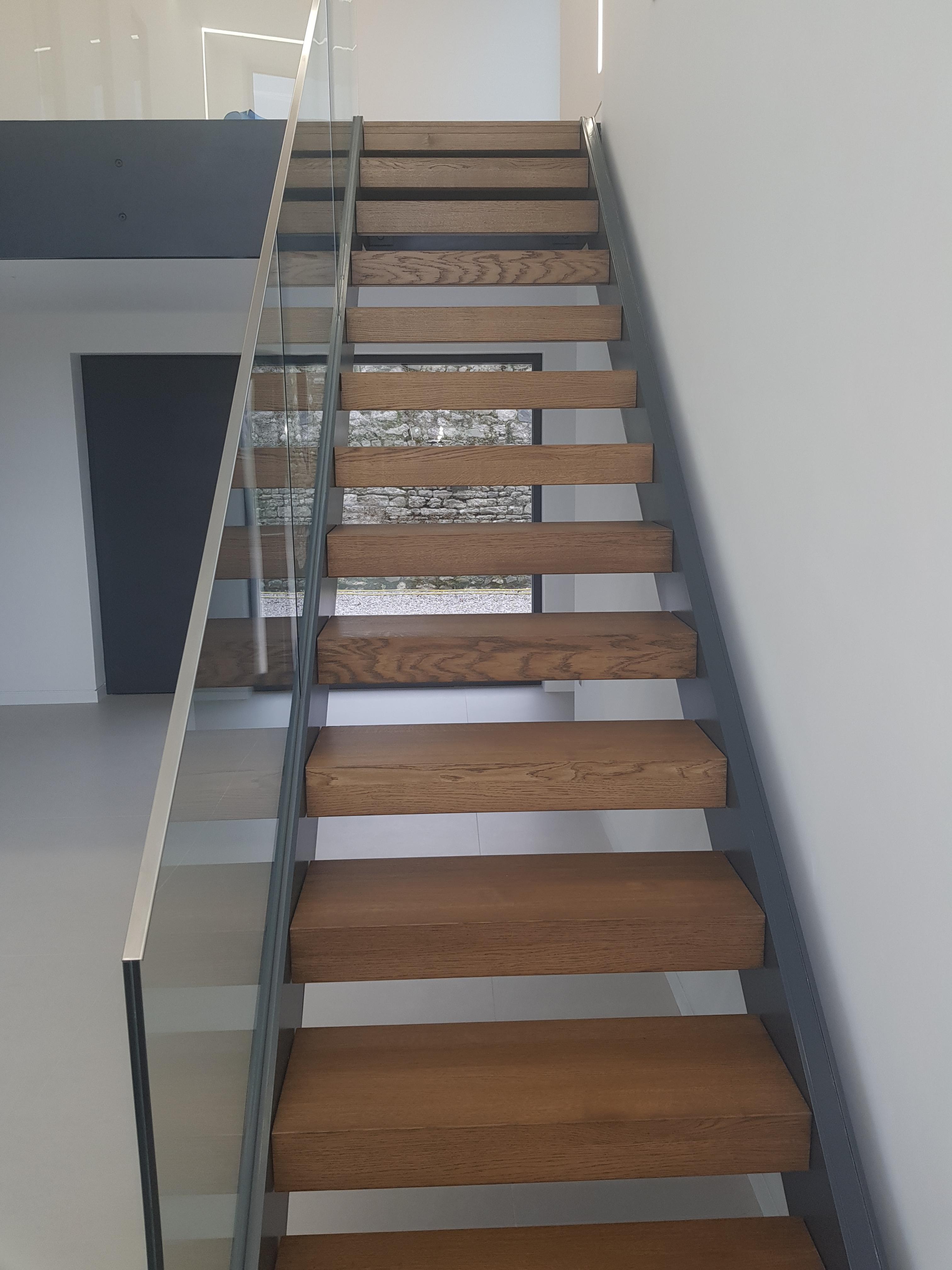

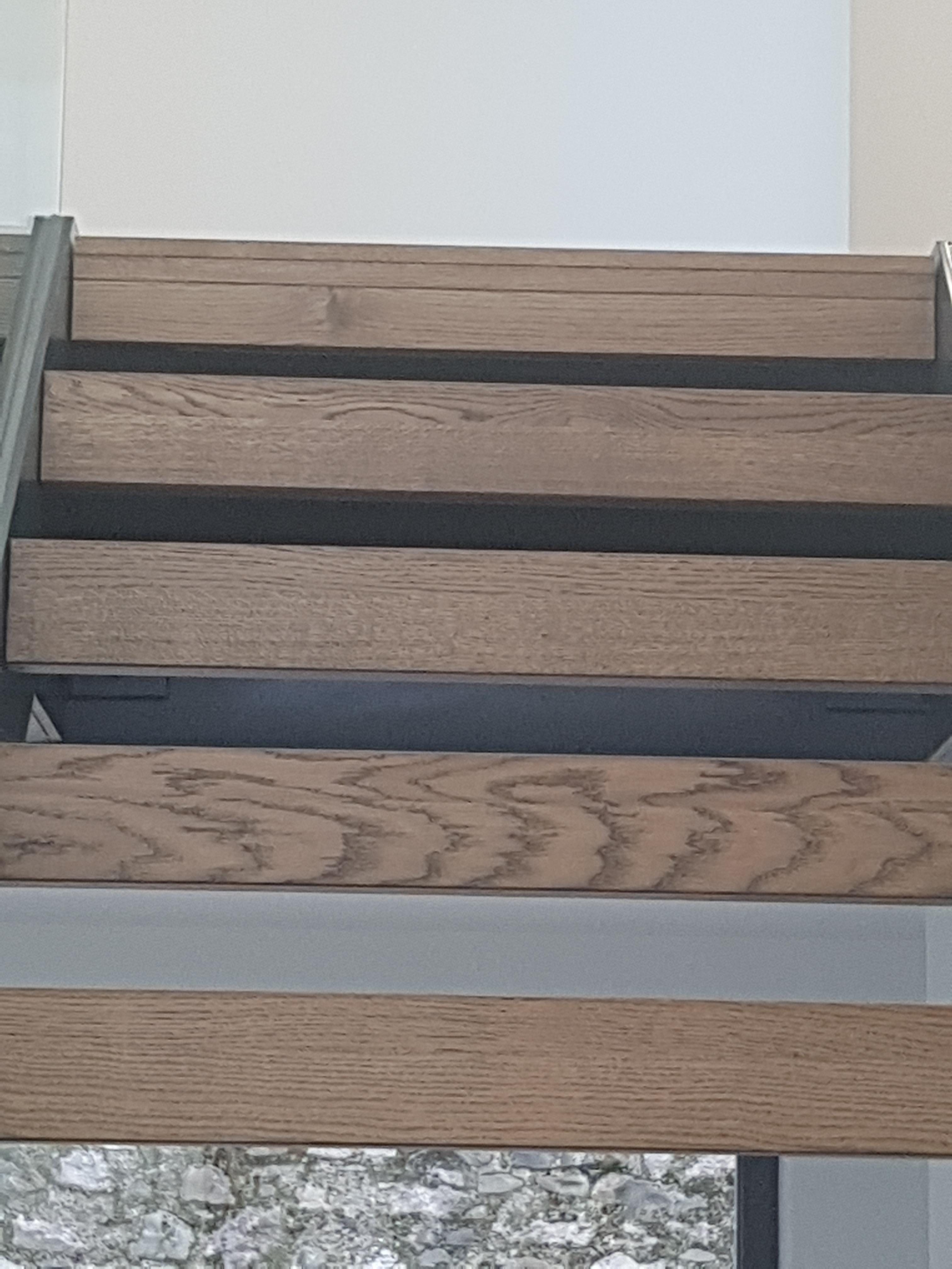

Just thought I would show some pics of our timber treads in situ. We are really pleased with them and they are very solid. The second pic shows the top of the stair treads were they meet the oak flooring on the landing and it is a perfect match apart from the different make up of the wood detail. The wooden treads and wooden flooring are completely different manufacturers so we are really pleased with the colour match
