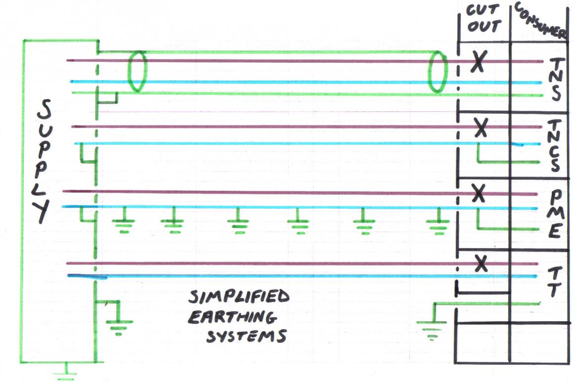

Steptoe Posted January 23, 2017 Posted January 23, 2017 I don't see it being pedantic at all, there are 4 totally different earthing systems in general use, Here's a basic drawing , you can clearly see the differences, so how can anyone possibly say its being pedantic, trying to say they are the same is just being ignorant of the facts. 1
Guest Alphonsox Posted January 23, 2017 Posted January 23, 2017 I don't think that is correct. I've just had a TN-C-S system installed and it looks like what you have labeled as PME. i.e a supply earth followed by additional earth connections on the run to the house.
Jeremy Harris Posted January 23, 2017 Posted January 23, 2017 (edited) 18 minutes ago, Steptoe said: Sorry @jack Being so close to the substation brings with it the possibility of the prospective fault current being extremely high, although the DNO will usually state they have measures in place to stop it rising above 16kA, most domestic consumer units are rated at 16.5 , so that's OK, and the main cutout fuse will be rated much higher, the issue can arise with domestic MCBs only being rated at (usually) 6kA, you are now reliant on the main incoming fuse of probably 80a and rated at 88kA to clear the maximum fault current possible. As for the PME and no rods in place, Jeremy's neither meets the formal, or practical definition of PME, although he has sort of (for want of a better word), bodged a bit of a half headed attempt at it , even though he thought he was doing it for an entirely different reason. this can be a serious issue under certain fault conditions, lethal actually, especially when combined with SP protective devices, remembering that 50mA can kill, and that's why the 30mA threshold. 100mA devices are only there to protect against fire, (etc) , not to preserve life. I done a drawing a few years back of simplified earthing basics, I'll look it out. Nothing bodged about it at all - it was all done by a qualified electrician - not the one that wired our house, but the one that put in the external wiring on the site, before we started building the house. Bodging implies that I'm dangerous, or my work is, and frankly I don't think that's on. As for the earth system, then we initially had TT when the supply (exactly the same box wiring as now) was initially put in, as the DNO wouldn't accept TN-C-S on a "site supply". It wasn't a site supply at all, it was the permanent supply, just fitted inside a box that wasn't built in to the house, but separate from it. When the house wiring was complete, the electrician asked why we were TT and not TN-C-S. I told him it was at the DNO's insistence, and pointed out that the DNO had measured and written Ze (0.26 ohms) in felt pen inside the box, with the words "no PME for site supply" (see, even the DNO use the wrong term!). My electrician rang the DNO on completion and asked whether the PE could now connect to their head, as normal for TN-C-S. They said yes, but please remove and disconnect the TT local earth rod. He measured Ze again to be sure it was still under 0.35 ohms, and then swapped the earth over and we removed the rod. The system is certificated on that basis - no bodging, no unqualified work done by me, everything tested and signed off by a qualified electrician. Edited January 23, 2017 by JSHarris
Steptoe Posted January 23, 2017 Posted January 23, 2017 If this isn't allowed please delete it, but here is a link to a post I wrote a few years ago highlighting the basic differences in earthing systems https://talk.electricianforum.co.uk/topic/14481-simplified-earthing-arrangements/#comment-202531
Jeremy Harris Posted January 23, 2017 Posted January 23, 2017 (edited) 4 minutes ago, Alphonsox said: I don't think that is correct. I've just had a TN-C-S system installed and it looks like what you have labeled as PME. i.e a supply earth followed by additional earth connections on the run to the house. The correct diagrams are as you gave in your earlier link from the IET, and are definitive. Edited January 23, 2017 by JSHarris
Steptoe Posted January 23, 2017 Posted January 23, 2017 4 minutes ago, Alphonsox said: I don't think that is correct. I've just had a TN-C-S system installed and it looks like what you have labeled as PME. i.e a supply earth followed by additional earth connections on the run to the house. The DNO are obliged to make all new TN-C-S connections as PME
