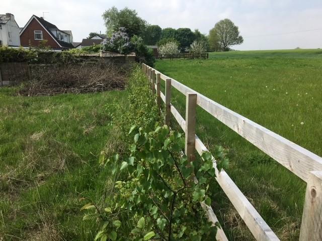

Johnnyt Posted November 18, 2020 Posted November 18, 2020 Three years ago this Xmas eve, I planted a mixed native hedge of bare rooted whips, including blackthorn, hawthorn,hornbean (which like wet gound) hazel and others. The ground is cheshire pasture with clay at 14inches below topsoil, It was a 75 meter run and I just used a spade and waggled it to open the ground and placed the whips in a firmed with my heel. I lost 2 plants. I dont think anything too technical is required, Attached is a picture of them in May 18
Taff Posted November 18, 2020 Author Posted November 18, 2020 That’s come out champion, I’ll just use the spade technique then ?
Johnnyt Posted November 18, 2020 Posted November 18, 2020 Double row, zig zagged about 2 -3 feet apart on each row so when looking at the hedge they appear 12 to 18 inches apart.
