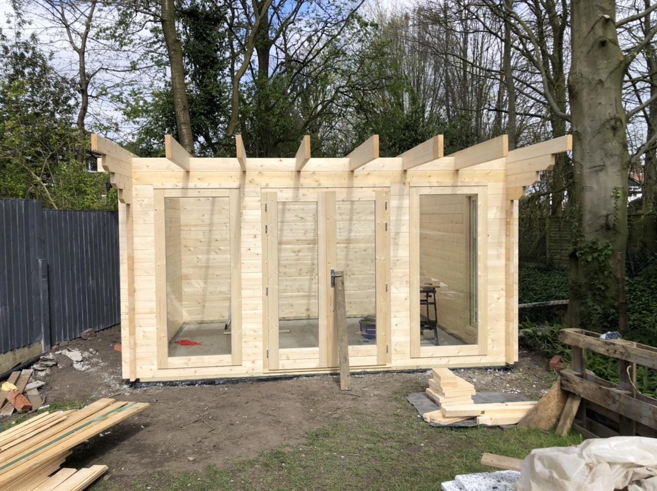

daiking Posted April 5, 2021 Author Share Posted April 5, 2021 Got this far on Saturday. Who needs a roof? Day off yesterday, did a drive to Formby which was fresh to say the least. Still managed to move about a tonne of stuff around the drive/garden to tidy up. 3 Link to comment Share on other sites More sharing options...
daiking Posted April 5, 2021 Author Share Posted April 5, 2021 Only really cheated the once. It was getting late and the last 2 rafters were a not fitting by a couple of mm so just took a couple of mm of the slots with the multitool. Fits like a wizards sleeve now. only really (expletive deleted)ed up installing the windows. There’s a massive gap above them. Buried in some obscure tuin blog with build tips it’s says I should have packed them up a bit. Simple enough to do but priority is to complete the roof first. Couple of small quality issues with the ironmongery. Hence the prop to keep the door closed. Only real concern is that 2 months on the patio (quite well covered) probably didn’t help. It’s gone together pretty well, straight and level, doors windows square etc but try as you might it was not possible to close all the gaps between logs so then were even. The cabin design with the big windows mean the front half has very little actual wall so it behaves in its own way. Fingers crossed that as it dries out in the summer it does so evenly and some of those gaps don’t widen further so it ends up looking like a pallet ? not all my own work, the wife helped a bit at the start and as it progressed I had very welcome help from a very tall (much needed) new acquaintance. Even the kids helped a bit in moving stuff closer to the build from their storage. Link to comment Share on other sites More sharing options...

joe90 Posted April 6, 2021 Share Posted April 6, 2021 On 05/04/2021 at 08:52, daiking said: only really (expletive deleted)ed up installing the windows. There’s a massive gap above them. Buried in some obscure tuin blog with build tips it’s says I should have packed them up a bit. Oh I don’t know, I would want the gaps above because timber shrinks across its grain which means all those logs will shrink a little and the roof will come down a few mm, window frame verticals will hardly shrink at all so those gaps (IMO) will get less in time. Perhaps put some non setting mastic, or foam in them. I remember reading that in real log cabin kits any vertical logs had threaded expansion bolts at the top and the nut was turned one turn down per year to accommodate the shrinking of the logs. Link to comment Share on other sites More sharing options...
markc Posted April 6, 2021 Share Posted April 6, 2021 Stacked horizontal logs will shrink and settle down over time.Windows need a gap at the top (fill with compressible foam etc). to prevent the windows becoming fully load bearing Link to comment Share on other sites More sharing options...
daiking Posted April 6, 2021 Author Share Posted April 6, 2021 I understand how the wood behaves, these gaps are currently log cabin annexes in their own right. I need to pack them up 25-30mm which would still leave a 50mm gap above them for the structure to contract to over the summer and then still keep an eye on it to ensure it doesn’t contract more than that. Link to comment Share on other sites More sharing options...
markc Posted April 6, 2021 Share Posted April 6, 2021 1 hour ago, daiking said: I understand how the wood behaves, these gaps are currently log cabin annexes in their own right. I need to pack them up 25-30mm which would still leave a 50mm gap above them for the structure to contract to over the summer and then still keep an eye on it to ensure it doesn’t contract more than that. Ahhh, 75-80mm does sound like there should be a packer or infill piece. over say 7 feet i would count on upto 25mm of shrink and settlement if nipped down tight during fitting Link to comment Share on other sites More sharing options...

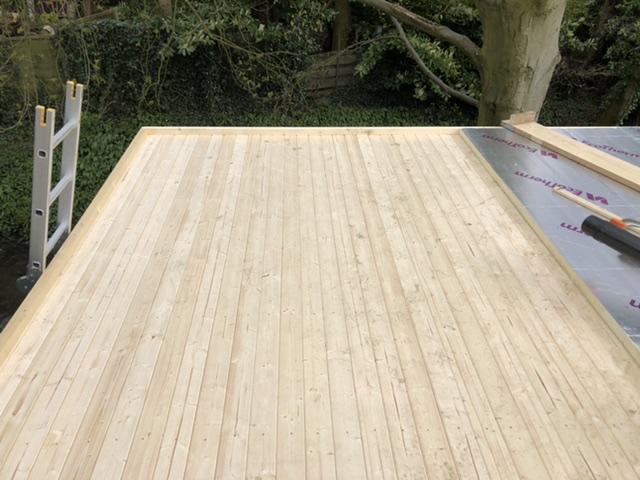

daiking Posted April 12, 2021 Author Share Posted April 12, 2021 Roof was boarded and insulated Link to comment Share on other sites More sharing options...

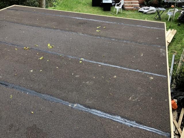

daiking Posted April 12, 2021 Author Share Posted April 12, 2021 Felted. Just hope this lasts a winter with plenty of goop in the felt laps - the laps create puddles as the fall as is shallow Link to comment Share on other sites More sharing options...

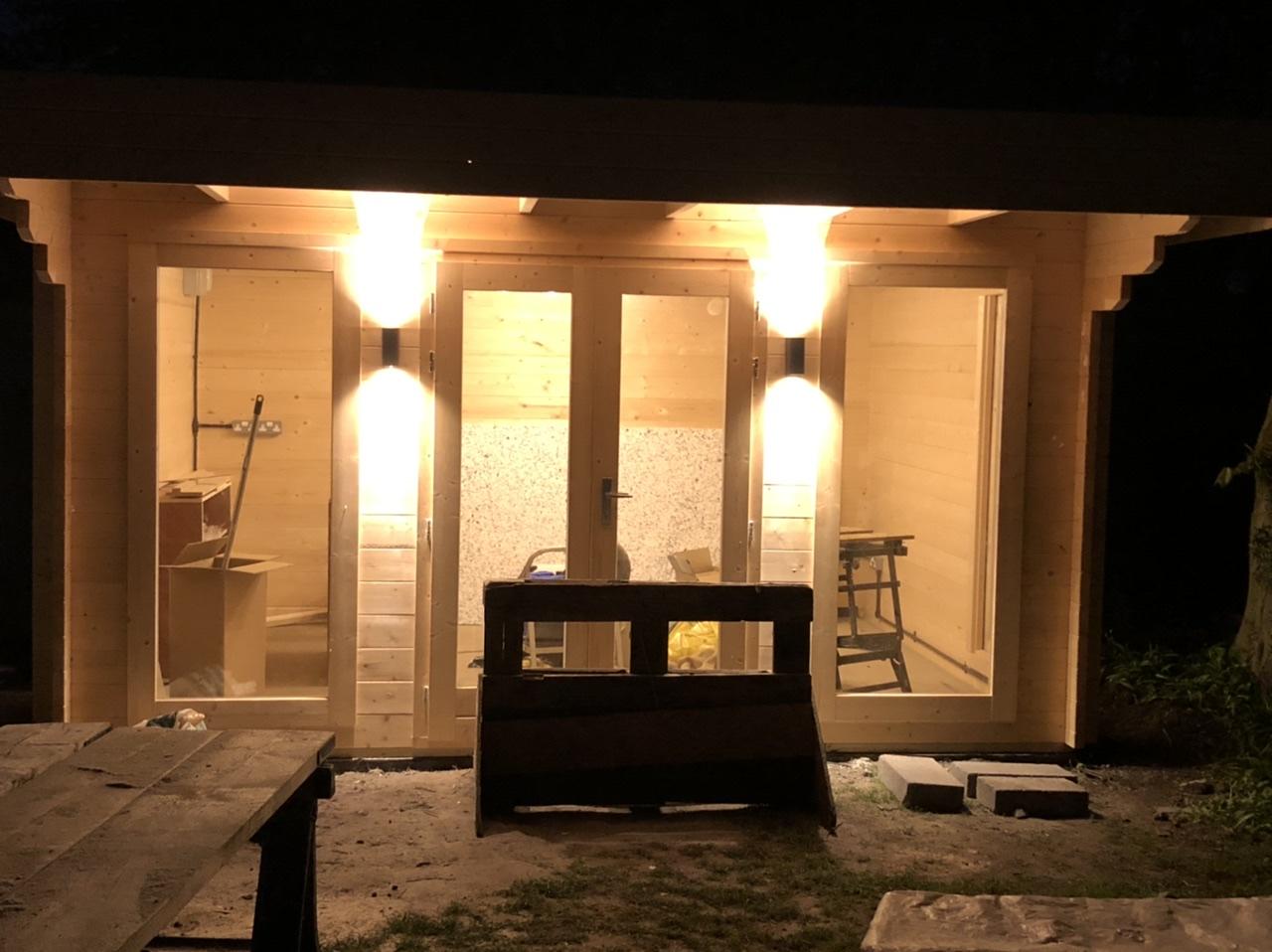

daiking Posted April 19, 2021 Author Share Posted April 19, 2021 Have some lights now 1 Link to comment Share on other sites More sharing options...
