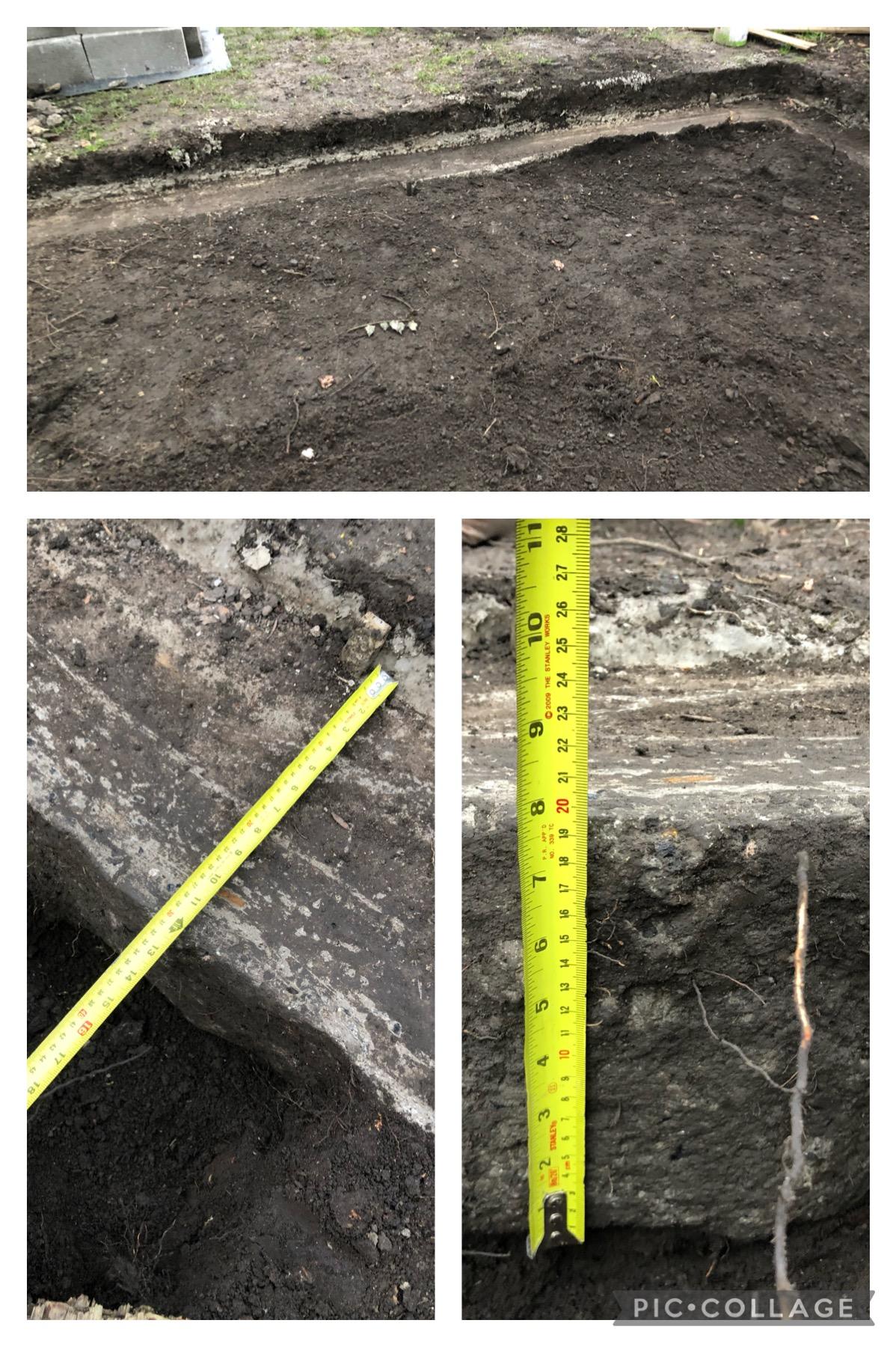

daiking Posted March 21, 2021 Author Share Posted March 21, 2021 I’m down to where I was planning on digging to. So only only another 100mm to go. Between work and the weather forecast it looks like today is the day I need to lay the blocks. First time for everything. I've gone with blocks as you can’t see them and it sounded easier but think now I should have tried bricks as the bond pattern would have given more strength especially at the corners. the cabin has a ‘sole plate’ of sorts. Tempted to stagger this across the corner block and fix with concrete screws to give it something extra. 1 Link to comment Share on other sites More sharing options...
Onoff Posted March 21, 2021 Share Posted March 21, 2021 (edited) You can notch blocks with an angle grinder to interlock at the corners. (The lightweight ones you can cut with an old saw). Blocks are a lot quicker tbh. How many blocks high, one? Edited March 21, 2021 by Onoff Link to comment Share on other sites More sharing options...
daiking Posted March 21, 2021 Author Share Posted March 21, 2021 (edited) 6 hours ago, Onoff said: You can notch blocks with an angle grinder to interlock at the corners. (The lightweight ones you can cut with an old saw). Blocks are a lot quicker tbh. How many blocks high, one? It would be quicker if I didn't (expletive deleted) it up. After marking out something resembling a rectangle playing around with sand and cement until I had something resembling a mortar that looked a bit like something I had seen on youtube I set laying the blocks on a downward slope. Lost about 10mm over 6 blocks so I had to knock them all over, clean off the mortar, clean up the concrete base, everything else I had dirtied and pack up for the day. ITs only going to be 1 block high so I can't even it up on the next row, has to be perfect from the off. I think the corners are higher than the middle of each side and I probably should have left the first block in place but its too late now. Got an idea for when I can get out next to keep it level. Edited March 21, 2021 by daiking Link to comment Share on other sites More sharing options...

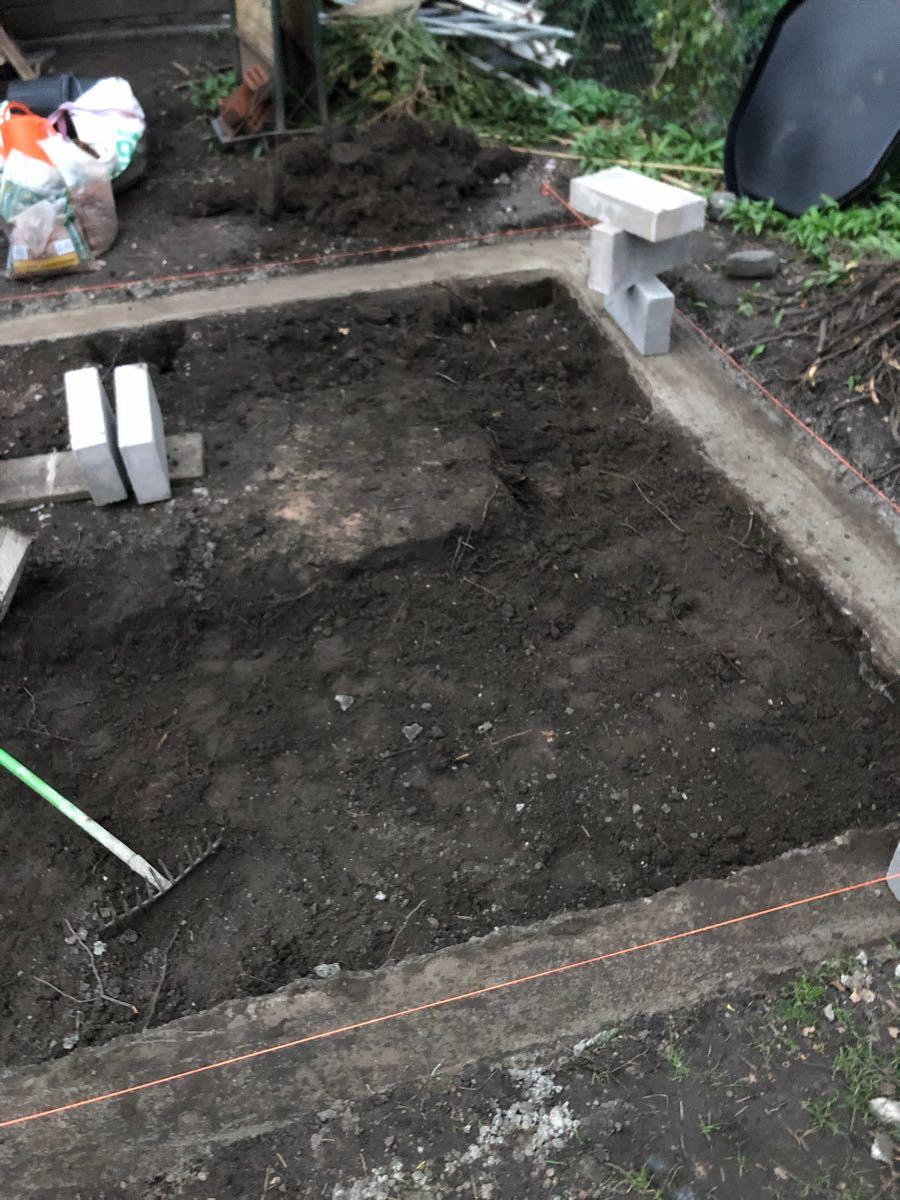

daiking Posted March 23, 2021 Author Share Posted March 23, 2021 The ground is getting worse the more I dig ? . (expletive deleted) it. It’s getting hardcore put in the middle in the rain tomorrow and everything crossed.assuming I can fill and whack in the rain. was planning to whack the earth before putting any stone in it but don’t want to lose it in the wet mud Link to comment Share on other sites More sharing options...
Onoff Posted March 23, 2021 Share Posted March 23, 2021 That's looking good ? Link to comment Share on other sites More sharing options...
PeterW Posted March 23, 2021 Share Posted March 23, 2021 Looks fine. Get the hardcore in and get it whacked down. Link to comment Share on other sites More sharing options...
Onoff Posted March 23, 2021 Share Posted March 23, 2021 & don't tread on that rake! Link to comment Share on other sites More sharing options...
daiking Posted March 23, 2021 Author Share Posted March 23, 2021 It’s not finished yet Link to comment Share on other sites More sharing options...

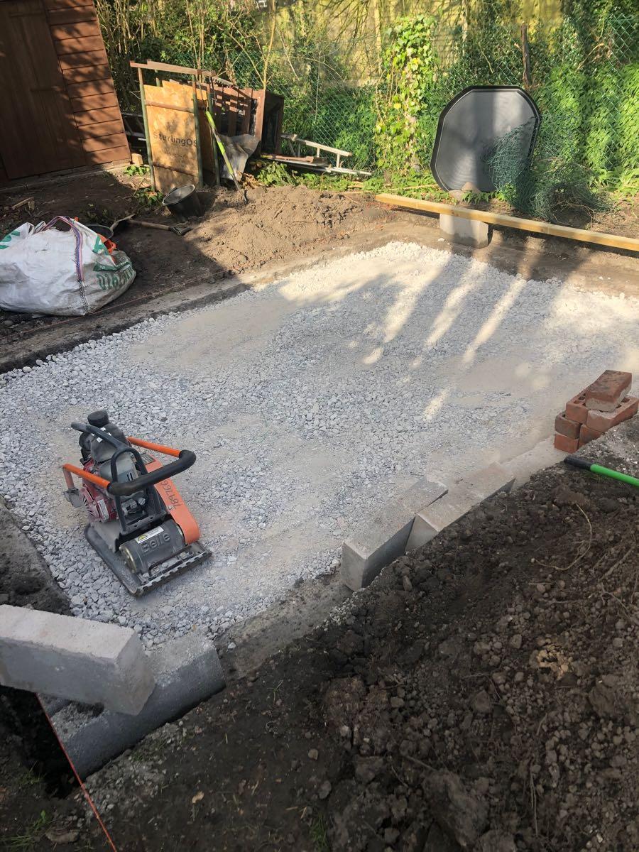

daiking Posted March 24, 2021 Author Share Posted March 24, 2021 12 hours ago, PeterW said: Sorry you’re not allowed to use that statement. It’s been copyrighted by @Onoff for all his projects ..... I meant it still have some to dig out. Finished now. Awaiting stone Link to comment Share on other sites More sharing options...
daiking Posted March 24, 2021 Author Share Posted March 24, 2021 First of 3 bags down and a couple of whacked runs up down them left right 2 Link to comment Share on other sites More sharing options...
Onoff Posted March 24, 2021 Share Posted March 24, 2021 (edited) 1 hour ago, daiking said: First of 3 bags down and a couple of whacked runs up down them left right Almost looks like you know what you're doing! ? Be real careful whacking if you've got the blocks bedded down. It can crack the mortar. Now's a good time to get rid of any off bags of cement, plaster, grout etc along with bits of old crockery, flower pots, glass (if well buried) and that particular ornament of your wife's you secretly hate... Edited March 24, 2021 by Onoff 1 Link to comment Share on other sites More sharing options...
daiking Posted March 24, 2021 Author Share Posted March 24, 2021 2 hours ago, Onoff said: Almost looks like you know what you're doing! ? Be real careful whacking if you've got the blocks bedded down. It can crack the mortar. Now's a good time to get rid of any off bags of cement, plaster, grout etc along with bits of old crockery, flower pots, glass (if well buried) and that particular ornament of your wife's you secretly hate... blocks - left them unlaid after last disaster for exactly that reason. was not going to put anything extra in as it should have been the right amount but still got some low slots so might have to Chuck in the aborted block mortar and extra concrete bits from the footings and some bags of sand I’ve been using as gazebo ballast. the stone didn’t arrive till 2 and the guy had the small wagon so he had to offload on the street not out drive so it was even further away. Still got all 3 bags emptied and whacked by 6 between me and the wife which was not bad going at all. We even had time to paint some fence, paint the shed and transplant a couple of Laurel after finishing digging out the pit. Done about 3 days work in a day but it has been a nice day here. 4 Link to comment Share on other sites More sharing options...
