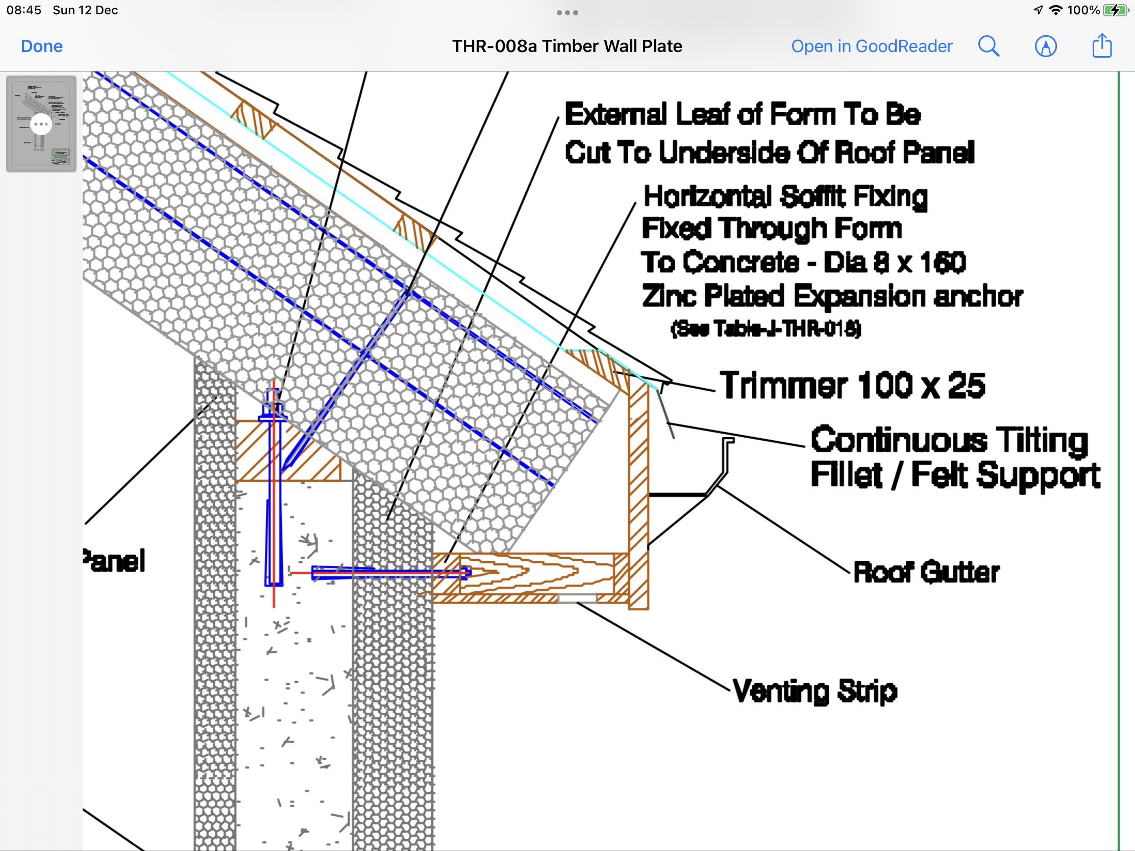

Nick Laslett Posted December 12, 2021 Share Posted December 12, 2021 On 09/12/2021 at 20:58, freshy said: How is your Thermohouse build coming along? The panels are now installed. Some thoughts: This is my first build, so I have no experience of other methods. The roof boards went up very quick. They come pre-cut for length and pitch angle from the factory. Only the valley junctions need to be cut on site. They have a special circular saw with 30cm cut depth. Surprisingly on the flat sections the boards do not stop the water coming through. You need Wing Tek self drilling screws for attaching the battens, this is straight forward. Attaching the barge board to the gable ends is more tricky, screw depth is >170mm, the C section is 100mm high and you need to affix the board with 2 screws. With my tests I found that it is harder than you think to keep a drill perpendicular for that kind of depth of hole, easy to have 5mm of travel in your hole at that depth. I have a free AutoCAD DWG viewer on my iPad, DWG FastView. This has been an invaluable tool. Thermohouse have PDF and DWG files for most construction details: https://thermohouse.ie/download/thermoroof-details-cad-file-dwg/ When you look at the soffit detail, this is sort of backward to a normal roof, because there is no joist to affix too. The wall batten is the main fixing point. We have not done this yet. I will upload some pictures when I get the chance. 1 Link to comment Share on other sites More sharing options...
freshy Posted December 13, 2021 Share Posted December 13, 2021 On 12/12/2021 at 08:55, Nick Laslett said: I will upload some pictures when I get the chance. @Nick Laslett Thank you, this is useful information. Please do upload pictures ? Link to comment Share on other sites More sharing options...
